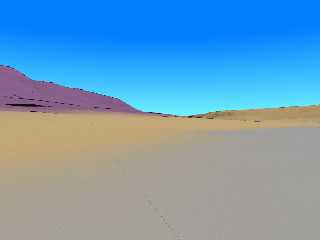

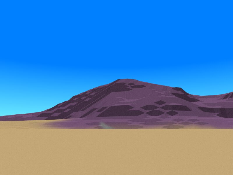

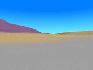

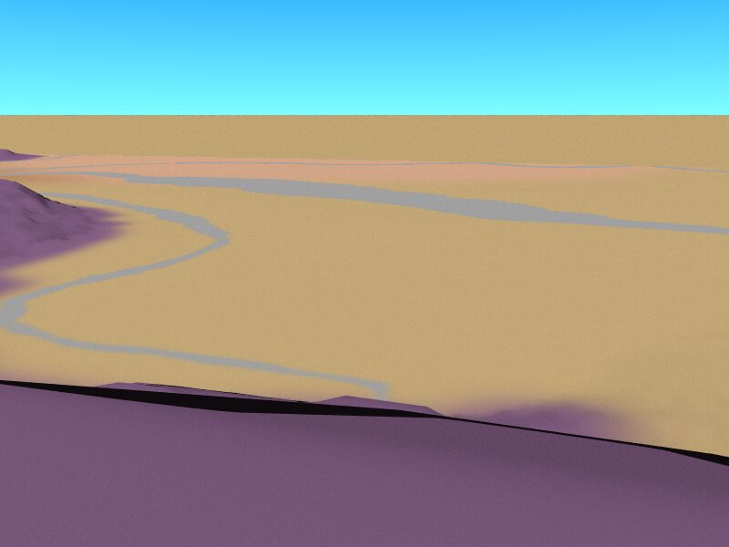

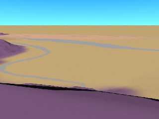

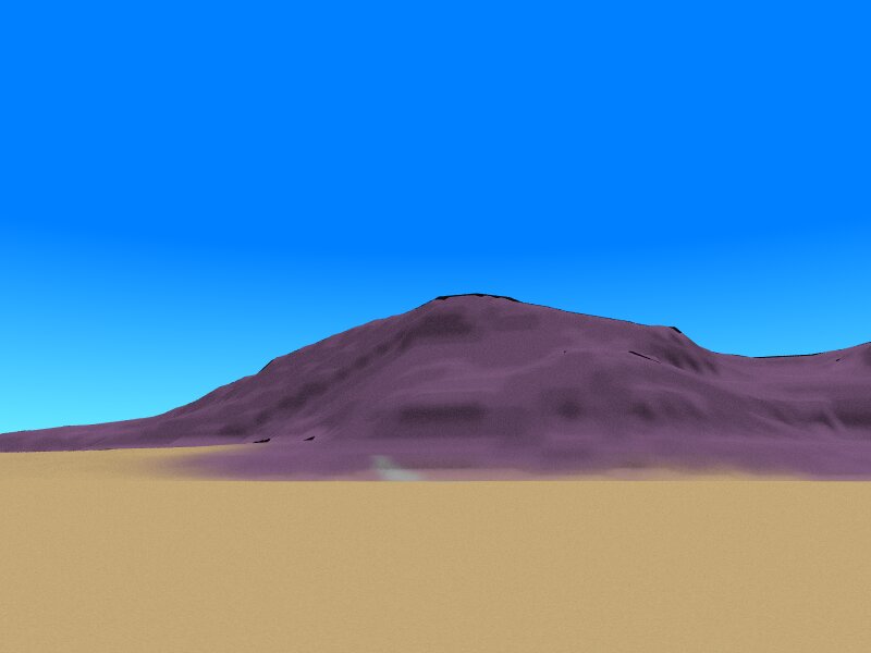

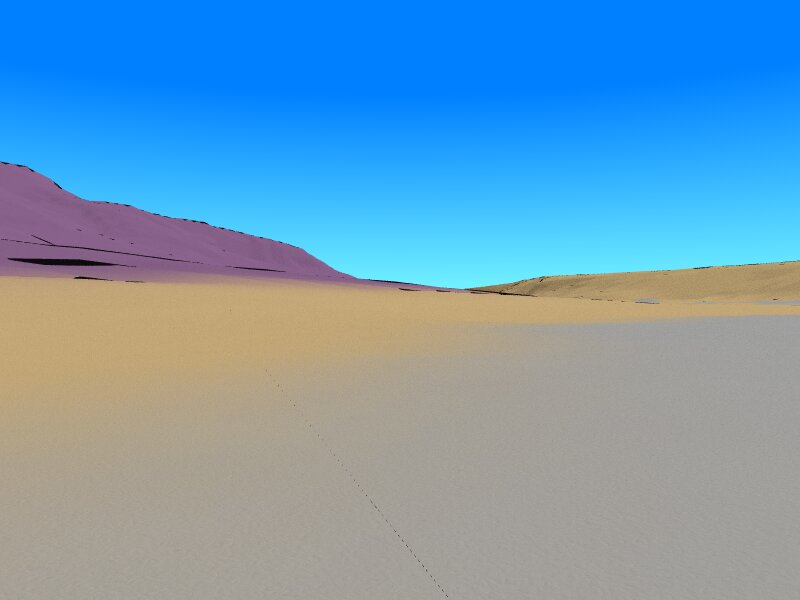

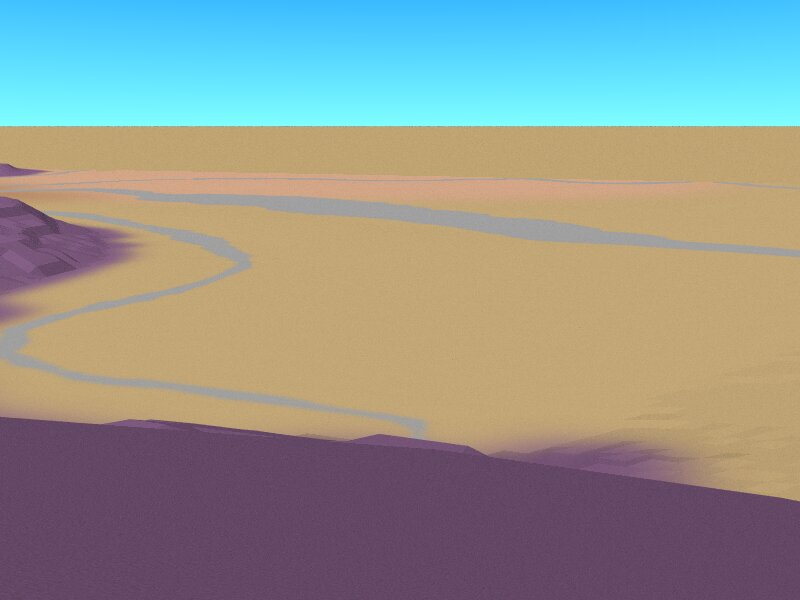

Hi tracers!
Finally, after 15 weeks of cumbersome 16bit HF pixeling (425,000 pixels
placed manually!), I got together the first small slice of southern
Kandahar province, covering an area of 10.795 by 25.4 kms.
Then after battling with a texture bitmap at a 10 times higher
resolution (4,250 by 10,000 pixels) which even under Linux brought my
system to the verge of crashing (while editing with the GIMP, I had to
use several layers), I started to render the first views of the scenery.
There is also the question whether smooth pigment/texture transition on
a HF can be done procedurally rather than with such huge bitmaps, but at
the moment, this is not the main problem.
Instead, as you see in the images attached here, whenever I used
"smooth" with the HF, strange shadows appeared where no shadows should
be at all... without "smooth" they disappear (see images with a 'b' in
their filename).
Is there a way to avoid this - or is it just a bug with which I've to
learn to live?

From: Mick Hazelgrove
Subject: Re: Return to PoVghanistan - smooth HF bug in 3.5? (6 x JPG 800 x 600, 180 KB)
Date: 10 Aug 2002 11:56:01
Message: <3d553791@news.povray.org>
Hi Jorg
If you use a normal on the HF the dark shapes will generally dissapear.
Mick
From: Marc-Hendrik Bremer
Date: 10 Aug 2002 12:01:22
Message: <3d5538d2@news.povray.org>
news:3D553C59.7D7659C6@tiscalinet.de...
> their filename).
This seems to be the known bug with smooth heightfields. Try
"double_illuminate" with the Hf, this should remove the black spots. If this
does not work, you may want to try to make an Isosurface out of your
image_map. This might be to slow (depends on the necessary max_gradient),
but IIRC there are no such problems wih isosurfaces. Interpolate the
image_map by "interpolate 4" (I think method 2 does not work well in this
context). This should remove those black-spot-artefactlines, too.

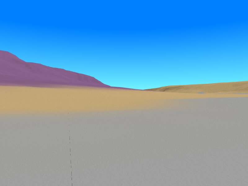

From: Jörg 'Yadgar' Bleimann
Date: 10 Aug 2002 13:53:39
Message: <3D5561E0.F372B6EA@tiscalinet.de>

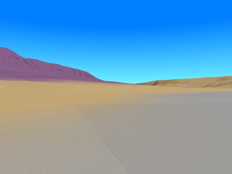

High!
This worked perfectly, but there is still something unfixed - in the foreground
of the attached image, the light grey surface of the dry river bed looks
perforated!

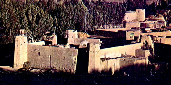

Before finishing for today, one last practical question: how do I get the
typical irregular structure of adobe walls? Of course I could use some turbulent
normal (which pattern?), but I unfortunately suffer from the ambition to do
everything as accurate as possible, so you might suggest using an isosurface...
See you in Khyberspace - http://home.arcor.de/yadgar/khyberspace/index-e.html
Date: 10 Aug 2002 13:57:26
Message: <3D5562CF.45779D12@tiscalinet.de>
High!
In fact I used a HF!
See you in Khyberspace!
Yadgar
Date: 10 Aug 2002 14:14:25
Message: <3d555801@news.povray.org>
news:3D5561E0.F372B6EA@tiscalinet.de...
> High!
foreground
> perforated!
I noticed that, too. *Maybee* try to shift your look_at point just al little
bit, if look_at and the position of the camera are in a strait line, there
are some odd artefacts IIRC.

Hm, I don't know for sure, what an adobe wall looks like (my dictionary
translates adobe with "Luftziegel"). Perhaps have al look at the
Irregular_Bricks_Ptrn in textures.inc. It's probably a good idea to choose
the used object (and method - normal or isosurf) by calculating the distance
to the camera. The mentiones pattern f.e. will work quite well as normal or
as function in an isosurface, that makes it easy to switch between both
methods.
If the walls are roughcasted the granite pattern will do quite a good job
IMHO.

From: Rafal 'Raf256' Maj
Date: 10 Aug 2002 14:17:22
Message: <Xns9266CDCA4FFD5raf256com@204.213.191.226>
news:3D5562CF.45779D12@tiscalinet.de
I ques he ment - use a
normal { bozo 0.001 scale 10 }
block in HF :)
Date: 10 Aug 2002 20:25:02
Message: <3D55BDA6.8D1B0BE9@tiscalinet.de>
High!
No, the camera viewing direction isn't parallel to any axis, it faces
south-southwest and slightly upward!
Yes, "luftgetrocknete Lehmziegel" (sun-dried mud bricks)...
  methods.
I've tried this, but it looked very different from my notions of Afghan mud
walls - they are partly made of bricks, but
somehow the bricks are almost undiscernable, perhaps bricks and mortar look very
similar, or there is a kind of rough plaster
over them. Another type of mud wall is just formed amorphous mud, no bricks at
all.
Date: 11 Aug 2002 05:47:54
Message: <3d5632ca@news.povray.org>
news:3D55BDA6.8D1B0BE9@tiscalinet.de...
> High!
little
there
Ok, looks a little like a coincedence surface problem, but if this can't be
the case, then you probably suffer from the beloved floating-point
precision, I think. You could try to apply a normal (as Mick suggested) to
your HF, that might help to cover or solve the problem.
choose
distance
or
>   methods.
mud
look very
bricks at
> all.
job
>   IMHO.
> Yes, it looks more like what I have in mind... but with simple boxes, I
still
> have sharp edges like they never occur in real mud
> buildings, their shapes are in fact rounded/softened. After having heard
so much
> about the astonishing properties of
> isosurfaces, I wish I had some experience in using them... sigh...
Isosurfaces are not that hard to master, as long as you use more or less
standard functions (boxes, spheres, cones etc.) or use the internal
functions (functions.inc). Don't allways believe what the warning message
tell's you is the required max_gradient or you might have to wait for ages,
esp. if you use pattern-functions. I have some function here which reports a
max_gradient of more than 1000 but renders very well with a max_gradient of
10. It's not that you should ignore that higher max_gradient - but as long
as there are no artefacts visible, why should you wait longer as needed?
If you have some reference photos, I could probably build some basic example
of an isosurface based building ...
BTW this link seems to be brocken on your homepage:
http://home.arcor.de/yadgar/khyberspace/afghlinks-d.html (same with the
English version)
Marc-Hendrik
Subject: Examples of Afghan mud architecture (was: Re: Return to PoVghanistan )
Date: 12 Aug 2002 09:50:11
Message: <3D57CB11.763ACB59@tiscalinet.de>
High!
Here they are!
Afghanistan Chronicle: http://home.arcor.de/yadgar/index-e.htm
Yadgar
