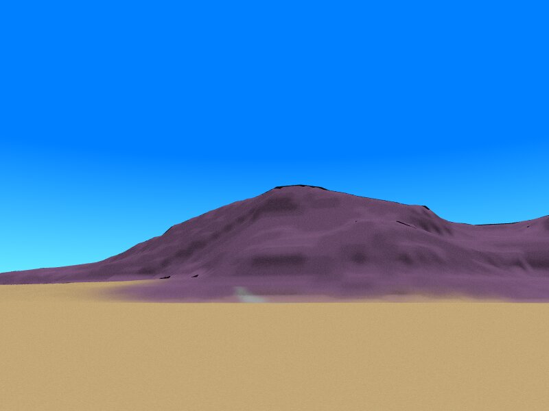

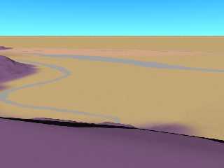

Hi tracers!
Finally, after 15 weeks of cumbersome 16bit HF pixeling (425,000 pixels
placed manually!), I got together the first small slice of southern
Kandahar province, covering an area of 10.795 by 25.4 kms.
Then after battling with a texture bitmap at a 10 times higher
resolution (4,250 by 10,000 pixels) which even under Linux brought my
system to the verge of crashing (while editing with the GIMP, I had to
use several layers), I started to render the first views of the scenery.
There is also the question whether smooth pigment/texture transition on
a HF can be done procedurally rather than with such huge bitmaps, but at
the moment, this is not the main problem.

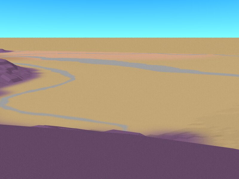

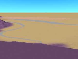

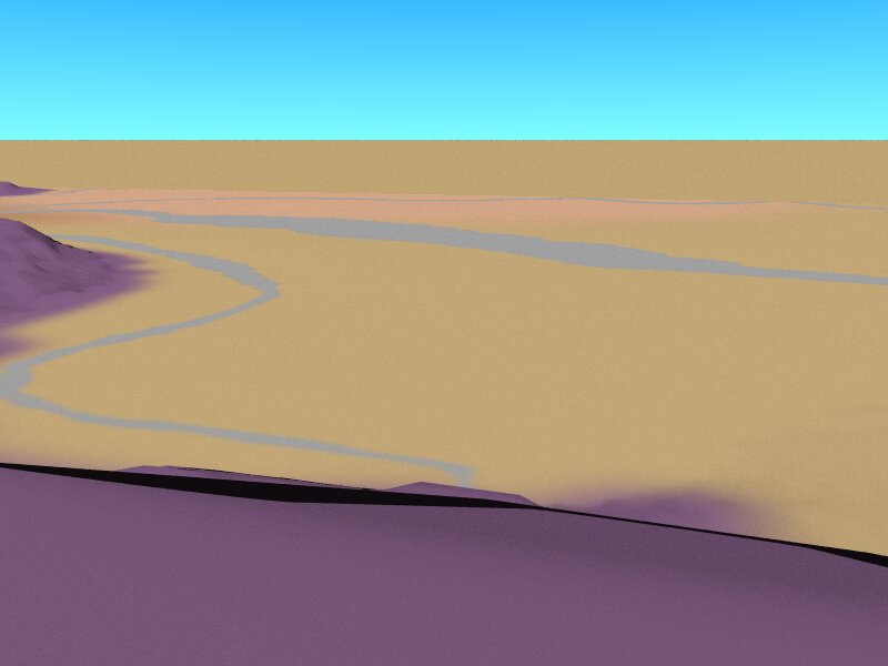

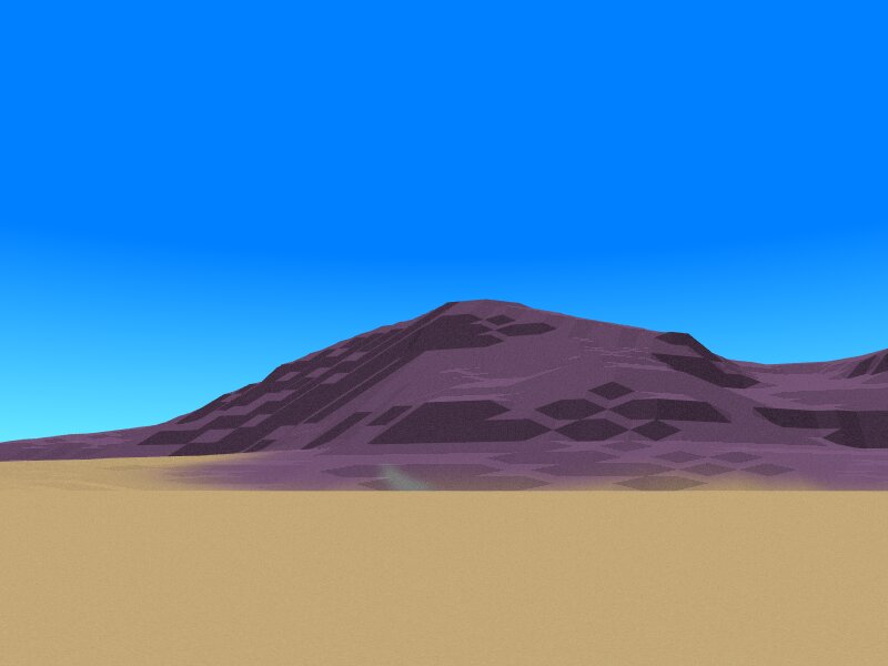

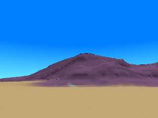

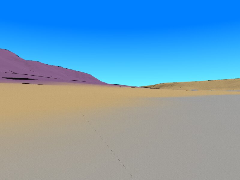

Instead, as you see in the images attached here, whenever I used
"smooth" with the HF, strange shadows appeared where no shadows should
be at all... without "smooth" they disappear (see images with a 'b' in
their filename).
Is there a way to avoid this - or is it just a bug with which I've to
learn to live?

Hi Jorg
If you use a normal on the HF the dark shapes will generally dissapear.
Mick

This seems to be the known bug with smooth heightfields. Try
"double_illuminate" with the Hf, this should remove the black spots. If this
does not work, you may want to try to make an Isosurface out of your
image_map. This might be to slow (depends on the necessary max_gradient),
but IIRC there are no such problems wih isosurfaces. Interpolate the
image_map by "interpolate 4" (I think method 2 does not work well in this
context). This should remove those black-spot-artefactlines, too.

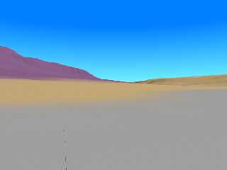

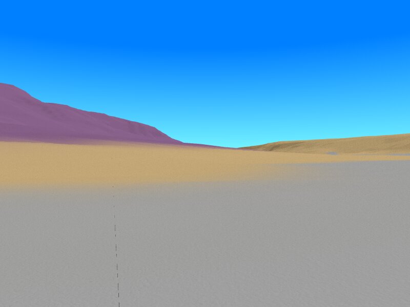

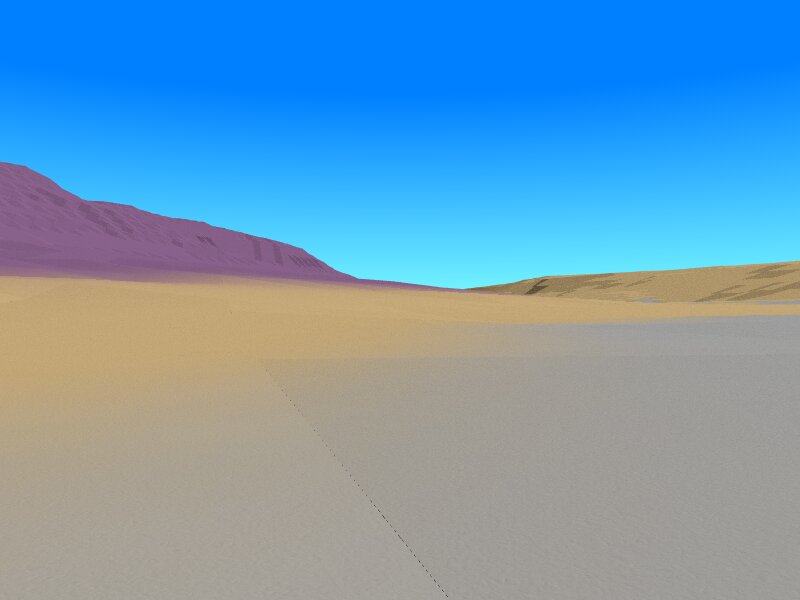

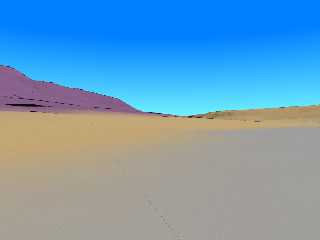

This worked perfectly, but there is still something unfixed - in the foreground
of the attached image, the light grey surface of the dry river bed looks
perforated!

Download 'chakghar0016c.jpg' (26 KB)
Preview of image 'chakghar0016c.jpg'
In fact I used a HF!
See you in Khyberspace!
Yadgar
foreground
> perforated!
I noticed that, too. *Maybee* try to shift your look_at point just al little
bit, if look_at and the position of the camera are in a strait line, there
are some odd artefacts IIRC.
I ques he ment - use a
normal { bozo 0.001 scale 10 }
block in HF :)
No, the camera viewing direction isn't parallel to any axis, it faces
south-southwest and slightly upward!
