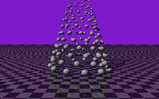

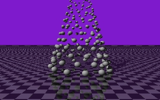

[Image]
Here is the source - I want something like a lattice here, with all the
'joints' here connected together.  I am just trying desperately to tweak
the numbers in.
Bryan Valencia
Download 'us-ascii' (1 KB) Download 'c:\temp\nsmaile6.gif' (1 KB) Download 'c:\temp\nsmail7u.jpeg.jpg' (51 KB)
Preview of image 'c:\temp\nsmaile6.gif'
Preview of image 'c:\temp\nsmail7u.jpeg.jpg'
From: Bryan Valencia
Subject: Re: can't get blobjects to connect
Date: 16 Apr 2001 16:46:23
Message: <3ADB5AB0.F6FF98A5@209software.com>
oops, here is the source

From: Tor Olav Kristensen
Date: 16 Apr 2001 20:00:23
Message: <3ADB85B1.140BCCA@hotmail.com>
Hi Bryan.
You need to increase the radii of
your sphere components.
In order for sphere components in a
blob to "connect", they must have so
large radii, that if they were "real"
spheres they would "tuch" each other.
(Hmmm... That's quite bad english,
I suppose :)
Best regards,
Tor Olav
mailto:tor### [at] hotmailcom
http://hjem.sol.no/t-o-k/tokpicts.html
http://www.crosswinds.net/~tok
> plane{y,0 pigment{color rgb .5} finish{reflection .2} normal{checker
> .4}}
> light_source{<-80,100,-90> color rgb 1}
> #declare h=1;
> #declare mh=100;
> blob{threshold .1
> #while (h<mh)
>     #declare f=(mh-h)/mh;
>     #declare a=sin(h)*5*f;
>     #declare b=(h)/5;
>     #declare c=cos(h)*5*f;
>     sphere{<a,b,c>,f/2,f*20}
>     #declare h=h+.5;
> #end
>     pigment{color rgb 1}
> camera{location<0,5,-20> look_at<0,4,0>}
> sky_sphere{pigment{color rgb<.5,.1,.8>}}
Date: 16 Apr 2001 20:03:04
Message: <3ADB8654.5BC8F4E@hotmail.com>
Tor Olav Kristensen wrote:
> Hi Bryan.
And of course their summed "field
strength" in the "connection region"
must be greater than the threshold
for the blob.
Best regards,
Tor Olav

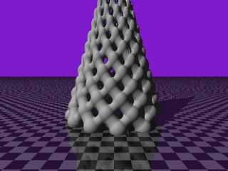

> with all the 'joints' here connected together.  I am just
> trying desperately to tweak the numbers in.
I fiddled with it a bit ...
blob    {
        threshold .4
        #while (h<mh)
        #declare b=(h)/5;
        sphere{<a,b,c>,1.5*f,1}
        #declare h=h+.5;
        #end
        pigment {color rgb 1}
It appears to me that f (multiplied by whatever constant) is the Wrong
Thing for the component radius, unless you want the lattice to break up
at the top.
Anton Sherwood  --  br0### [at] p0b0xcom  --  http://ogre.nu/

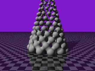

Download 'bryan.jpg' (14 KB)
Preview of image 'bryan.jpg'
From: Anton Sherwood
Date: 17 Apr 2001 02:31:50
Message: <3ADBE36A.CF53AE76@pobox.com>
> is the Wrong Thing for the component radius, unless you want
> the lattice to break up at the top.
But if the radius is constant, the lattice gets thicker at the top.
I see the problem now: the vertical spacing is constant (0.5) but the
horizontal spacing shrinks (in proportion to the diameter of the cone).
Will elliptical components do?:
#declare h=1;
#declare mh=100;
blob    {
        threshold .5
        #while (h<mh)
        #declare b=(h)/5;
//      sphere{<a,b,c>,f/2,f*20}
        sphere { 0,1.5,1
                scale <f,1,f>
                translate <5*f,b,0>
                rotate y*degrees(h)
        #declare h=h+.5;
        #end
Download 'bryan1.jpg' (13 KB)
Preview of image 'bryan1.jpg'
Date: 17 Apr 2001 15:34:42
Message: <3ADC9B5D.B122B156@209software.com>
This is (MUCH) closerto what I want.  Thanks to all who helped.
The effect I am going for is more of an alien "oil rig" (more sinewy, or like
bones) but the concept of the spheres having to touch each other is what I
didnt get.  I was trying to "project" the blob out from the spheres, not
encase the 'energy' in the spheres.  I have been struggling with this concept
for a while now.
Bryan Valencia

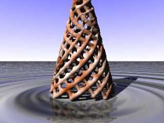

Date: 18 Apr 2001 22:16:39
Message: <3ADE4A96.BA3EA7B@pobox.com>
> (more sinewy, or like bones) ...
alien, eh?
#declare h=1;
#declare mh=100;
#declare goldangle = pi*(3-sqrt(5));
blob    {
        threshold .86
        #declare theta = 0;
        #while (h<mh)
        #declare g = sqrt(f);
        #declare zed = 20*(1-g);
        sphere { 0,1.18,1
                translate <5*g,zed,0>
                rotate y*degrees(theta)
        #declare theta = theta + goldangle;
        #declare h=h+.5;
        #end
        pigment { bozo
                color_map {
                        [0 rgb 1]
                        [1 rgb <0.6,0.2,0>]
Download 'bryan2.jpg' (15 KB)
Preview of image 'bryan2.jpg'
