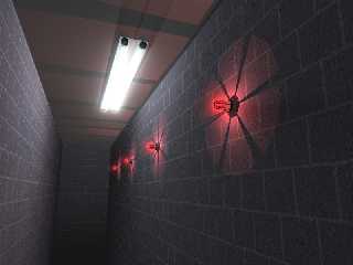

From: Bill DeWitt
Subject: Re: Glows
Date: 30 Sep 2000 17:01:33
Message: <39d654ad@news.povray.org>
"ryan constantine" <rco### [at] yahoocom> wrote :
>   do you
> plan on developing the scene further?  i think you should.  i like it so
> far and see a lot of potential.
    OK, so I did change things a little and I might end up making a scene
from it. The fluorescents need some work and a few more basic parts, but I
think it is possible to make some good ones with glows.
Download 'Test Glow 08.jpg' (48 KB)
Preview of image 'Test Glow 08.jpg'
Subject: Re: Glows
Date: 30 Sep 2000 21:48:36
Message: <slrn8td57u.5uj.steve@zero-pps.localdomain>
>>   do you
Like you say the flourescents seem to fuse in the middle.  And maybe a good
idea to use a wall mactro, those lumps overlap mortar/block.  I seem to
remember Bob (or was it Grim), who did some real good concreet block quite
a while ago that would look great in here.
Those emergency lights do look good.

From: Peter Popov
Subject: Re: Glows
Date: 1 Oct 2000 04:47:56
Message: <o8udtsg3nircf5rfrmivodg60708fk1ffm@4ax.com>
On Sat, 30 Sep 2000 17:01:10 -0400, "Bill DeWitt"
May I recommend using radiosity only to light your scene? Those
shadows are way off with such a blurred glow, methinks.
Peter Popov ICQ : 15002700
From: Bill DeWitt
Subject: Re: Glows
Date: 1 Oct 2000 08:59:04
Message: <39d73518@news.povray.org>
    I have done a couple of tests of that, but until I really get somewhere
with the scene, I don't think I will be rendering many radiosity tests...
Maybe there are some adjustments I could do, but 20 min without and 7.5 hrs
with....?

From: Bill DeWitt
Subject: Re: Glows
Date: 1 Oct 2000 18:37:49
Message: <39d7bcbd@news.povray.org>
> Holy pieces o' cow!!!
    After removing the other lights, bounding (radius) the glows and
reducing the number of them plus a few adjustments to radiosity, it sped up
significantly. But it looks like pieces of cow waste now... what am I doing
wrong?
Download 'Test Glow r 12.jpg' (20 KB)
Preview of image 'Test Glow r 12.jpg'
Subject: Re: Glows
Date: 2 Oct 2000 03:27:26
Message: <39d838de$1@news.povray.org>
"Bill DeWitt" <the### [at] earthlinknet> wrote in message
news:39d7bcbd@news.povray.org...
up
doing
| wrong?
This loses a lot without the lighting.
A low error_bound is probably needed, say about 0.2 or so.
Did you see what Xplo Eristotle had tried for radiosity settings?  Posted
here recently; seemed to do well both for time and quality from what I saw
of it.
Your fluorescent lights show a great example of the use of glows.
