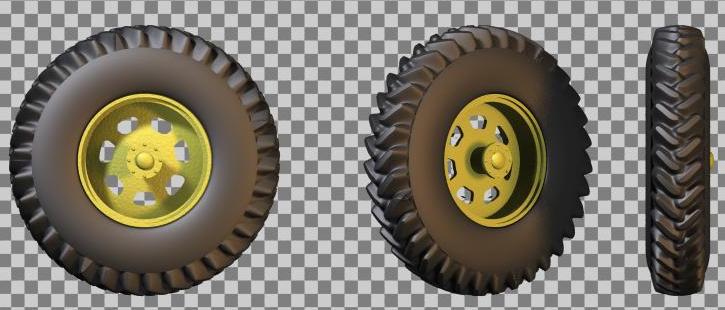

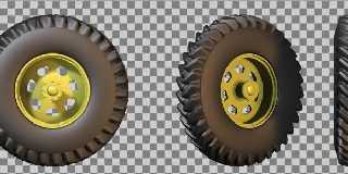

A sample from the current work, which is a megapov macro to make tyres
(1st pic) with isosurfaces given the shape of the "sculptures" (en ?) as
a png bitmap (2nd pic).
Now I have a problem. The lateral parts of the tyres are made with
lathes, and I would like to connect them smoothly to the deepest part of
my isosurface, which is a 4th degree profile. I know the tangent to my
profile, and need to keep the same on the lathe. So my question is: what
is the slope of a cubic_spline lathe profile at one of its control
points?
TIA.

Ah, so you've actually made it! Look great and quite like a real
thing.

Looks good, esp. the wheels outer part and the rim.  You seem to be
quite a perfectionist about the rim-tyre connection.  More important,
the connection between the spline and the outer part seems a bit broken
(probably because the first/last line of the png have no constant
color). I'm not totally sure about this :-)
BTW, most tyres have some structure in form of radial/circular margins
from the vulcanization process, very small, but maybe some normal would
do that.
I would really like to see the code :-)

Wow...impressive! I can't wait for this to be finished...
I noticed this too. And you have given the right reason. Nothing to
worry about in the code.
