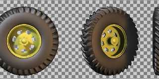

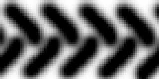

A sample from the current work, which is a megapov macro to make tyres
(1st pic) with isosurfaces given the shape of the "sculptures" (en ?) as
a png bitmap (2nd pic).
Now I have a problem. The lateral parts of the tyres are made with
lathes, and I would like to connect them smoothly to the deepest part of
my isosurface, which is a 4th degree profile. I know the tangent to my
profile, and need to keep the same on the lathe. So my question is: what
is the slope of a cubic_spline lathe profile at one of its control
points?
TIA.

From: Peter Popov
Subject: Re: Tyre macro preview + question
Date: 18 Jun 2000 18:20:17
Message: <pthqks01nru793na7kicbg2b777eotn3uc@4ax.com>
On Sun, 18 Jun 2000 21:04:42 +0000, Francois Dispot
Ah, so you've actually made it! Look great and quite like a real
thing.
>points?
Just out of curiosity, isn't the formula in the source code of POV? If
you can't find it, can you use trace() ? Lastly, why don't you use a
bezier spline lathe? At least you won't be wondering where its
tangents are pointing.
Peter Popov ICQ : 15002700

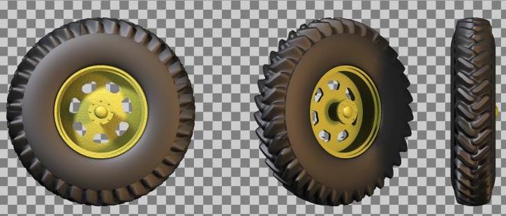

Looks good, esp. the wheels outer part and the rim.  You seem to be
quite a perfectionist about the rim-tyre connection.  More important,
the connection between the spline and the outer part seems a bit broken
(probably because the first/last line of the png have no constant
color). I'm not totally sure about this :-)
BTW, most tyres have some structure in form of radial/circular margins
from the vulcanization process, very small, but maybe some normal would
do that.
I would really like to see the code :-)

From: Francois Dispot
Date: 19 Jun 2000 14:03:12
Message: <394E605F.1DACF7D0@club-internet.fr>
Excellent suggestion. The most obvious way to do what I want is a Bezier
spline... if only I happenned to find the syntax somewhere in the docs!
      __  __ __  __  _
|  | /  \  /  / |_  /  |/
\/\/ \__/ /_ /_ |__ \_ |\
Date: 19 Jun 2000 14:05:00
Message: <394E60CB.CCC6332A@club-internet.fr>
I noticed this too. And you have given the right reason. Nothing to
worry about in the code.
> do that.
Sounds interesgting. Could you elaborate on this, please?
Probably in a few days or so.
      __  __ __  __  _
|  | /  \  /  / |_  /  |/

From: David Wilkinson
Date: 19 Jun 2000 18:09:32
Message: <gf6tkskukcv5crv57edgpbj1tpfa72c3f4@4ax.com>
On Mon, 19 Jun 2000 18:03:11 +0000, Francois Dispot <woz### [at] club-internetfr>
wrote:
The information is there under Lathe, but it is very sparse.
 Bezier splines are actually very easy to use.  For each span (pair of points)
you have to give;
<point1>,< control point1>, <controlpoint2>,<point2>
where the control points are the end points of the tangent vectors.  The curve
will be tangent to the vector at its associated point, and the length of the
vector determines the curvature at its associated point.
e.g. this makes a pretty good sphere;
lathe {
  bezier_spline
 12,
  <0,1>, <4/3*(sqrt(2)-1), 1>, <1,4/3*(sqrt(2)-1)>, <1,0>, // 1st span
 <1, 0>, <1,-4/3*(sqrt(2)-1)>,  <4/3*(sqrt(2)-1), -1>, <0,-1>, // 2nd span
<0,-1>,<0,0>,<0,0>,<0,1> // 3rd span
  pigment {Red}
(the 4/3*sqrt(2)-1 term just gives a length of vector that makes the bezier
cubic approximate to a circular arc)
David
