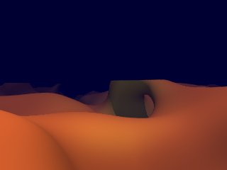

I've made a smooth landscape using an isosurface containing noise3d + y
.  Note in the image below how some of the features are truncated: flat
tops. I want it to be completely smooth, but have this general feel.   I
was trying to figure out what might have been wrong with my code.  But
then I remembered a similar thread about some of the noise-based
pigments in povray.  Did I hear something to the effect that the pov
designers used an unorthodox definition of the noise (something about
the interval?) ?
The question is: which of the scenarios below are most probable:
1. I may acheive smoothness by fixing my code;
2. I will fail because these flat tops are inherent in any (correct)
application of noise;
3. I will fail until a pov version comes out with a "correct"
application of noise.
Download 'isosu368.jpg' (5 KB)
Preview of image 'isosu368.jpg'

My guess is 1.  I don't think noise3d suffers from the same problems
as bozo and other patterns.  Try making your bounding box larger.

No, I believe I have a bounding SPHERE, but I'll have to check the code
at home this evening.
I acheived this surface by something on the order of:
    isosurface{noise3d(x,y,z)  + y }.
___________________________

Actually, it does, but it doesn't show up in most images because the
flat area is in the center of the blobs formed. This simple isosurface
demonstrates the problem:
isosurface {
   function {y - noise3d(x*2, 0, z*2)*0.33}
   eval
   max_gradient 1.1
   threshold 0
   bounded_by {box {<-2,-2,-2>, < 2, 2, 2>}}
   accuracy 0.001
   texture {
      pigment {color rgb < 0.095, 0.45, 0.2>}
Chris Huff
