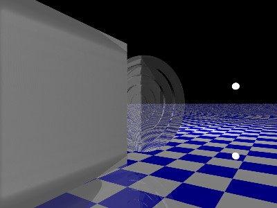

Thank you Nathan!!
The picture itself is boring, but to me it shows the accuracy of Nathans
patch.
I modelled a fresnel lens wit a focaldistance of 5 units, put a lightsource
at 5 units from it. The result should be, and is a parallel beam of photons.
photons
      gather 30, 100
      radius 0.1, 2, 0.1
      jitter 0.2
 photons {
      density 0.002
      refraction on
It (800 x 600) took about 5 h 30 m to render on a PII 233.
ingo
Met dank aan de muze met het glazen oog.
Download 'FresnelPhoton.jpg' (23 KB)
Preview of image 'FresnelPhoton.jpg'

This is pretty cool!
A note about the render time: whenever you have photons hitting almost
parallel to a surface (as you have here), you'll need a relatively high
density (as you have here), which means long render time.
You might be able to decrease the density without losing quality (but
maybe not).
-Nathan

I tried with lower density, but even with this one (on 800x600) you can see
the circular patterns of the photons on the outside of the beam.
Oh, and while correcting the position of the "lightbulb", I found that no
photons are gatherd when the lightsource is inside an object with a
looks_like statement.
ingo

Very true.  Hmm... now that you mention it, maybe I should check the
no_shadow flag.  I might also change the meaning of "photons_pass_through"
to let photons go straight through (right now they get refracted).
-Nathan
