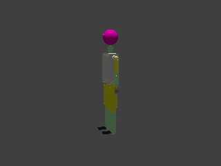

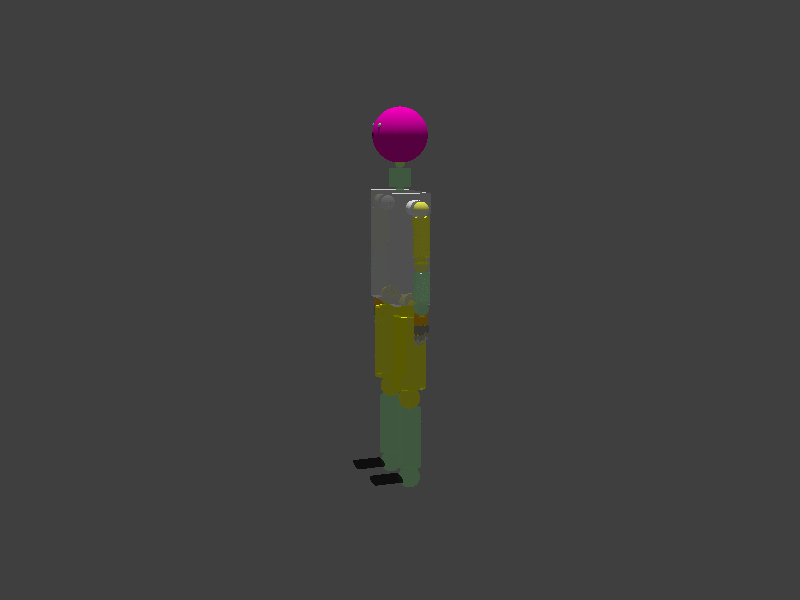

I solved so many really tricky problems one after the other, only to find that I
hadn't even done a quarter of the way.
It started with from where to where build it up. This affects how it behaves in
not-standing positions (e.g. leaning to the side, jumping,...) and how he can be
controlled.
And then, of course, the appearance, how the individual parts can be human-like.
And the damn skull, I hadn't even touched it yet.
And... and... AND...

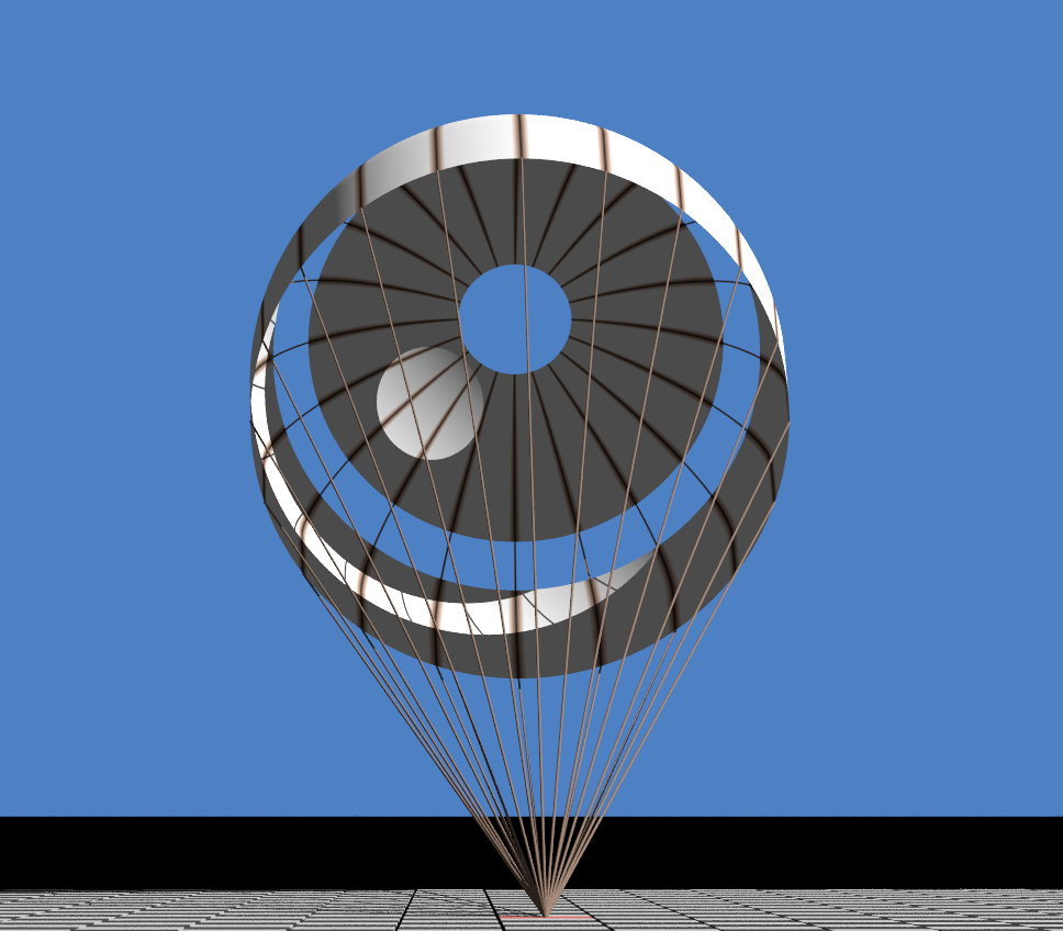

It was very easy and small. Here it is:
 #declare PPig=pigment{radial color_map{[0 Black][.1 Tan]
                    [.3 rgb<.9,.9,.85>][.6 rgb<.9,.8,.85>]
                    [.9 Tan][1 Black]}
                    frequency 20}
 #declare Para= union{sphere{0,4 translate y*2
                    clipped_by{ box {<-4.1,4.4,-4.1>,<4.1,5.9,4.1>}}}
                    clipped_by{ box {<-4.1,3.5,-4.1>,<4.1,2,4.1>}}}
                    cone{y*2,4,-y*.25,3.9 open}
#declare ParaChute=
 union{
  object{Para pigment{PPig} translate y*50}
  sphere{0,1 scale<1,.25,1> translate y*25 pigment{rgb<.25,.15,.25>}}
 //cords
   #declare Cnt = 0;
  #while (Cnt < 360)
   cylinder{0,<4,20,0>,.05 rotate y*Cnt pigment{Tan*.5} translate y*30}
  #declare Cnt = Cnt+20;
  #end
   cone{y*25,.15,y*31,.2 pigment{rgb 0}}//short link
   cylinder{0,y*30,.15 pigment{rgb 0}}//long link
Straight from the code, It is fairly long 50 or so POV units.
Have Fun!

I worked far longer than week on the robot AND THAT DID NOT HAPPEN !!!
Parachute successfully opened!
I fixed some small errors (missing cords in the gap, ...) and will make it more
variable in the next days, but so far the chute looks cute :)
Will send you the code when ready.
Thanks for that.
To build that from scratch would cost much more time.
Ma
