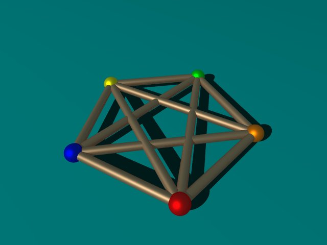

I haven't got the smarts to deal with real physics or the imagination
to come up with my own ideas for animations, so I stole your idea...
I gave the beans from my last posting a linear attraction to the origin,
a 1/distance repulsion from each other, and filled the space with a
constant friction factor.  I also added a love of the ground to these
little guys.  The full (5MB) movie is http://members.home.net/spock19
I use a Java program to pre-compute the positions of each point in
each frame and POV to render the frames.  This time I chose to show
each point as a sphere and connected them with cylinders (stealing
from you once again :-)
If you want a copy of my code just ask.  I should warn you it makes
no attempt to implement physics (phony or otherwise), but it seems to
make interesting movies...

Download 'Spring90.jpg' (21 KB)
Preview of image 'Spring90.jpg'
