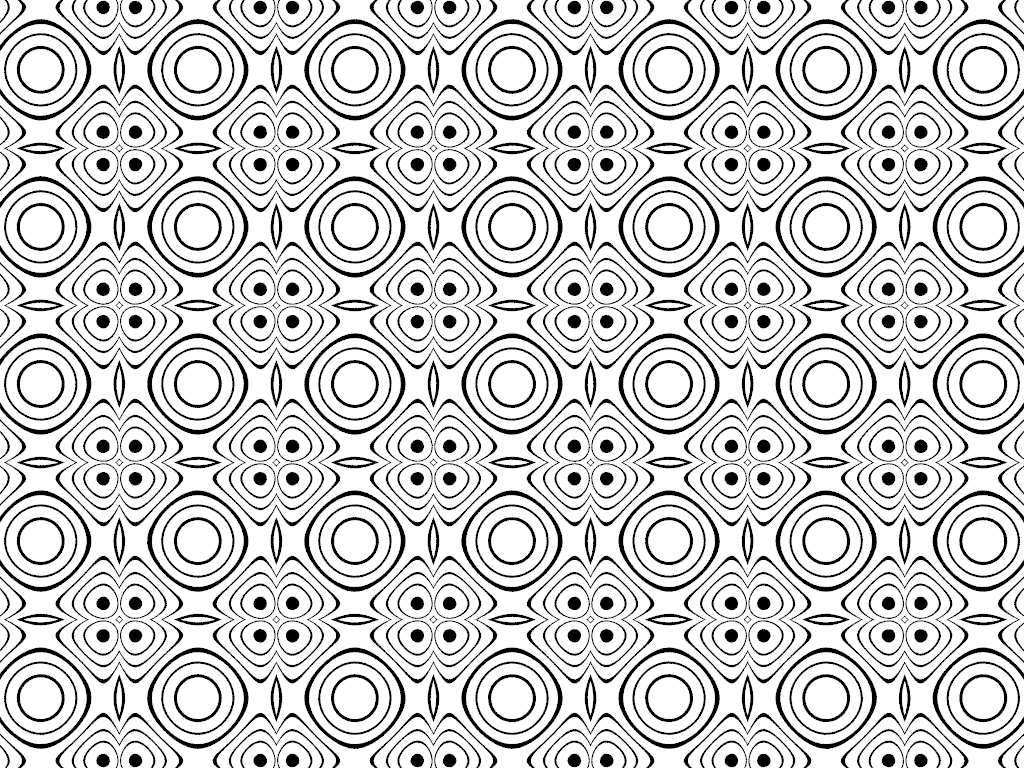

From: Bald Eagle
Subject: Re: Making Patterns with functions
Date: 12 Feb 2024 18:50:00
Message: <web.65caadc8d81b84791f9dae3025979125@news.povray.org>
I played with a few more functions - I think I'm up to about 189 in the
collection, and still have many more to implement.
This one I liked because it was "simple", and would probably find use in any
number of scenes, for different purposes.
Like the ultra-impressive Greek frieze pattern, this one got adapted from
Desmos, and it takes a lot of reading and thinking to grasp Desmos' syntax /
expression structure, unravel what is meant, and discard the superfluous parts.
I got it wrong about a dozen times, but in the process found that sometimes the
mistakes yield some pretty amazing and complex pattern in and of themselves.
So, when experimenting with new patterns, don't give up, and don't be surprised
when the raw pattern seems to bear absolutely no relation to the pattern that
you're trying to code.  The raw vs "thickened" pattern can differ - starkly - in
appearance.
Hopefully we can get a few new patterns posted in this thread, and I'm going to
try to post at least one new pattern a week, to keep some momentum going.
Hope you like.
- BE
Download 'mathpatterns1.png' (59 KB)
Preview of image 'mathpatterns1.png'

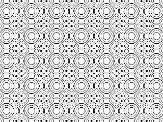

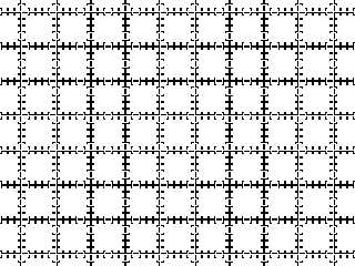

From: Bald Eagle
Date: 13 Feb 2024 18:15:00
Message: <web.65cbf72dd81b84791f9dae3025979125@news.povray.org>
> I'm going to try to post at least one new pattern a week, to keep some momentum
going.
Download 'mathpatterns1.png' (193 KB)

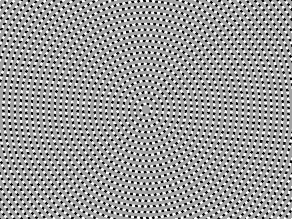

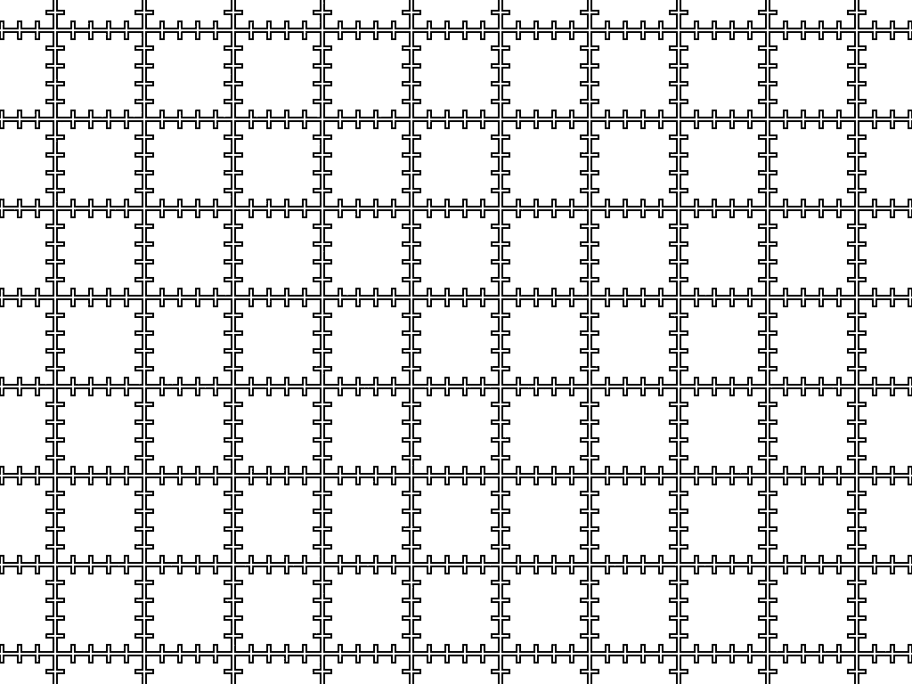

From: Bald Eagle
Date: 13 Feb 2024 18:20:00
Message: <web.65cbf809d81b84791f9dae3025979125@news.povray.org>
Neat grid pattern.
Download 'mathpatterns1.png' (15 KB)

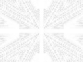

From: Bald Eagle
Date: 13 Feb 2024 20:55:00
Message: <web.65cc1c56d81b84791f9dae3025979125@news.povray.org>
"Tor Olav Kristensen" <tor### [at] TOBEREMOVEDgmailcom> wrote:
> I like this one.
I do too, which is why I posted it.
It brought to mind the vintage Corelle plate rim pattern. (attached)
> It seems like you're getting pretty good at this.
I'm getting a bit better at finding interesting patterns and translating them
from other languages/syntaxes.
I still have a devil of a time with some of them.
Some I can't get to work at all, especially if I have to make lines, use x and y
at the same time, or try to make a parametric function based on atan2(y, x).
I'm also trying to figure out why sometimes I only get a partial pattern.
But they _are_ more than formless grayscale vomit, so there is definitely some
progress.
When I understand WHY things work or don't, and know enough to fix them, then I
will be lots better.
When I can invent such functions on my own, then I will be good.
But that was half of the goal of this - to try implementing so many functions
that eventually I found changes that worked, and could be applied to others that
failed, and iteratively get better.
I'm almost at 200 functions, and at some point I'll have (temporarily) run out
of patterns to copy, and can start investigating variations and combinations.
There also seems to be various common methods for making patterns, and perhaps I
can distill them all down into several macros to make rendering each method a
little easier.
Thank you as always for your interest, tutelage, and encouragement.  :)
- BW
Download 'p0000016777s000000469617t1.jpg' (81 KB)
Preview of image 'p0000016777s000000469617t1.jpg'

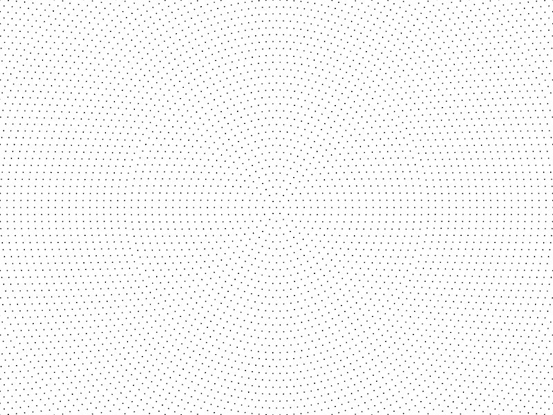

From: Bald Eagle
Date: 13 Feb 2024 21:05:00
Message: <web.65cc1f5ed81b84791f9dae3025979125@news.povray.org>
Here's one to torture your eyes.  :P
Download 'mathpatterns1.png' (422 KB)
