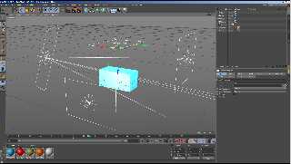

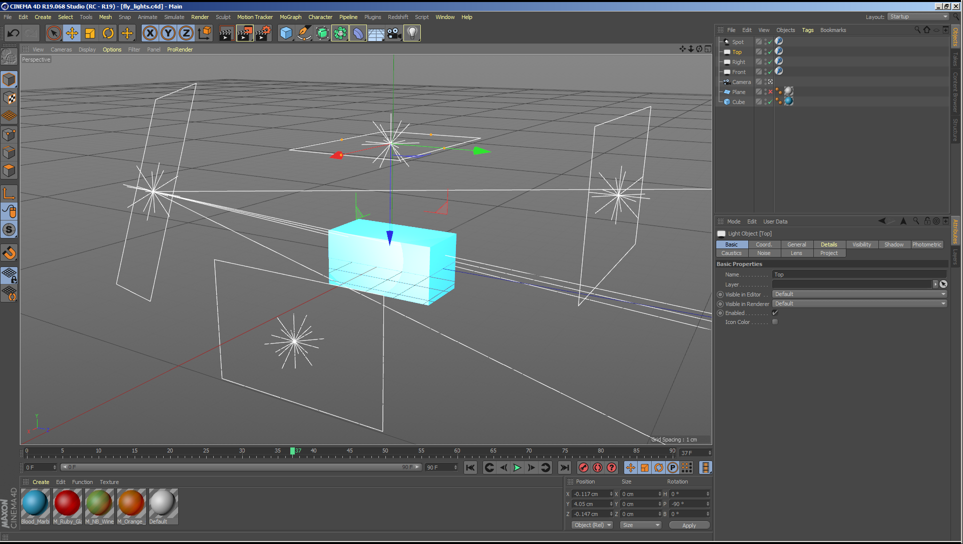

Hi,
I am working on Mike's fly lighting and animation now.
To simplify and To speed up this task, I am using my C4D->POV converter
for lights exporting, but I need some reference object in the C4D scene
to replace a fly (see attachments).
I can draw a BB box approximately, but if someone will show me the
way to calculate BB of arbitrary objects, I will be able to set up
lighting more accurately.
Thanks in advance.
YB
