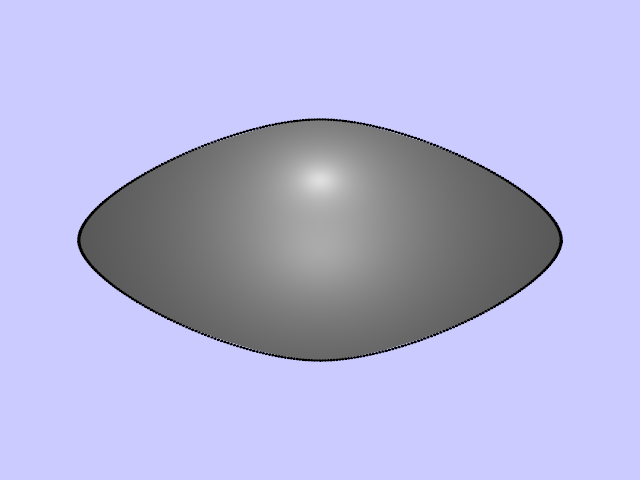

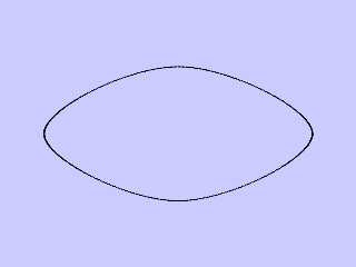

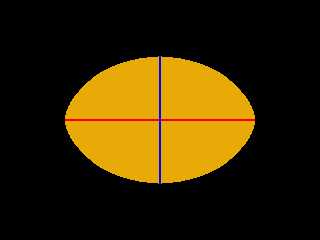

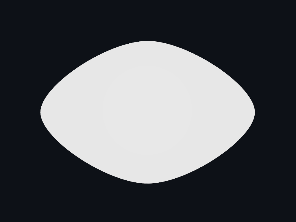

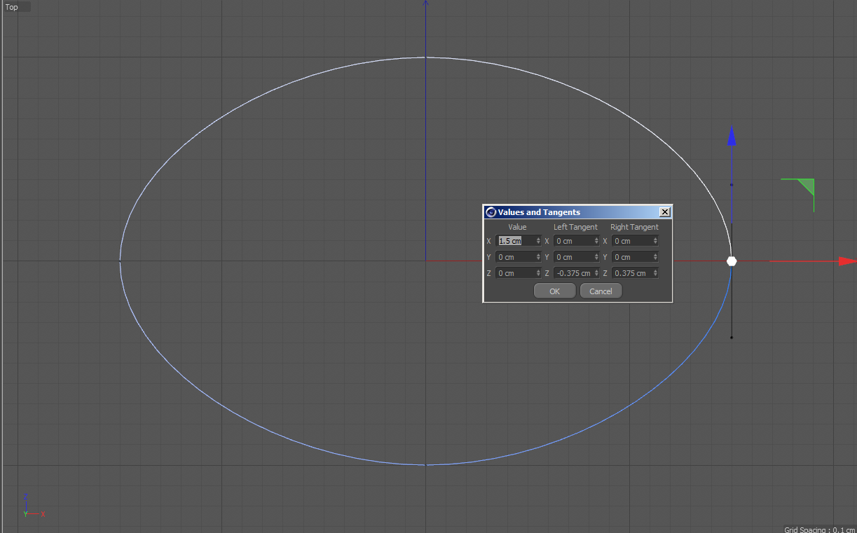

Data is following:
#declare Extrude = prism { linear_sweep bezier_spline 0, 3.000000, 16
   <15.000000, 0.000000>   // P1
   <15.000000, 3.750000>   // T2
   <5.625000, 10.000000>   // T3
   <0.000000, 10.000000>   // P2
   <-5.625000, 10.000000>  // T4
   <-15.000000, 3.750000>  // T5
   <-15.000000, 0.000000>  // P3
   <-15.000000, -3.750000> // T6
   <-5.625000, -10.000000> // T7
   <0.000000, -10.000000>  // P4
   <5.625000, -10.000000>  // T8
   <15.000000, -3.750000>  // T1
   matrix
  <0.100000, 0.000000, 0.000000,
   0.000000, 0.100000, 0.000000,
   0.000000, 0.000000, 0.100000,
   -0.005274, 0.030602, -0.017559>
   material { texture {pigment {rgb <1,1,1> }}}
object{ Extrude }
Results attached.
YB
Download 'romb.png' (108 KB) Download 'c4d_test.png' (15 KB)
Preview of image 'romb.png'
Preview of image 'c4d_test.png'

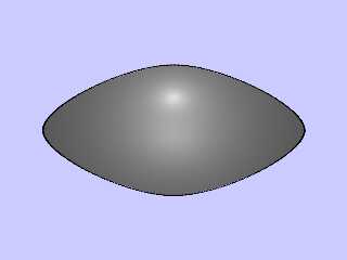

From: William F Pokorny
Subject: Re: Bezier spline deformation
Date: 22 Mar 2023 09:07:31
Message: <641afd93$1@news.povray.org>
On 3/22/23 05:05, yesbird wrote:
> The problem is in different results of splines rendering in C4D and POV,
> I can't even imagine how it could be.

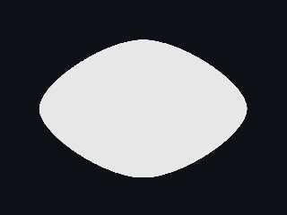

A bit of wild guessing. In looking some at font rendering code years
back, I noticed what looked like bezier spline p1-c1-c2-p2 incoming
point sets being converted to p1-p1_2((c1+c2)/2)-p3 and then the
duplicate end points getting compressed. The resulting point list was
then rendered with via cubic_spline.
The why of all it then, I do not know. But, if I do that conversion on
your bezier_spline point list and create an equivalent cubic_spline of:
#declare Extrude2 = prism { linear_sweep cubic_spline 0, 1.000000, 11
    <0.975347, -0.725347>
    <1.500000, 0.000000>
    <0.975347, 0.725347>
    <0.000000, 1.000000>
    <-0.975347, 0.725347>
    <-1.500000, 0.000000>
    <-0.975347, -0.725347>
    <0.000000, -1.000000>
I get the attached image using an orthographic camera and if not a match
for what c4d is showing in your last post, it looks to me to be in the
ballpark.
Bill P.
Download 'yesbird.png' (4 KB)
Preview of image 'yesbird.png'
From: yesbird
Date: 22 Mar 2023 10:00:50
Message: <c398b209-071c-9ae3-9f8e-40a4a4d6eeca@gmail.com>
> ballpark.
Thanks a lot for this experiment, the shape becomes much closer to
original and I see that POV gives a lot of space for 'hoodoo'.
As I expected before, to achieve exact matching, I need to do some
adjustments of original data. Not much of a fun, but this is reality ...
YB

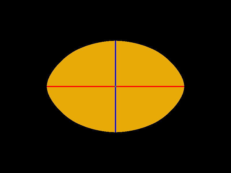

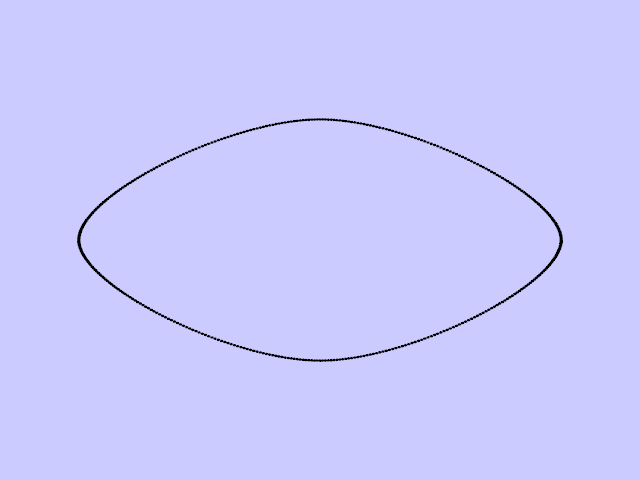

From: Bald Eagle
Date: 22 Mar 2023 18:55:00
Message: <web.641b8701122e7e3a1f9dae3025979125@news.povray.org>
I plotted out the points following the standard cubic equations described by the
Bernstein polynomials and got the attached shape.   So --- it looks to me like
the other software package is doing something strange?
Maybe try another program, or an online tool to see what kinds of results you
get?
- BW
Download 'bezierspline.png' (12 KB)
Preview of image 'bezierspline.png'
From: yesbird
Date: 23 Mar 2023 02:49:56
Message: <2e9fd20a-4f14-56dd-aaf5-71ec3c16d302@gmail.com>
As I see your plot also not matching to POV version - vertical size is
less.
> get?
Here I've posted Matlab version - it matches to C4D:
news://news.povray.org:119/b44b0560-ea7d-f389-12d8-47cbc7d21017@gmail.com
YB
From: Bald Eagle
Date: 23 Mar 2023 06:30:00
Message: <web.641c2940122e7e3a1f9dae3025979125@news.povray.org>
> less.
Well, your first data set is 1/10th the size of what you later posted as a
prism.  Here's my shape based on your most recent dataset post, and your
original prism simply scaled by 10.
So, I mean, to my eye, they "match" close enough for what we're talking about
here.
linky no worky.  But I did see your past pasts, and the other one is indeed
rounder.
Puzzling indeed.  Troubling as well.
