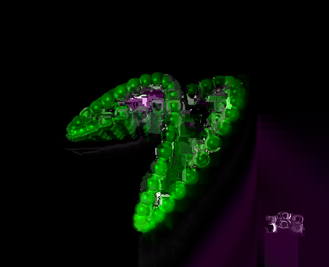

As far as lossless codecs go, only Huffyuv is actually usable. FFV1
produces somewhat smaller files, but it's too slow for realtime
playback. (As you can see, it locked up one core of my dual-core
processor.) H.264 lossless was smaller still, but on playback the
picture was spectacularly broken. Even in Virtual Dub, all the colours
are mixed up and there are random lines everywhere and it basically
looks like a bug in the codec. It is *not* lossless!

From: Orchid XP v8
Subject: Spectacularly broken
Date: 3 Nov 2008 16:48:06
Message: <490f7196@news.povray.org>
In case anybody wanted to know what I mean by "spectacularly broken"...
http://blog.orphi.me.uk/
http://www.zazzle.com/MathematicalOrchid*
Download 'broken1.png' (128 KB)
Preview of image 'broken1.png'
