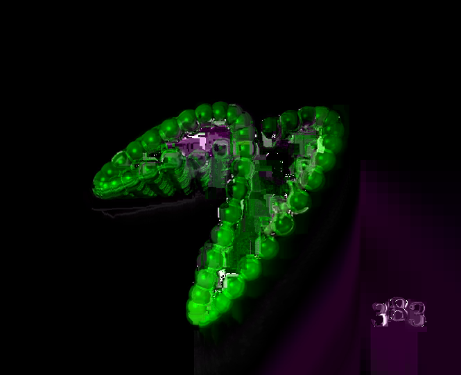

In case anybody wanted to know what I mean by "spectacularly broken"...
http://blog.orphi.me.uk/
http://www.zazzle.com/MathematicalOrchid*
Download 'broken1.png' (128 KB)
Preview of image 'broken1.png'
