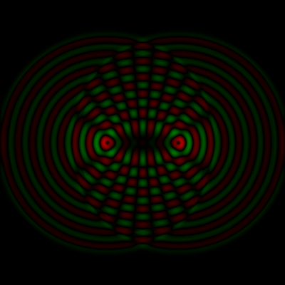

This is from a test run. I'm hoping to make the thing programmable.
(I.e., so you don't have to recompile the program every time you want to
run a different simulation.) If I get this working, maybe I'll post the
completed program...

Cool!  What language are you using, Haskell?  It's pretty cool how with the
very simple wave equation you can get all the pretty circular ripples and
reflections.
I did have a version that did the calculations on the GPU a while back, I'll
have to dig it out and put in on YouTube or something - still images just
don't do the wave equation justice!

Indeed. Although I'd actually prefer the waves to *not* reflect off the
edges of the framebuffer... but I can't see a way to achieve that.
You kind of get that effect automatically by not bothering to calculate the
values around the border (ie clamping the border values to zero).  You can
see this IRL by fixing a string at one end, pulling the other end tight, and
then applying waves to the string - you will see them reflect off the far
end.
If you want to avoid reflections then what (I think - not tested!) you need
to do is calculate the points around the border of your simulation just like
the others.  Of course you cannot work out the derivatives the same way
because there are no further points out, but if you fix the derivative
outside to zero then that should work.

Indeed, the *cause* is obvious. The *solution* is not.
> need to do is calculate the points around the border of your simulation
> just like the others.  Of course you cannot work out the derivatives the
> same way because there are no further points out, but if you fix the
> derivative outside to zero then that should work.
Actually, my simulation treats all points the same. The only difference
is that in computing the derivatives, any point outside the actual grid
is assumed to be zero. (This effectively creates zero-clamped points
just outside the image.)
Perhaps what I should do instead is set the derivatives to zero for the
edge points? But that would still give me a set of points that never
actually move... hmm...

No no, set the 1st derivatives outside of the grid to be zero, then when you
calculate the 2nd derivative you could still get a non-zero value.
So at [0], you would want to calculate:
2nd deriv = (x[1] - x[0]) - (x[0] - x[-1])
What i mean is to replace the (x[0]-x[-1]) term by zero.  I have no idea if
that will work or not, but it seems like it might.
This is nearly done.
I'm having a spot of local difficulty with the parser, but basically the
program is in a working state now. For example, see the attachment. ;-)
Download 'frame000260.png' (22 KB)
Preview of image 'frame000260.png'
