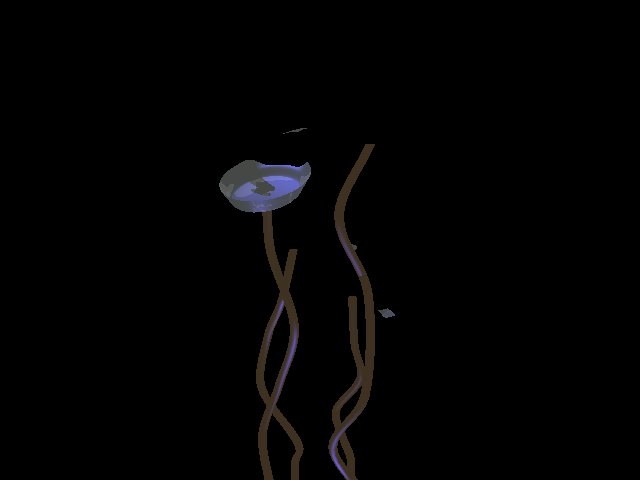

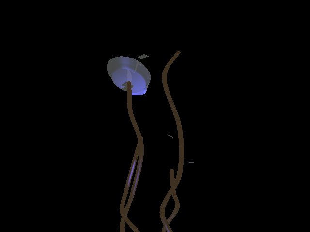

Hi, hope someone can help
I've modeled a bowl using sPatch and exported it in POV format. (it uses
'bicubic_patch'es)
I modified the file produced to use #declare to name the union object.
I then use
object { tray
  texture { T_Silver_5B }
and render.
Lovely...
except that when I shine a blue spotlight at the bowl from underneath
and place the camera on top, I see the floor of the bowl is blue (and
shows a shadow from a pipe placed beneath the bowl)
camera
V
Bowl
pipe
light
If I put the camera underneath, and look up, the floor of the bowl looks
the same.
I've sent some small (10k each) images.
Am I doing something wrong here?
Why can I see through my bowl?
David
PS For those who helped with the bendy pipes - here they are :)
Download 'above.jpg' (12 KB) Download 'below.jpg' (12 KB)
Preview of image 'above.jpg'
Preview of image 'below.jpg'

From: David Greaves
Subject: Re: Help- Unwanted see-through-ness in objects
Date: 1 Oct 1998 11:02:08
Message: <36138CC4.6E8891E4@telekinesys.co.uk>
Thanks for looking :)
The second picture is correct (or at least its what I expected!!)
You can indeed see a nice reflection of the pipe. You can also make out
the shadow of the pipe that is present on the upper picture.
The top picture has the problem.
How can I see the floor of the bowl?
There should be *no* light illuminating this surface at all!!
(The only light is a spot pointing 'upwards')
No there are no mirrors out of shot!! ;D
You should be able to see the outer wall of the bowl - thats fine.
And the lip where I curve the patches over, maybe thats too sharp and has
bicubic break-up.
But that shadow is too perfect and the floor's too evenly lit.
nb all bicubics have flatness 0.
I did try it with
pigment { Silver }
and got the same result.
I checked and the texture I used has no filters...
David
