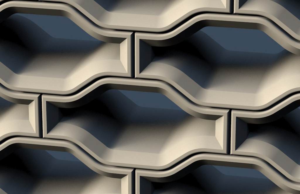

Oh yeah, for people who haven't heard, rlp produces objects similar to
traditional prisms. It's pretty much like working with a linear_spline prism,
except that you can add roundness to each corner and give the object beveling.
(And you define points as arrays).
Here's a link to my v0.2 announcement:
http://news.povray.org/povray.object-collection/message/%3C4c9d5435%40news.povray.org%3E/#%3C4c9d5435%40news.povray.org
%3E
Attached is a demo image I never posted (I think). It shows off the the sharp
corners and multiple beveling capabilities of v0.2. It's one rlp object copied,
translated and rotated.
Sam
This looks fabulous. Thanks for posting the code again (and the link to your
earlier demo image.)
