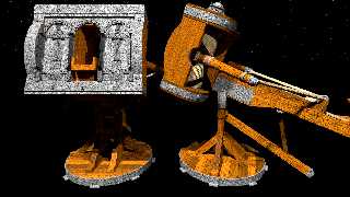

From: Bald Eagle
Subject: Re: HELP REQUEST: Twisted Ropes of Ballista
Date: 6 Mar 2020 19:15:01
Message: <web.5e62e6c45f4031dc4eec112d0@news.povray.org>
"Sven Littkowski" <nomail@nomail> wrote:
> I am hospitalized now, at risk of losing my right leg. So forgive me, if there
> are days where I am emotionally not able to post here.
Jeez.  I hope they are able to give you everything that you need to make a full
recovery!  :O
I was only able to make a few more edits, but it addresses most of what I
pointed out.  I think the heightfields are ok, and might only need a few
adjustments. I can post the edited file in the text scene files section so you
can go over it and see what it looks like.
Stay in good spirits and keep a fighting mindset.  A positive mental attitude
has been empirically shown to have as much or more effect on health as
medicine(s).
All the best, Sven
Download 'romanballista_v3.png' (1093 KB)
Preview of image 'romanballista_v3.png'
From: Sven Littkowski
Date: 6 Mar 2020 21:30:01
Message: <web.5e6306f45f4031dc5f7af7120@news.povray.org>
Hi, thanks for the good wishes!
I really like the wooden patterns! Oh, I forgot to mention that I put a
translucent color on top of my own wood, to allow to change the color of the
wood. Romans painted their ballista. Still, the wooden pattern (normal) would
still be recognizeable.
I think, your wood is really clodse to the final version, but we have to allow
the future object users to change the appeal of the wood, like light brown or
medium, and the paint color that was used on the wood.
It also seems you did somethign with the bolts on the front shield, right? Can
you give me a copy of the scene file? I want to run it in high-resolution.
