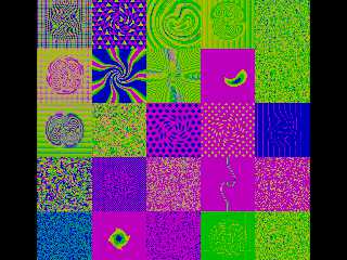

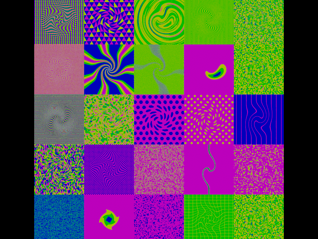

So, I managed to get this applied to 25 patterns for illustration purposes.
I thought I broke it again, but it was just a bad bit of applying the texture
space to a box - which reminded me that I also wanted to put a y-component back
into the pattern.
This would then make a great pattern to use in an isosurface.  :)
Anyway - here they are, with some adjustment to scaling and a few translations
to nudge the appropriate ones over from the origin.
Download 'vortex_warp.png' (827 KB)
Preview of image 'vortex_warp.png'

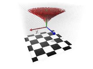

So I got the isosurface working with a pigment function, after Mike Williams'
invaluable site gave me the crucial function {} - 0.5 trick.
Then once I got the isosurface to display what was actually going on in 3D, I
realized that there was some rewriting needing to be done.  The quicky function
that I piggybacked onto BP's code resulted in a plane at y=0 that looked great,
but as my earlier attempts at displaying the 25 different patterns suggested,
and the isosurface confirmed, all was not well at y != 0.
The distance function was spherical, and IIRC, I had changed the rotated pattern
to cylindrical (y=0). That resulted in a weird sphere of rotated pattern inside
an empty cylinder, surrounded by the default pattern.
So I fixed all of that, and then had to limit the rotation to only take place in
the 0 < y < 1 region.  That made my head hurt for most of the morning.   Got
that straightened out, and then generalized it to 0 < y < Radius.
So then had to concoct some sort of way to take that little cylinder of space
and taper it so that it was full radius at y=1, and 0 radius at y = 0.
So I nested another select function inside the first, and used that to control
where there was twist, and where there wasn't.  After 6 or 8 petit mal
mathematical epileptic fits, and a trip to the laundromat (where I worked it out
in one last attempt) I got a usable equation for proof of concept.
Replacing Pattern(x,y,z).x with 0 gives me empty space where there is no twist,
thus having the isosurface model only the region where the effect is applied.
Then I reversed the outcomes to model only the default pattern with the affected
region missing, and gave that a mostly transparent pigment.
So here's what that looks like so far.
A better set of Falloff equations would be a useful toolkit for people to play
around more with this.
I think if I do 2 (4?) more isosurfaces with the .green and .blue components,
and a rgbf pigment, then maybe I can closely model the full-color pattern in 3D.
Or just do it in media with density patterns.
Anyway here's leopard scale 0.05 in a 4-unit cube with the twist effect in red.
Download 'documentationfigures.png' (441 KB)
Preview of image 'documentationfigures.png'
From: jr
Subject: Re: Vortex pattern
Date: 14 Jul 2019 20:10:00
Message: <web.5d2bc3cf3717ac603936914a0@news.povray.org>
hi,
can this be used to make a "twister" (ie tornado)?  v nice.
regards, jr.
From: Bald Eagle
Date: 14 Jul 2019 20:55:00
Message: <web.5d2bcedc3717ac604eec112d0@news.povray.org>
Sir, here at news.povray.org, we are always happy to receive your requests and
provide exactly these types of much anticipated solutions to highly desired
raytracing pattern problems.
I played around a bit in LibreOffice (for way too long), trying to add a bit of
pizzazz to my otherwise uninspiring YFalloff equation.
Using a _variable_ exponent, along with adding in a small constant in order to
keep the funnel above a certain minimum size was just the ticket.
I literally JUST got done coding this one up.   :)
Might be another one on the way to better illustrate the twister.
Download 'documentationfigures.png' (131 KB)
From: Bald Eagle
Date: 14 Jul 2019 21:20:01
Message: <web.5d2bd4653717ac604eec112d0@news.povray.org>
I had to add a y-component to the pattern to add a twist along y, so now it not
only rotates, it _twists_.  I should probably add a control factor for that into
the formula.  :)
Download 'documentationfigures.png' (84 KB)
From: jr
Date: 15 Jul 2019 11:15:01
Message: <web.5d2c98663717ac603936914a0@news.povray.org>
hi,
> the formula.  :)
looks pretty awesome already, that twist really does it.  :-)  are the solid
bits (isosurface fragments?) solid as in can do meaningful 'inside()' tests?  I
ask because I'm thinking (convert to) DF3.
regards, jr.
From: Bald Eagle
Date: 15 Jul 2019 13:25:06
Message: <web.5d2cb6763717ac604eec112d0@news.povray.org>
> are the solid
So, the way I think it works is that my isosurfaces are open
but if you want to do CSG, you need to just do
isosurface {
all_intersections
inverse // for some functions, I don't think all
// or maybe alternatively use the polarity keyword (vide infra)
http://wiki.povray.org/content/Reference:Isosurface
When the isosurface is not fully contained within the contained_by object, there
will be a cross section. When this happens, you will see the surface of the
container. Using the open keyword, these cross section surfaces are removed, and
the inside of the isosurface becomes visible.
Note: Using open slows down the render speed, and it is not recommended for use
with CSG operations.
Isosurfaces can be used in CSG shapes since they are solid finite objects - if
not finite by themselves, they are through the cross section with the container.
