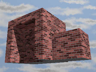

I just spent four days probably 're-inventing the wheel'; but  I wanted to
investigate the behavior of the brick pattern, when using warp{repeat...} with
an embedded cells pattern.
The recent posts about making bricks and wood planking got me to thinking about
this. As-is, the brick pattern's brick color is all the same (i.e., the same
color is repeated brick after brick.)  By using the cells pattern in it, and a
warp{repeat..} statement, random-colored bricks can be made. But the idea can be
applied to other pigments/textures, like wood. And normals.
I'm not totally sure what warp{repeat} does to an already-random cells pattern,
but the result looks satisfactory. The nice thing is, the brick's 'mortar' color
(or user-imposed pattern for that) is NOT repeated, but is 'global/continuous',
thanks to the brick pattern's own underlying code.
As an experiment, I animated part of the warp 'repeat' direction...
                warp{repeat y offset <frame_number + .5, 0 .5>}
.... to get a clue to its visual behavior, at least on the x/y plane. The bottom
row of bricks does NOT change; the 2nd row in y moves 'one brick' to the left
per frame_number; the 3rd row moves two bricks to the left, the fourth row moves
three bricks; and so on. This is probably expected behavior; but to try and
eliminate such an obvious 'repeat' pattern, I used...
    warp{repeat y offset <400 + .5,0,400 + .5>  // try <.5,0,.5> instead
         along with...
                translate -200*y (slightly more/less)
I *think* that the large repeat-y offsets will choose each new 'brick cell'
after skipping 400 units in x and z, rather than just using the next natural
cell along those axes.  But it may not be necessary anyway because the cells
pattern is already random! The added translation is simply to push the lower
brick rows-- with their obvious 'small' repeat movements-- way down into space,
and to instead use the cells pattern where each new brick row (starting at y=0)
shifts by at least 200 units to the left, compared to its lower neighbor. Again,
probably unnecessary.
Try applying the code to the distant z-plane first, to see its random
appearance.
Download 'multicolored_bricks_1.jpg' (1101 KB)
Preview of image 'multicolored_bricks_1.jpg'

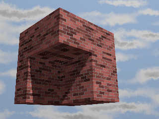

*This* code is what took so long to come up with: re-inventing the brick pattern
from scratch.
After a LOT of trial and error, I finally came up with something that uses
gradient patterns instead (x,y and z), embedding a 'cells' pattern into this,
then using some warp{repeat...} statements. It was an interesting experiment, if
nothing more.
There's a subtle quirk in this code that I haven't figured out yet, having to do
with the 'mortar' thickness (only when the brick y-dimension exceeds the
x-dimension.) Basically, there's a dynamically-changing 'limit' involved as to
the mortar thickness, based on the brick x/y ratio. Otherwise, it works OK.
Also, the mortar pattern is 'discontinuous' -- it is 'offset' in odd ways
because of the warp repeats . But it nevertheless remains scaled correctly in
all axes.
#declare BRICK_RATIO = <8,3,4.5>; // z doesn't really matter,
// it's ignored in MY code(?) . X and y are really just a RATIO,
// not a size scaler. I.e., <1,1,4.5> is the same as <37,37,4.5>
#declare MORTAR_PATTERN = pigment{bumps color_map{[0 rgb 0][1 rgb .8]}}
#declare MORTAR_PATTERN_SCALE = .05; // the bump pattern here
#declare MORTAR_THICKNESS = .124;
#declare PIG_X =
pigment{
gradient x
pigment_map{
    [0
    cells
    color_map{
      [0 rgb .1*<1,.28,.24>]
      [1 rgb .7*<1,.28,.24>]
    [1 - (BRICK_RATIO.y/BRICK_RATIO.x)*MORTAR_THICKNESS
    cells
    color_map{
    // VERTICAL mortar line, only to the RIGHT of brick...
    MORTAR_PATTERN scale MORTAR_PATTERN_SCALE*
    <BRICK_RATIO.y/BRICK_RATIO.x,1,BRICK_RATIO.y/BRICK_RATIO.x>
#declare PIG_X_PLUS_Y =
pigment{
gradient y
pigment_map{
    [1 - MORTAR_THICKNESS PIG_X]
    // HORIZONTAL mortar line, only at the TOP of brick...
    warp{repeat y offset <500.5,600,700>} // x needs the added .5
    scale <BRICK_RATIO.x/BRICK_RATIO.y,1,1>
#declare PIG_FULL =
pigment{
gradient z
pigment_map{
    [1 - (BRICK_RATIO.y/BRICK_RATIO.x)*MORTAR_THICKNESS PIG_X_PLUS_Y]
    <1,1,BRICK_RATIO.y/BRICK_RATIO.x>
    warp{repeat y offset <0,199,900.5>} // y needs to be an ODD integer,
    // and z needs the added .5
    translate .5*z  // important for side walls
    scale <1,1,BRICK_RATIO.x/BRICK_RATIO.y>
//---- end of the brick texture ----
//plane{z,0
// OR...
difference{
box{0,<10.60,10.34,9.54>}
box{-.5,<5.34,6.0,6.40>}
translate <.0001,.0001, .0001>
texture{
    pigment{PIG_FULL scale .40} // FINAL brick scale
    finish{ambient .1 diffuse .9}
translate -5
rotate -40*y
rotate 15*x
translate 20*z
Download 'multicolored_bricks_remade.jpg' (989 KB)
Preview of image 'multicolored_bricks_remade.jpg'
> appearance.
Oops, I forgot to include the first code!
#version 3.71;
global_settings {assumed_gamma 1.0}
camera {
  perspective
  location  <0, 0, -7>
  look_at   <.55, 0.3,  0>
  right     x*image_width/image_height
  angle 46
light_source {
  0*x
  color rgb .9
  translate <20, 50, -10>
// background
plane{z,60
no_shadow
  pigment{bozo
          scale 3*<4,1,1>
          color_map{
                  [.2 rgb .6]
                  [.3 rgb .8]
                  [.35 rgb 1]
                  [.40 rgb 1]
                  [.58 rgb <.5,.7,1>]
                  scale .5
                  warp{turbulence .3 omega .7}
                  scale 1/.5
//plane{z,0
// OR...
union{
difference{
box{0,<9.52,9.66,10.48>}
box{<-.1,-.1,-.16>,<3.84,7.94,6.64> translate 2*z}          }
box{0,<5,4.98,6> translate <2.9,0,-5.7>}
    texture{
    pigment{brick
        pigment{ // the MORTAR
        bumps scale .3 color_map{[0 rgb 0][1 rgb 1]}}
        pigment{cells // the BRICKS
           color_map{
           blend_mode 2
           blend_gamma 2.2
           [1 rgb .85*<1,.28,.24>]
           warp{repeat y offset <400.5,0,400.5>}
           translate .5*z
           scale <8,3,8> // needs to be the same as brick_size
           brick_size <8,3,8> // the default brick-size is <8,3,4.5>
           mortar .5 // can take only a single float value,
           // not a 3-value vector. (.5 is the default.)
           scale .12 // FINAL scale
           translate -196.9*y
           translate -.0001*y
    translate -5
    rotate -50*y
    rotate 15*x
    translate 20*z

From: Kenneth
Subject: Re: random-colored BRICKS
Date: 19 Apr 2018 11:45:01
Message: <web.5ad8b8e895b142bda47873e10@news.povray.org>
Five or six days now, I've lost count!
I went back to POV-Ray's own 'brick' pattern, and worked it all out with full
textures and normals this time. The process has been an experimentatl one,
changing one value after another to see what happens. But the code looks stable
now.
Bill P's code certainly looks less complicated! (I need to take a look at it in
detail... after I take a coffee break!)
#version 3.71;
camera {
  perspective
  location  <0, 0, -7>
  look_at   <0, 0,  0>
  angle 46 // 46
light_source {
  0*x
  color rgb 1.0
// background
plane{z,60
no_shadow
  pigment{bozo
          scale 3*<4,1,1>
          color_map{
                  [.2 rgb .6]
                  [.3 rgb .8]
                  [.35 rgb 1]
                  [.40 rgb 1]
                  [.58 rgb <.5,.7,1>]
                  scale .5
                  scale 1/.5
#declare BR_RATIO = <4,2,4>; // the brick dimensions (just a ratio, not
// really a scaler.) For matching SIDE walls, z needs to equal x--
// a 'square brick'.
#declare MORTAR_THICKNESS = .12; // this is in a different 'scale' than
// POV-Ray's own brick pattern. Here, it's 0.0 to 1.0
// This is get BR_RATIO.y to always be 1.0, for technical reasons that are
// hard to explain ;-)
#declare XYZ =
       <BR_RATIO.x/BR_RATIO.y,
             BR_RATIO.y/BR_RATIO.y,
                  BR_RATIO.z/BR_RATIO.y>;
box{0,9.75
    texture{
       brick
       texture{  // the MORTAR
           pigment{rgb .4} //bumps scale .04 translate 100}
           normal{bumps scale .09 bump_size .7
       texture{ // the BRICKS
           pigment{
                average
                pigment_map{
                [1
                cells
                pigment_map{
                  blend_mode 2
                  blend_gamma 2.2
                [.5 bumps scale .08*<1/XYZ.x,1/1,1/XYZ.z>
                  color_map{
                  blend_mode 3
                  blend_gamma 2.2
                            [.5 rgb .3]
                            [.5 rgb .3*<1,.28,.24>]
           warp{repeat y offset <1000.5,0,999.5>}
           translate .5*z
           scale <XYZ.x,1,XYZ.z>
                  } // end of this pigment
           normal{
           average
           normal_map{
       [1.0 quilted scale 1 bump_size 5] // This pattern doesn't
// need the warp{repeat...} below, which affects it an odd and subtle way;
// note the darker brick 'shadows' in every alternate row of bricks in y.
       [0.4 crackle scale .6*<1/XYZ.x,1/1,1/XYZ.z>  bump_size 5]
       [0.3 crackle scale .2*<1/XYZ.x,1/1,1/XYZ.z> bump_size 3 translate 50*x]
           warp{repeat y offset <1000.5,0,1000.5>}
           translate .5*z
              } // end of this texture
        // still part of the overall 'brick' TEXTURE
        brick_size <XYZ.x,1,XYZ.z>
        mortar MORTAR_THICKNESS
        scale 1 // FINAL scale
        // play with this!
        scale 6
        warp{turbulence .35 omega .6}
        scale 1/6
        translate <-.09,-.09,-.09> // because of warp{turbulence} effects
      } // end of overall texture
    translate -5
    rotate 30*y
    rotate 15*x
    translate 20*z
Download 'temp 6.jpg' (775 KB)
