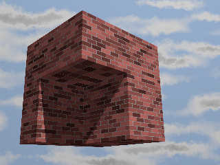

I just spent four days probably 're-inventing the wheel'; but  I wanted to
investigate the behavior of the brick pattern, when using warp{repeat...} with
an embedded cells pattern.
The recent posts about making bricks and wood planking got me to thinking about
this. As-is, the brick pattern's brick color is all the same (i.e., the same
color is repeated brick after brick.)  By using the cells pattern in it, and a
warp{repeat..} statement, random-colored bricks can be made. But the idea can be
applied to other pigments/textures, like wood. And normals.
I'm not totally sure what warp{repeat} does to an already-random cells pattern,
but the result looks satisfactory. The nice thing is, the brick's 'mortar' color
(or user-imposed pattern for that) is NOT repeated, but is 'global/continuous',
thanks to the brick pattern's own underlying code.
As an experiment, I animated part of the warp 'repeat' direction...
                warp{repeat y offset <frame_number + .5, 0 .5>}
.... to get a clue to its visual behavior, at least on the x/y plane. The bottom
row of bricks does NOT change; the 2nd row in y moves 'one brick' to the left
per frame_number; the 3rd row moves two bricks to the left, the fourth row moves
three bricks; and so on. This is probably expected behavior; but to try and
eliminate such an obvious 'repeat' pattern, I used...
    warp{repeat y offset <400 + .5,0,400 + .5>  // try <.5,0,.5> instead
         along with...
                translate -200*y (slightly more/less)
I *think* that the large repeat-y offsets will choose each new 'brick cell'
after skipping 400 units in x and z, rather than just using the next natural
cell along those axes.  But it may not be necessary anyway because the cells
pattern is already random! The added translation is simply to push the lower
brick rows-- with their obvious 'small' repeat movements-- way down into space,
and to instead use the cells pattern where each new brick row (starting at y=0)
shifts by at least 200 units to the left, compared to its lower neighbor. Again,
probably unnecessary.
Try applying the code to the distant z-plane first, to see its random
appearance.
Download 'multicolored_bricks_1.jpg' (1101 KB)
Preview of image 'multicolored_bricks_1.jpg'

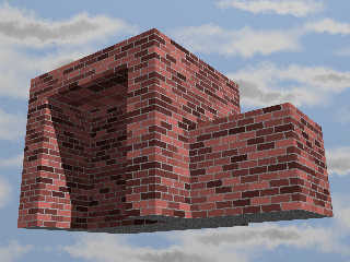

*This* code is what took so long to come up with: re-inventing the brick pattern
from scratch.
After a LOT of trial and error, I finally came up with something that uses
gradient patterns instead (x,y and z), embedding a 'cells' pattern into this,
then using some warp{repeat...} statements. It was an interesting experiment, if
nothing more.
There's a subtle quirk in this code that I haven't figured out yet, having to do
with the 'mortar' thickness (only when the brick y-dimension exceeds the
x-dimension.) Basically, there's a dynamically-changing 'limit' involved as to
the mortar thickness, based on the brick x/y ratio. Otherwise, it works OK.
Also, the mortar pattern is 'discontinuous' -- it is 'offset' in odd ways
because of the warp repeats . But it nevertheless remains scaled correctly in
all axes.

From: Bald Eagle
Subject: Re: random-colored BRICKS
Date: 17 Apr 2018 15:20:00
Message: <web.5ad6484995b142bdc437ac910@news.povray.org>
Pffff....   my brain is fried today.
It'll probably take me 4 days to see what you did there...   :D
It's very good work - something that's much needed in scenes.
It reminds me a bit of some code that TdG suggested a while back:
http://news.povray.org/povray.advanced-users/thread/%3Cweb.5789343436e895bcb488d9aa0@news.povray.org%3E/
Maybe you'll find some additional inspiration there.
I think if you add some normals to the bricks, and maybe a bit of color
variation on the bricks themselves, then you've got yourself a really fine brick
wall there!
Have you tried it with cinder block size / pigments?
Glad to see you've been busy with projects and succeeding!  :)
Tangential musing:
I would still have to ponder how to get some randomization to the bricks, and
add unevenness to the mortar - with drips and splotches of splashed mortar on
the bricks.
Just off the top of my head, I'm thinking that maybe the edges of the bricks
could be given a transparent color, with a wee bit of turbulence.  And the brick
texture could have a very sparse foreign color added - like magenta - and then
and eval_pigment macro could place blobs of mortar after the brick wall is
constructed....
Not sure if any of that is possible with the way you're doing it, or if that
would take a totally different approach.
> appearance.
Oops, I forgot to include the first code!
#version 3.71;
global_settings {assumed_gamma 1.0}
camera {
  perspective
  location  <0, 0, -7>
  look_at   <.55, 0.3,  0>
  right     x*image_width/image_height
  angle 46
light_source {
  0*x
  color rgb .9
  translate <20, 50, -10>
// background
plane{z,60
no_shadow
  pigment{bozo
          scale 3*<4,1,1>
          color_map{
                  [.2 rgb .6]
                  [.3 rgb .8]
                  [.35 rgb 1]
                  [.40 rgb 1]
                  [.58 rgb <.5,.7,1>]
                  scale .5
                  warp{turbulence .3 omega .7}
                  scale 1/.5
//plane{z,0
// OR...
union{
difference{
box{0,<9.52,9.66,10.48>}
box{<-.1,-.1,-.16>,<3.84,7.94,6.64> translate 2*z}          }
box{0,<5,4.98,6> translate <2.9,0,-5.7>}
    texture{
    pigment{brick
        pigment{ // the MORTAR
        bumps scale .3 color_map{[0 rgb 0][1 rgb 1]}}
        pigment{cells // the BRICKS
           color_map{
           blend_mode 2
           blend_gamma 2.2
           [0 rgb .1*<1,.28,.24>]
           [1 rgb .85*<1,.28,.24>]
           warp{repeat y offset <400.5,0,400.5>}
           translate .5*z
           scale <8,3,8> // needs to be the same as brick_size
           brick_size <8,3,8> // the default brick-size is <8,3,4.5>
           mortar .5 // can take only a single float value,
           // not a 3-value vector. (.5 is the default.)
           scale .12 // FINAL scale
           translate -196.9*y
           translate -.0001*y
           finish{ambient .1 diffuse .9}
    translate -5
    rotate -50*y
    rotate 15*x
    translate 20*z

From: Kenneth
Date: 19 Apr 2018 11:45:01
Message: <web.5ad8b8e895b142bda47873e10@news.povray.org>
Five or six days now, I've lost count!
I went back to POV-Ray's own 'brick' pattern, and worked it all out with full
textures and normals this time. The process has been an experimentatl one,
changing one value after another to see what happens. But the code looks stable
now.

#version 3.71;
camera {
  perspective
  location  <0, 0, -7>
  look_at   <0, 0,  0>
  angle 46 // 46
light_source {
  0*x
  color rgb 1.0
// background
plane{z,60
no_shadow
  pigment{bozo
          scale 3*<4,1,1>
          color_map{
                  [.2 rgb .6]
                  [.3 rgb .8]
                  [.35 rgb 1]
                  [.40 rgb 1]
                  [.58 rgb <.5,.7,1>]
                  scale .5
                  scale 1/.5
#declare BR_RATIO = <4,2,4>; // the brick dimensions (just a ratio, not
// really a scaler.) For matching SIDE walls, z needs to equal x--
// a 'square brick'.
#declare MORTAR_THICKNESS = .12; // this is in a different 'scale' than
// POV-Ray's own brick pattern. Here, it's 0.0 to 1.0
// This is get BR_RATIO.y to always be 1.0, for technical reasons that are
// hard to explain ;-)
#declare XYZ =
       <BR_RATIO.x/BR_RATIO.y,
             BR_RATIO.y/BR_RATIO.y,
                  BR_RATIO.z/BR_RATIO.y>;
box{0,9.75
    texture{
       brick
       texture{  // the MORTAR
           pigment{rgb .4} //bumps scale .04 translate 100}
           normal{bumps scale .09 bump_size .7
       texture{ // the BRICKS
           pigment{
                average
                pigment_map{
                [1
                cells
                pigment_map{
                  blend_mode 2
                  blend_gamma 2.2
                [.5 bumps scale .08*<1/XYZ.x,1/1,1/XYZ.z>
                  color_map{
                  blend_mode 3
                  blend_gamma 2.2
                            [.5 rgb .3]
                            [.5 rgb .3*<1,.28,.24>]
           warp{repeat y offset <1000.5,0,999.5>}
           translate .5*z
           scale <XYZ.x,1,XYZ.z>
                  } // end of this pigment
           normal{
           average
           normal_map{
       [1.0 quilted scale 1 bump_size 5] // This pattern doesn't
// need the warp{repeat...} below, which affects it an odd and subtle way;
// note the darker brick 'shadows' in every alternate row of bricks in y.
       [0.4 crackle scale .6*<1/XYZ.x,1/1,1/XYZ.z>  bump_size 5]
       [0.3 crackle scale .2*<1/XYZ.x,1/1,1/XYZ.z> bump_size 3 translate 50*x]
           warp{repeat y offset <1000.5,0,1000.5>}
           translate .5*z
              } // end of this texture
        // still part of the overall 'brick' TEXTURE
        brick_size <XYZ.x,1,XYZ.z>
        mortar MORTAR_THICKNESS
        scale 1 // FINAL scale
        // play with this!
        scale 6
        warp{turbulence .35 omega .6}
        scale 1/6
        translate <-.09,-.09,-.09> // because of warp{turbulence} effects
      } // end of overall texture
    translate -5
    rotate 30*y
    rotate 15*x
    translate 20*z
Download 'temp 6.jpg' (775 KB)
