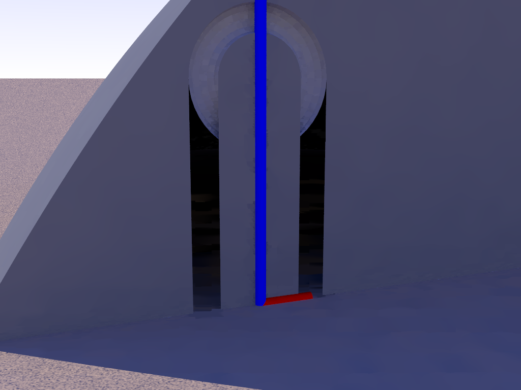

Hi, I have heard that POV_Ray can add mesh(solid) to CSG so I tried to
difference a torus mesh export from Blender but it seems not ok.
Download 'scene difference.png' (226 KB)
Preview of image 'scene difference.png'

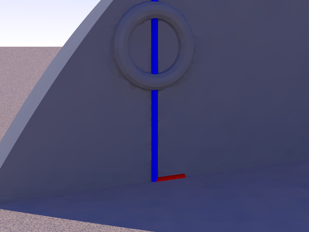

Why?
here is a union version. It's ok.
Download 'scene union.png' (222 KB)
Preview of image 'scene union.png'

I create it in Blender. A new torus, then export an .obj, then using poseray to
put into POV-Ray. That's all. I don't know what mistake I did.
From: clipka
Subject: Re: Ha...help
Date: 4 Aug 2016 12:40:28
Message: <57a36ffc$1@news.povray.org>
Am 04.08.2016 um 17:44 schrieb And:
> Why?
Union is special among the CSG operations in that it works fine with
non-solid objects. All other CSG operations need solid objects to work
properly.
To POV-Ray, "solid" means that there is a method to test whether any
given point is inside or outside a shape. The normal ray tracing
algorithm does not need such a test, since the only thing it cares about
is surfaces. Likewise, unions do not need such a test, since they do not
change what surfaces are rendered. Merge, difference, intersection and
clipped_by, on the other hand, work by selectively suppressing portions
of an object's surface depending on which other objects they're inside
-- and that's where the insideness test is crucial.
For meshes, the insideness test is implemented by tracing a ray from the
point in question in an arbitrary direction, and counting how many times
that ray intersects the object's surface. An odd number of intersections
indicates that the point in question is inside, while an even number
indicates that it is outside. For this algorithm to work properly, two
conditions must be met:
- The mesh must be properly closed (i.e. each and every triangle must
precisely share each of its edges with an odd number of other triangles).
- The "arbitrary direction" needs to be chosen. This is not done
automatically, but instead requires the use of the `inside_vector`
keyword, with a non-zero vector. (The actual direction does not normally
matter; however, if the vector happens to be almost but not quite
parallel to one of the triangles, there is a slight chance that
artifacts may occur, especially if that triangle is particularly large.)

No, you just need to edit your mesh file and add
inside_vector <0, 0, 0> (or another vector) to your mesh definition.
http://www.povray.org/documentation/view/3.6.0/292/

<0,0,0> is the only 100% BAD value.
Remember inside_vector is not a position, it's a direction.

It can't be a null vector and <0,0,0> IS a null vector.
It should be inside_vector<1,1,1>
If you get artifacts, change one of the values by a small amount and try
again.
