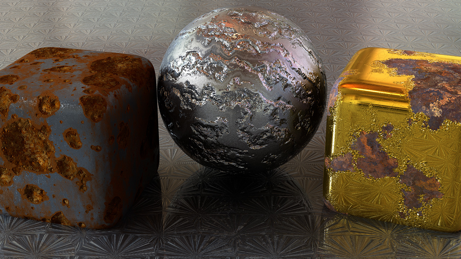

Hi,
Some years before I've read some critics about Povray not being able to render
many materials in a realistic manner.
Some commented "whatever I see, everything looks like plastic" - e.g.
http://blenderartists.org/forum/showthread.php?24365-What-is-special-about-PovRay).
I looked at many images generated with povray (IRTC, newsgroups etc.), and yes,
many images proved this prejudice true.
But there were also exceptions from povers like Lightbeam, Jaime Vives Piqueres,
Sean Day, Samuel T. Benge, Tek, Zeger Knaepen and others.
My materials project started with this in mind and is nearing now the end (ca.
2000 collected materials).
Here I want to show some results regarding four different metals.
Source will be uploaded to binaries.scene-files.
Norbert Kern

From: Mike Horvath
Subject: Re: some metal materials
Date: 9 Jan 2016 18:26:35
Message: <5691972b$1@news.povray.org>
On 1/9/2016 11:26 AM, Norbert Kern wrote:
> Hi,
> Norbert Kern
Wow, great use of normals! I didn't notice they weren't isosurfaces
until a few minutes.
Mike
From: clipka
Date: 9 Jan 2016 19:00:23
Message: <56919f17@news.povray.org>
Am 10.01.2016 um 00:26 schrieb Mike Horvath:
NOW that you mentioned it is the first time I even /thought/ about the
possibility that the rust defects might just be texture effects.
From: Paolo Gibellini
Date: 11 Jan 2016 05:22:22
Message: <5693825e$1@news.povray.org>
Norbert Kern wrote on 09/01/2016 17.26:
> Hi,
> Norbert Kern
Very nice textures and somehow extreme.
Paolo
From: Norbert Kern
Date: 13 Jan 2016 15:25:01
Message: <web.5696b18045ebf73cfbc5a6a80@news.povray.org>
> Mike
Yeah, the normals do a good job for the sphere and the left superellipsoide.
Normally only small parts of a (technical) structure show rust or other defects.
So imho you don't need isosurfaces all the time, since normals render much
faster.
Norbert

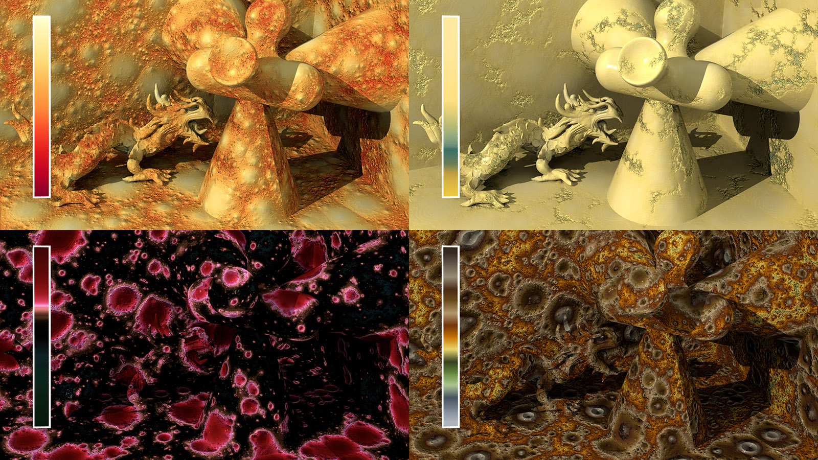

From: Norbert Kern
Date: 13 Jan 2016 18:30:01
Message: <web.5696dd9c45ebf73cfbc5a6a80@news.povray.org>
Sometimes normals are great and even seem to simulate shadows, sometimes not...
At several occasions I recognized how a accuracy value as low as 0.001 helped to
enhance realism.
But if the left rust texture looks fine, its mostly due to Tek's pores code.
The image below shows it's great versatility - code was used together with
different color_maps as well as a pigment and via pigment_pattern as a normal.
Norbert
Download 'teks pores code versatitility.jpg' (610 KB)
Preview of image 'teks pores code versatitility.jpg'
From: Norbert Kern
Date: 13 Jan 2016 18:45:01
Message: <web.5696e08e45ebf73cfbc5a6a80@news.povray.org>
> Paolo
Thank you, Paolo!
You are right, these materials are a bit extreme. It's because good metal
textures are really easy - a diffuse value near zero together with high
non-variable reflectivity in combination with hdr-lighting - ready!.
So the normals make the difference...
Norbert
From: Lightbeam
Date: 28 Apr 2016 09:15:00
Message: <web.57220c9c45ebf73c16e47aed0@news.povray.org>
Good work, the sphere remind me one of my old images...
http://news.povray.org/povray.binaries.images/thread/%3C4013fcf5@news.povray.org%3E
And thank you, it's nice to have been named in your original post , I 'm
flattered :-)
