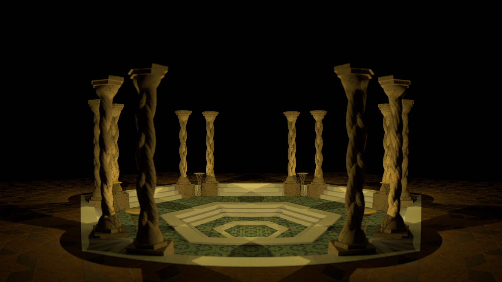

Operating on the theory that my csg was slowing down the render, I decided to
rebuild the scene from the void up using constructive csg as much as possible.
What follows is the current state of the scene, built almost entirely out of
prisms.  The code is quite a bit less readable, but there are no difference(s)
at all.
The major speedup came when I changed the way I tiled the floors.  Rather than
making a single large union of all the tiles on a particular level, I altered my
macro to pass back an array of tiles which I then use to tile a given area. I
cull tiles which fall inside areas I want kept clear using an inside(...)
statement.  Render speed increased to "OH MY GOD THAT'S FAST".
Render Time:
  Photon Time:      No photons
  Radiosity Time:   0 hours  0 minutes 17 seconds (17.107 seconds)
              using 6 thread(s) with 95.544 CPU-seconds total
  Trace Time:       0 hours  4 minutes 26 seconds (266.060 seconds)
              using 6 thread(s) with 1535.187 CPU-seconds total
The upshot seems to be a problem in bounding of difference objects where the
base is composed of many small objects, much like you might expect from turning
off split_unions.
A.D.B.
Download 'rebuild.png' (565 KB)
Preview of image 'rebuild.png'

Yes, modeling a scene differently can have a *huge* impact on the render
time :)
Another thing that can be done:
When your tiles, or any kind of objects, are hiden under some other
opaque object and you see them in some hole in that object, you don't
need to use a difference nor intersection to cut them away. Makes the
scene simpler.

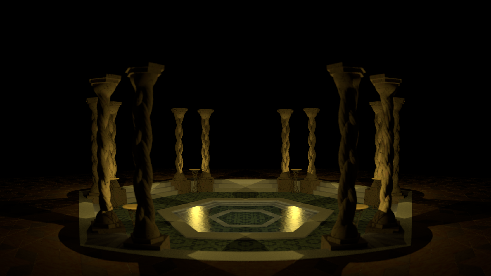

From: Anthony D  Baye
Subject: Re: Seraglio (Teardown 2)
Date: 14 Sep 2015 09:20:01
Message: <web.55f6c93f5da2bcf92aaea5cb0@news.povray.org>
And everything but the water...
Render Time:
  Radiosity Time:   0 hours 27 minutes  9 seconds (1629.585 seconds)
              using 48 thread(s) with 9335.010 CPU-seconds total
  Trace Time:       3 hours  2 minutes 41 seconds (10961.487 seconds)
              using 48 thread(s) with 63746.286 CPU-seconds total
A.D.B.
Download 'rebuild.png' (836 KB)

And here's with the water.  Such as it is.
I felt that the light was a little too bright so I cut the fade distance in
half.  Might take it down even further.
Render Time:
  Radiosity Time:   0 hours 27 minutes 27 seconds (1647.759 seconds)
              using 48 thread(s) with 9805.663 CPU-seconds total
  Trace Time:       2 hours 29 minutes 33 seconds (8973.296 seconds)
              using 48 thread(s) with 53585.490 CPU-seconds total
A.D.B.
Download 'rebuild.png' (701 KB)
From: clipka
Date: 18 Sep 2015 11:07:16
Message: <55fc28a4@news.povray.org>
Am 16.09.2015 um 23:44 schrieb Anthony D. Baye:
Hint: If striving for realism, avoid random tweaking of fade_distance;
if you feel that the light is too dim or too bright, always directly
tweak the light source's brightness instead - even if that means using
apparently insane brightness values to achieve the desired result.
Unless using an area_light with area_illumination on, fade_distance
should typically be roughly equal to the hypothetical radius of whatever
light source you are trying to simulate. So for instance, to simulate a
classic frosted E27 incandescent light bulb, and presuming you're using
a scale of 1m per POV-Ray unit for your scene, a fade_distance of 0.03
would be about the right value.
