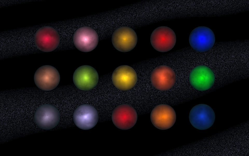

Nested, mostly transparent spheres - cylindrical pattern oriented toward camera
- where reflection is coloured and conserve energy is off. Reflection is of a
gray bozo pattern, here via no-image spheres just around the visible spheres.
The look of these I like, but I have found it impossible, so far, to use this
technique as part of a larger scene without artefacts. I am after antique,
frosted Christmas lights like I remember my grandmother having a few of on her
tree when I was a kid.
Download 'bulbtest.jpg' (112 KB)
Preview of image 'bulbtest.jpg'

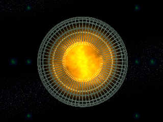

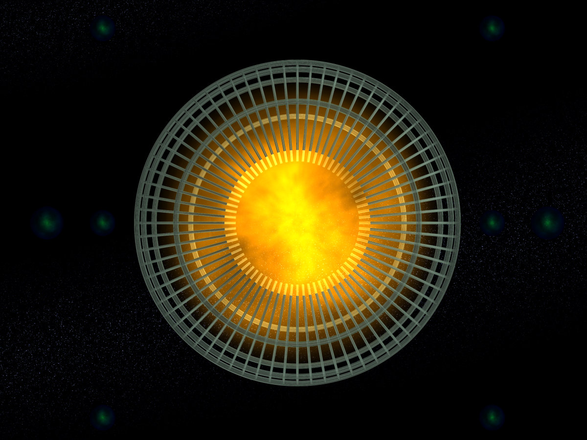

The attached image instead reflects a bozo pattern from a sky sphere (why this
works and inside texture did not, I do not know). I put a bit of a cage around
this one, but all the shapes in the cage cannot cast shadows or again the
illusion breaks down. The lack of shadows itself causes the illusion to break
down.

Download 'fireincage.jpg' (207 KB)
Preview of image 'fireincage.jpg'

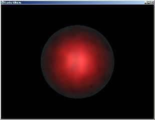

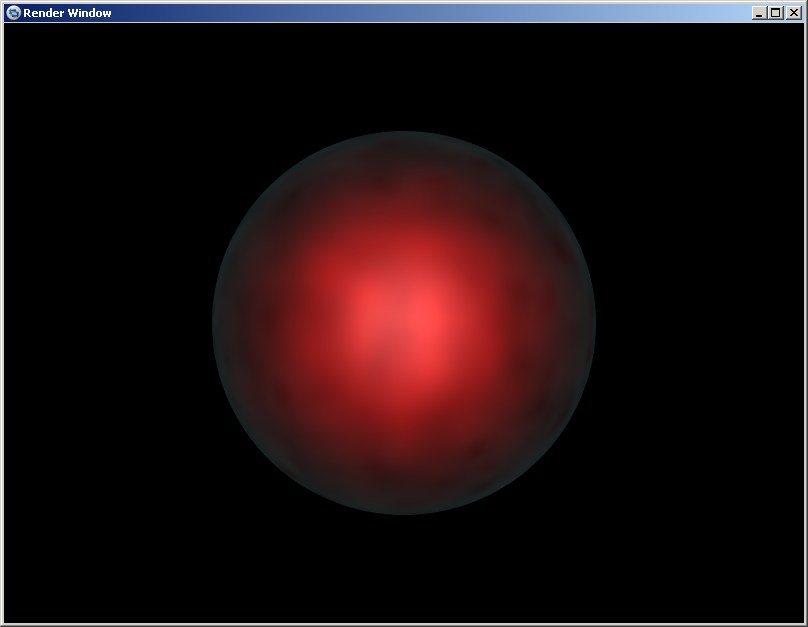

Oh, that sounds very complicated. I'm not sure whether I've understood it
completely. I once had made an earth globe with a frosted rim like appearance. I
have adapted the code a bit, so that it might look a little like the frosted
bauble you are looking for. But maybe the bozo texture thing is not quite what
you were looking for? Because there's not much bozo in the middle of the sphere.
However, you only need one sphere, at least and not an additional outer one in
this case.
Simone

Download 'bauble_test.jpg' (23 KB)
Preview of image 'bauble_test.jpg'

I have been known to make things more complicated than they need to be... :-)
The look of your light bulb would be fine for the Holiday image I have in mind.
I'll give the technique a go in addition to trying some of the ideas suggested
by Mr Lipka. Hopefully something works out in the larger image. Thanks to both
of you!
Best regards, Bill

> Simone
> camera {
>   location  <0.0, -1, -23.5>
>   look_at   <0.0, 0.0,  0.0>
>   right x*image_width/image_height
>   angle 30
> light_source {       <0, 0, 3.5>  color rgb <-.15 ,1, 1>*55  shadowless  } //
> light behind sphere for frosted rim
> light_source {   /// light inside sphere
>   0*x
>   color rgb <4,1,1>*2
>   translate <0, 0, 0>
> light_source {       /// normal light (works without too)
>   0*x
>   color rgb <1,1,1>*.5
>   translate <0, 0, -20>
> sphere
> <0, 0, 0>
> 3.0
>   texture { pigment {  color rgbt <.25,.01,0.01,.3> }    }
>    texture {
>       pigment {
>         bozo
>         color_map {
>           [0.0 color rgbt <.0, .0, .0, .67> ]
>           [1 color rgbt <.2, .2, .2, 1> ]
>         scale .6
> finish {  phong .3 phong_size 5   ambient .4}
> hollow on
Why the hollow on?
You don't use any media. hollow's one and only use/purpose is to enable
an object to contain a media or be filled with fog. Nothing else!
