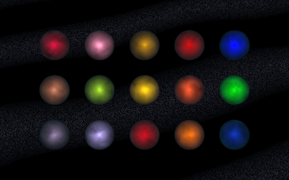

From: William Pokorny
Subject: Coloured bulbs
Date: 12 Oct 2009 14:45:01
Message: <web.4ad3766465e6ee05a43ab4450@news.povray.org>
Nested, mostly transparent spheres - cylindrical pattern oriented toward camera
- where reflection is coloured and conserve energy is off. Reflection is of a
gray bozo pattern, here via no-image spheres just around the visible spheres.
The look of these I like, but I have found it impossible, so far, to use this
technique as part of a larger scene without artefacts. I am after antique,
frosted Christmas lights like I remember my grandmother having a few of on her
tree when I was a kid.
Download 'bulbtest.jpg' (112 KB)
Preview of image 'bulbtest.jpg'
From: Carlo C
Subject: Re: Coloured bulbs
Date: 13 Oct 2009 04:30:00
Message: <web.4ad439bb489965a7fef1da640@news.povray.org>
However they are nice.
And with a bit of turbulence can become nebulae...

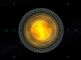

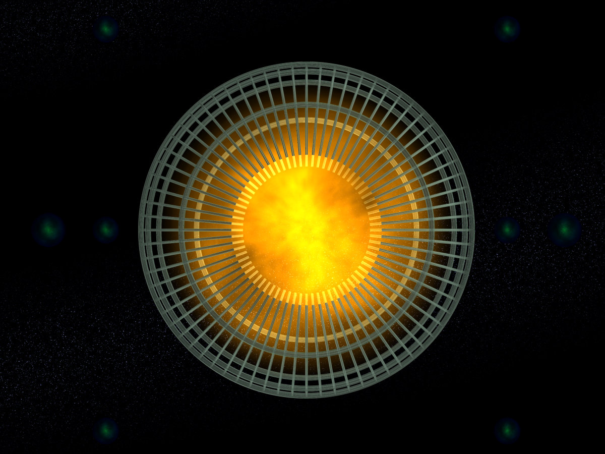

Date: 13 Oct 2009 22:50:00
Message: <web.4ad53a87489965a7a43ab4450@news.povray.org>
Hi Simone,
Thank you for the suggestion and in one instance I did try and increase that
setting.
Artefacts is probably not the best term - limitations might be better. For
example, in the coloured bulbs image I put an individual, randomised, bozo
sphere around each so the colour pattern reflected would be different. I started
with the idea of putting the texture on the inside of a hollow sphere, but could
not get the reflection-amplification effect to work at all that way. Eventually
I got there with a transmit filter on the outside of the sphere using
no_reflection, no_shadow for those spheres - but I could not use no_image
because then I lost the transmit filter.  Long winded way to say that when I try
to build a scene around these type of "bulbs," the edges of this outer sphere
show up and the illusion is broken.
The attached image instead reflects a bozo pattern from a sky sphere (why this
works and inside texture did not, I do not know). I put a bit of a cage around
this one, but all the shapes in the cage cannot cast shadows or again the
illusion breaks down. The lack of shadows itself causes the illusion to break
down.
Aside: The X-ray effect you are after is by the way similar to the way the
texture needs to be patterned on each sphere. An AOI pattern would make this
trick easier in that I would not have to reorient the spheres individually to
the camera position, but it wouldn't remove the limitations I am hitting. It
would, I think, make the effect complete for rays not coming directly from the
camera position if the AOI pattern would be in effect for all rays.
I am thinking now that I might have to create the texture I want and stick it on
the bulbs with ambient 1, but I have yet to try it. There is also media, but I
have struggled in the past to get the look I want with media for these kinds of
effects. And there is Mr Lipka's new "diffuse-backside illumination" feature in
beta 34 that might be useful here, but I am still on 33 with my linux compile.
Anyway, sorry for thinking aloud. Thanks again for the suggestion.
Regards, Bill

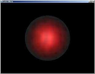

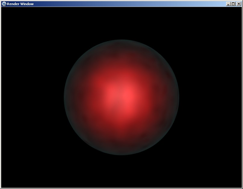

From: mone
Date: 16 Oct 2009 19:45:01
Message: <web.4ad90516489965a718ebfdf70@news.povray.org>
Oh, that sounds very complicated. I'm not sure whether I've understood it
completely. I once had made an earth globe with a frosted rim like appearance. I
have adapted the code a bit, so that it might look a little like the frosted
bauble you are looking for. But maybe the bozo texture thing is not quite what
you were looking for? Because there's not much bozo in the middle of the sphere.
However, you only need one sphere, at least and not an additional outer one in
this case.
Simone
camera {
  location  <0.0, -1, -23.5>
  look_at   <0.0, 0.0,  0.0>
  right x*image_width/image_height
  angle 30
light_source {       <0, 0, 3.5>  color rgb <-.15 ,1, 1>*55  shadowless  } //
light behind sphere for frosted rim
light_source {   /// light inside sphere
  0*x
  color rgb <4,1,1>*2
  translate <0, 0, 0>
light_source {       /// normal light (works without too)
  0*x
  color rgb <1,1,1>*.5
  translate <0, 0, -20>
sphere
<0, 0, 0>
3.0
  texture { pigment {  color rgbt <.25,.01,0.01,.3> }    }
   texture {
      pigment {
        bozo
        color_map {
          [0.0 color rgbt <.0, .0, .0, .67> ]
          [1 color rgbt <.2, .2, .2, 1> ]
        scale .6
finish {  phong .3 phong_size 5   ambient .4}
hollow on
Download 'bauble_test.jpg' (23 KB)
Preview of image 'bauble_test.jpg'
Date: 17 Oct 2009 15:00:01
Message: <web.4ada132a489965a7331f34c90@news.povray.org>
I have been known to make things more complicated than they need to be... :-)
The look of your light bulb would be fine for the Holiday image I have in mind.
I'll give the technique a go in addition to trying some of the ideas suggested
by Mr Lipka. Hopefully something works out in the larger image. Thanks to both
of you!
Best regards, Bill

> Simone
> camera {
>   angle 30
>   0*x
>   color rgb <4,1,1>*2
>   translate <0, 0, 0>
>   0*x
> sphere
> <0, 0, 0>
> 3.0
>    texture {
>       pigment {
>         bozo
>         color_map {
>         scale .6
> hollow on
Why the hollow on?
You don't use any media. hollow's one and only use/purpose is to enable
an object to contain a media or be filled with fog. Nothing else!
