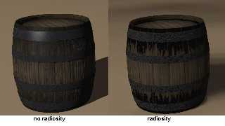

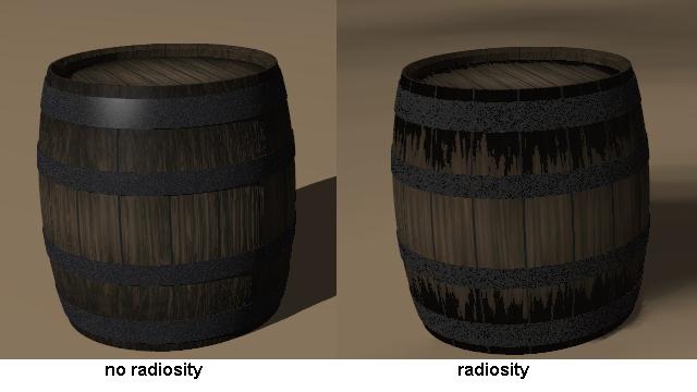

Hello friends.
When I first rendered my povlab scene with radiosity, I noticed the dirt
layers of textures (fire place, casks) are not very well rendered: it has a
binary (all/nothing) aspect. In the code, the dirt layers are progressive,
and when rendered without radiosity it is OK, but when rendered with
radiosity, they are not OK for the objects-indirect lighting (but seems OK
for light_sources).
Is it a normal radiosity side effect?
In order to illustrate, here is the cask used in my scene without and with
radiosity. I also just noticed that specularity does not show. In the
radiosity version I replaced the light_source by a sphere with an ambient
of 100 and set the count parameter to 1000 in order to avoid too much
splotchiness.
    Bruno
Download 'cask_radio_pb.jpg' (24 KB)
Preview of image 'cask_radio_pb.jpg'

Is your dirt a layered texture? I think there's a separate max_trace_level
setting in the radiosity block which would need to be the same as the
global one. I haven't tried this, though, so I could be wrong...
This would also explain why transparent objects seem to block radiosity
for some people (there was a post to this effect recently).
Specular and phong highlights are calculated from light sources alone, I
think. If you removed the light sources and lit the scene using only
radiosity then this is to be expected.
I did notice the granularity in your original image, but I wasn't sure if it
was the desired effect or not!
Bill

Hi Bill!
The texture of the cask is quite complex: inside/outside with several layers
(base wood (when brand new) + 'wheathering' (old aspect) + dirt). The dirty
outside texture is:
// Base wood pigment (brand new cask)
#declare P_CaskBodyBase =  pigment
    P_WoodGrain14A
    color_map {M_Wood7A}
    rotate 90*x
    scale <0.2, 1, 0.2>
// Base texture for outsides
#declare T_CaskBodyBaseOut = texture
    pigment {P_CaskBodyBase}
    normal {granite 1 scale <0.04,1,0.04>*4} // Some relief in the wood
texture // Wheathering texture
    pigment
        granite
        color_map
            [0 color 0.3*ForestGreen transmit 0.1]
            [0.3 color 0.4*DarkWood transmit 0.2]
            [0.7 color 0.7*DarkWood transmit 0.3]
            [1 transmit 0.8]
    finish {specular 0.2 roughness 0.04 } // Somewhat polished by
manipulations
// Dirt layer at both ends
#declare T_CaskBodyDirt = texture
    pigment
        gradient y
        scale -2*CASK_LOW_THRESHOLD // Cask = differenced elongated spheres,
intersected with 2 planes
        translate -CASK_LOW_THRESHOLD*y
        turbulence 0.1 omega 0.65 octaves 8
        scale 1.1*<0.15,1,0.15>
        color_map
            [0   transmit 0.05]
            [0.2 transmit 0.1]
            [0.5 transmit 0.3]
            [0.8 transmit 0.1]
            [1   transmit 0.05]
#declare T_CaskBodyBaseOutDirt =
  texture {T_CaskBodyBaseOut}
  texture {T_CaskBodyDirt}
The dirt layer in the first encountered by the rays (like in real life). I
read the documentation and I did not see a specific max_trace_level in the
radiosity section, but rather adc_bailout, which is closely related. I
tried to tweak this parameter from 1 to 1e-5), but the problem remains.
    Bruno
From: Bill Pragnell
Subject: Re: Radiosity and layers with transmit
Date: 6 Mar 2007 09:30:00
Message: <web.45ed79a6cf27660a731f01d10@news.povray.org>
Yes, despite some obscure Google references to max_trace_level in
radiosity{}, it appears that I am in fact talking out of my backside. There
is no such setting.
However, I conducted some experiments with an upturned glass bowl and
radiosity lighting. It would appear that both max_trace_level and
recursion_limit must be set high enough for the lighting to behave
correctly. Try adjusting the latter upwards...
Bill
