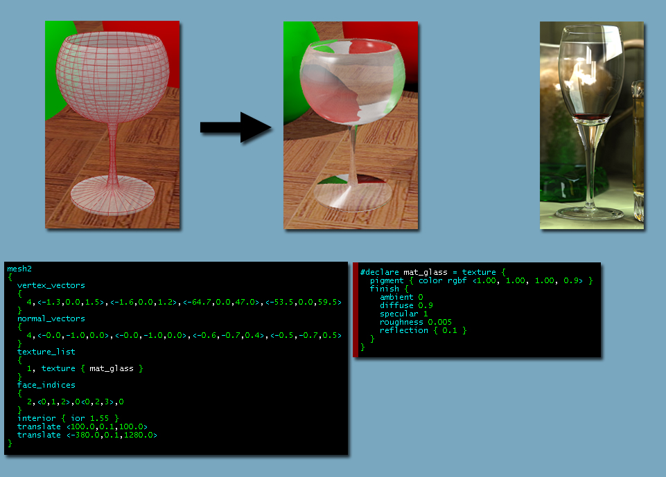

Hi,
I have a problem when I render a glass material. I set up the "pigment" and
"finish" sections with typical values for glass (see values in attached
image).
My object is a "union" of "mesh2" with polygons of 4 vectors each one, see
image for code sample of one of these "mesh2". I prefeer not to use
photons.
Any suggestions?
Thks,
JSR.
Download 'glass.jpg' (330 KB)
Preview of image 'glass.jpg'

Do your glass walls have 2 surfaces each? When dealing with refraction, a
ray passes through a surface and with an ior and assumes itself to be
'inside' that material until it passes through another surface, therefore
glass or transparent objects need to have an actual thickness to appear
properly.   The refraction distortion on your glass appears as if this is
the case.  Where it passes through the 2 sides of the glass (i.e., the
bottom part of the bowl) it seems to be solid glass.
-tgq

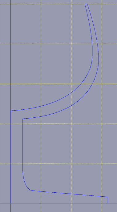

My object is a surface of revolution made of 'mesh2'. I also think that the
problem is in the refraction distortion, but I don't know what is the
correct ior for my object. The value 1.55 is the real value for glass, but
the result in my image is bad. Other values for ior has worse results. I
tried with the parameter 'double_illuminate', but the result is the same.
I also tried with T_Glass2, but no improvements get.
Thanks,
JSR.

From: Trevor G Quayle
Subject: Re: Glass problem
Date: 16 Nov 2006 08:30:00
Message: <web.455c67c869412694c150d4c10@news.povray.org>
> > -tgq
> Hi,
> Thanks,
> JSR.
Yes, it does look like a proper closed mesh object.  Perhaps posting the
full code would help in determining what's going wrong.  Without seeing the
full code it's hard to track down as everything appears correct (ior 1.55
should be fine).
-tgq
From: Gilles Tran
Date: 16 Nov 2006 09:55:00
Message: <455c7bc4$1@news.povray.org>
web.455c5ac069412694d8ef73430@news.povray.org...
Note that the full code for the glass scene you took as an example is
available here (I guess it's only linked from Wikipedia for now):
http://www.oyonale.com/ressources/downloads/gt_glass_wikipedia.zip
What makes the glass shine nicely is the very high ambient value from the
sky (cf scene code).
The relevant glass texture is the one below.
    #declare F_Glass=finish {
        ambient 0
        diffuse 0
        specular 0.8
        roughness 0.0003
        phong 1
        phong_size 400
        reflection {
            0.01, 1
            fresnel on
        conserve_energy
    #declare T_Glass =texture{
        pigment{rgbf<1,1, 1, 0.95>}
        finish {F_Glass}
    #declare I_Glass=interior{
        ior 1.51
        fade_distance 10
        fade_power 2

From: Gilles Tran
Date: 16 Nov 2006 11:34:34
Message: <455c931a@news.povray.org>
web.455c8bb169412694d8ef73430@news.povray.org...
> I found a difference in 'mesh' definition between my glass and your glass
> and I think that the problem could be there. But, where?  :)
Actually your object is strange: the glass is a union of many, small
4-vertices meshes... It probably doesn't behave as would a real mesh. Can
you export the object as a single mesh?
G.
From: JSR
Date: 16 Nov 2006 12:00:00
Message: <web.455c97ed69412694d8ef73430@news.povray.org>
> G.
This will represent a hard work changing the source code of the application
I use. I work with a own program which works with OpenGL and translate the
polygons it receives into 'mesh2' objects. Maybe I have enough time to
change the code.
Thanks,
JSR.
