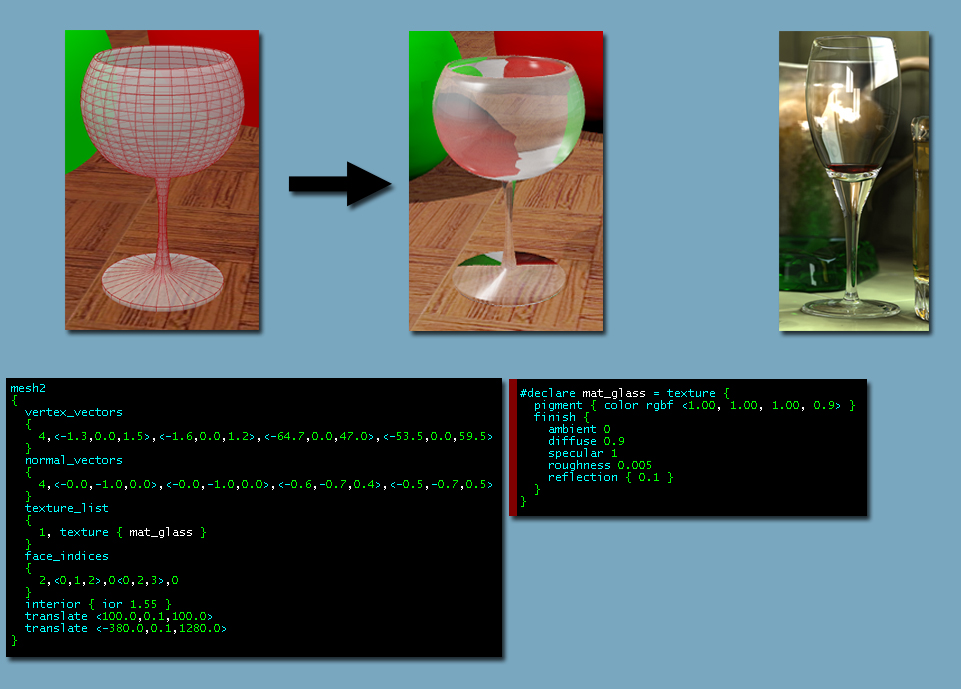

Hi,
I have a problem when I render a glass material. I set up the "pigment" and
"finish" sections with typical values for glass (see values in attached
image).
My object is a "union" of "mesh2" with polygons of 4 vectors each one, see
image for code sample of one of these "mesh2". I prefeer not to use
photons.
Any suggestions?
Thks,
JSR.
Download 'glass.jpg' (330 KB)
Preview of image 'glass.jpg'

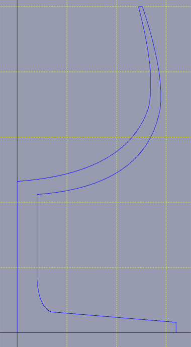

Hi,
My object is a surface of revolution made of 'mesh2'. I also think that the
problem is in the refraction distortion, but I don't know what is the
correct ior for my object. The value 1.55 is the real value for glass, but
the result in my image is bad. Other values for ior has worse results. I
tried with the parameter 'double_illuminate', but the result is the same.
I also tried with T_Glass2, but no improvements get.
Thanks,
JSR.

Yes, it does look like a proper closed mesh object.  Perhaps posting the
full code would help in determining what's going wrong.  Without seeing the
full code it's hard to track down as everything appears correct (ior 1.55
should be fine).
-tgq
> should be fine).
> -tgq
Ok,
I've posted the source code in the s.c. section.
Thks,
JSR
From: JSR
Subject: Re: Glass problem
Date: 16 Nov 2006 11:05:00

Hi,
First of all, I forgot to mention that the image I used as an example was
made by you. Sorry. I think that it's a beautiful image, as the rest of
your work.
I've tried to change 'pigment', 'finish' and 'interior' with these
parameters, but the result was very similar.
I think that the problem isn't in the glass shine, but in the refraction or
reflection.
I found a difference in 'mesh' definition between my glass and your glass
and I think that the problem could be there. But, where?  :)
Thanks,
JSR.
Actually your object is strange: the glass is a union of many, small
4-vertices meshes... It probably doesn't behave as would a real mesh. Can
you export the object as a single mesh?
G.
