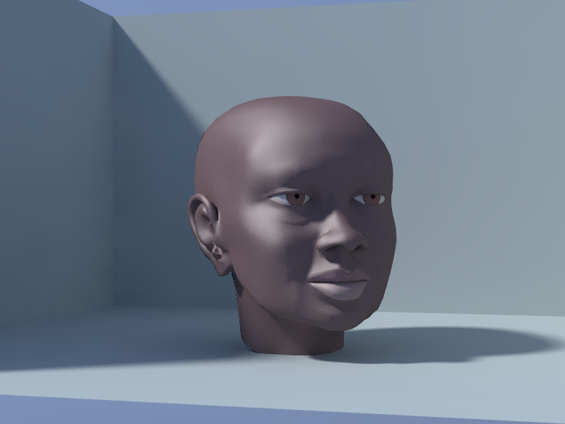

After a couple of false starts, I have made my first decent head model in
Wings3d. Now I want to give it a good but simple texture. I have had
difficulty especially with the eyes. Right now they are modelled as one
piece, with a "bump" for the iris and lens and a hole for the pupil. I
think I will have to model a lens, is this what is usually done? I'm not
looking for photorealism, just sort of real-ish from 20 feet or something
Will I have to resort to making a uv-map for the different flesh tones? Is
there a place I can find some to look at? I don't know how to remove
shadows from an image to get the diffuse pigment from a face.
I'm also at a loss on the "whites" of the eyes. They either look glowing or
plastic when I fiddle with the texture.
Also feedback about the modelling/proportions would be great.
If there's interest I can post the mesh for others to play around with, it
would be cc-attrib-share-alike.
-Stefan
Download 'headtest002.png' (172 KB)
Preview of image 'headtest002.png'
Try a semi-transparent surface (try a crackle pigment with a thin red band
at 0.0-0.05 or so in the colour map for the effect of blood vessels) with
some scattering media inside. Plus slight reflection & highlights to give
the impression of wetness.
For a realistic iris you'll want to layer some radial and spherical textures
with varying amounts of turbulence. Here's a good close up of an eye I
found: http://mysite.wanadoo-members.co.uk/journalspace/eye.jpg
I was trying to make a convincing looking eye recently (albeit one belonging
to a being from another dimension, however I was basing it on a human eye
just with very different colours). The iris was the particularly tricky
part. I didn't finish working on it since it didn't end up fitting into the
scene particularly well, but I'd like to use it elsewhere...

"Smws" <smw### [at] poboxcom> schreef in bericht
news:web.4522f21babe691b3da53d9e40@news.povray.org...
looking good! It's a difficult task.
As a rule of thumb, the eyes are approximately halfway between the chin and
the top of the head in human figures. Your model in that respect, should
have a slightly higher forehead. It looks a bit squashed now imo. Try it,
you will see the difference!

"Smws" <smw### [at] poboxcom> wrote in message
> or
> -Stefan
Hi Stefan,
Your model looks very good to me and I think the proportions are well within
the range of possible variants.
The eyes do look a bit off. The eyeball doesn't seem to be as reflective as
it should be. I think some phong would help a lot.
The pupils are very small, which doesn't correspond well with the face being
mostly in shadow.
If you don't need closeup shots you could try the POV-Ray CSG eyeball at:
http://www.telinco.co.uk/c_bartlett/povperson/head/index.htm
There are settings on the web page for dark brown eyes.
Chris B.

"Stephen" <mcavoys_AT_aolDOT.com> schreef in bericht
news:web.45236eefe4de19fdf1cb1e660@news.povray.org...
> I don't know, it looks very like a few people I saw while working in
> Nigeria. Not that I'm arguing with your rule. I think that the model looks
> very good.
Indeed. As said, it is a rule of thumb, for average heads (at least that's
what I learned in drawing classes), but there are slight variations around
that. Still, I believe it is very close to that rule.
We need the *ex cathedra* from a *real* artist or anthropologist :-)

Wow, if it comes close to resembling people you've seen I'm very glad.
> Smws
> You might want to try using an image map for the eyes. The poser sites
> probably have a few knocking around. I know somewhere on my home PC I have
> Stephen
Thanks for the hint. I have found some eye textures and I may end up doing
that- but I still want to fiddle around with procedural textures a little
more.
-Stefan

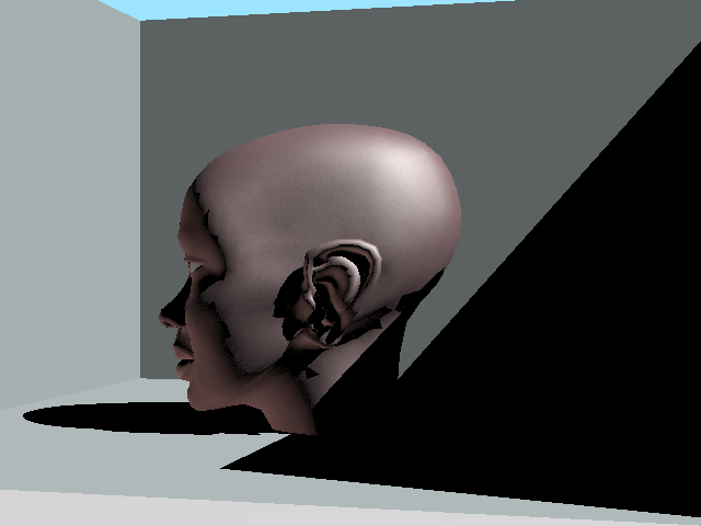

Yeah, other people have said that too. It looks a little strange to me too.
The thing is, when I modelled it I made sure to follow that guideline (it
was drilled into me in art class :))- here is a side view to show that the
eyes really are about halfway between the chin and the top of the head.
Perhaps I have the highest point too far back? Perhaps it's camera angle?
What do you think?
Download 'headtest003.png' (82 KB)
Preview of image 'headtest003.png'
It looks well within normal range, especially considering the tilt of the
head.  I find that the half-and-half rule holds when the head is positioned
such that the tops and bottoms of the ears are level with the eyebrows and
nostrils, respectively.
