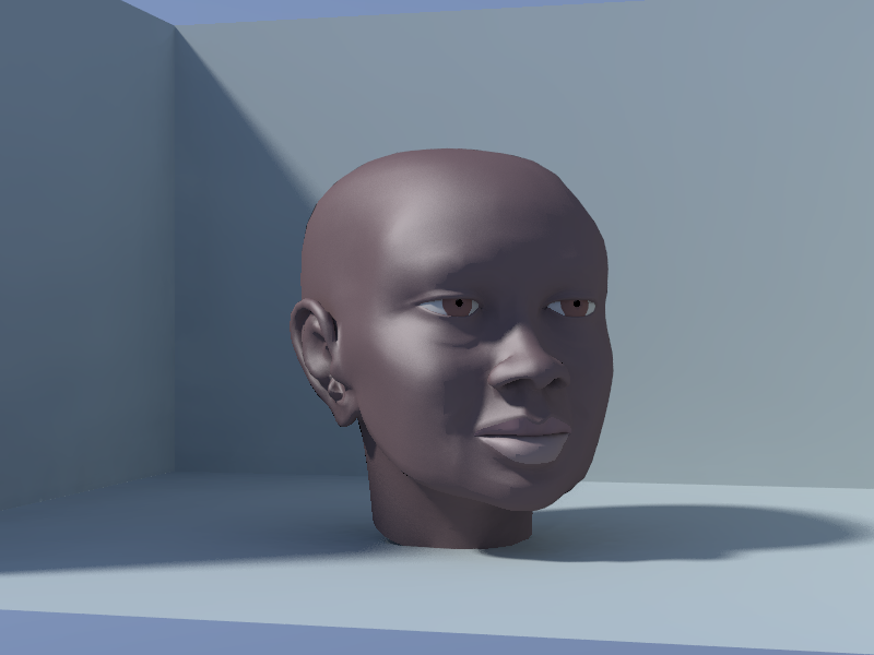

After a couple of false starts, I have made my first decent head model in
Wings3d. Now I want to give it a good but simple texture. I have had
difficulty especially with the eyes. Right now they are modelled as one
piece, with a "bump" for the iris and lens and a hole for the pupil. I
think I will have to model a lens, is this what is usually done? I'm not
looking for photorealism, just sort of real-ish from 20 feet or something
Will I have to resort to making a uv-map for the different flesh tones? Is
there a place I can find some to look at? I don't know how to remove
shadows from an image to get the diffuse pigment from a face.
I'm also at a loss on the "whites" of the eyes. They either look glowing or
plastic when I fiddle with the texture.
Also feedback about the modelling/proportions would be great.
If there's interest I can post the mesh for others to play around with, it
would be cc-attrib-share-alike.
-Stefan
Try a semi-transparent surface (try a crackle pigment with a thin red band
at 0.0-0.05 or so in the colour map for the effect of blood vessels) with
some scattering media inside. Plus slight reflection & highlights to give
the impression of wetness.
For a realistic iris you'll want to layer some radial and spherical textures
with varying amounts of turbulence. Here's a good close up of an eye I
found: http://mysite.wanadoo-members.co.uk/journalspace/eye.jpg
I was trying to make a convincing looking eye recently (albeit one belonging
to a being from another dimension, however I was basing it on a human eye
just with very different colours). The iris was the particularly tricky
part. I didn't finish working on it since it didn't end up fitting into the
scene particularly well, but I'd like to use it elsewhere...

"Smws" <smw### [at] poboxcom> schreef in bericht
news:web.4522f21babe691b3da53d9e40@news.povray.org...
looking good! It's a difficult task.
As a rule of thumb, the eyes are approximately halfway between the chin and
the top of the head in human figures. Your model in that respect, should
have a slightly higher forehead. It looks a bit squashed now imo. Try it,
you will see the difference!

"Smws" <smw### [at] poboxcom> wrote in message
> or
> -Stefan
Hi Stefan,
Your model looks very good to me and I think the proportions are well within
the range of possible variants.
The eyes do look a bit off. The eyeball doesn't seem to be as reflective as
it should be. I think some phong would help a lot.
The pupils are very small, which doesn't correspond well with the face being
mostly in shadow.
If you don't need closeup shots you could try the POV-Ray CSG eyeball at:
http://www.telinco.co.uk/c_bartlett/povperson/head/index.htm
There are settings on the web page for dark brown eyes.
Chris B.

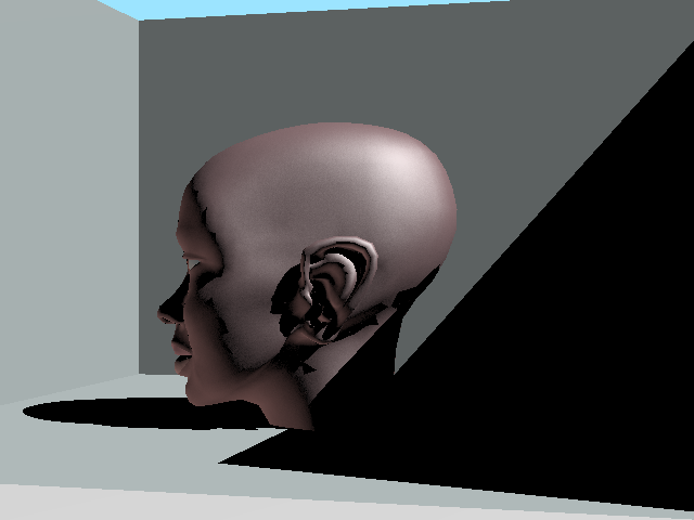

Yeah, other people have said that too. It looks a little strange to me too.
The thing is, when I modelled it I made sure to follow that guideline (it
was drilled into me in art class :))- here is a side view to show that the
eyes really are about halfway between the chin and the top of the head.
Perhaps I have the highest point too far back? Perhaps it's camera angle?
What do you think?

It looks well within normal range, especially considering the tilt of the
head.  I find that the half-and-half rule holds when the head is positioned
such that the tops and bottoms of the ears are level with the eyebrows and
nostrils, respectively.
