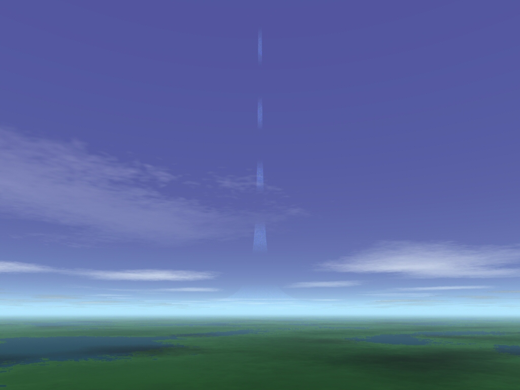

From: Bill Pragnell
Subject: Ringworld re-re-revisited
Date: 27 Oct 2005 04:45:01
Message: <web.4360929f30852916731f01d10@news.povray.org>
Just in case any of you were getting bored of ringworlds...
This is a substantial improvement on my previous effort. The ring is pretty
much the dimensions stated in the book (and elsewhere here) - 90 million
miles in radius (although it should be 95 I believe), with 20 shadow
squares orbiting 12 million miles from the sun. The sun is an area_light 1
million miles in diameter.
The atmospheric effects are of course the most difficult, and in this regard
I cheated somewhat - the haze is merely a ground fog, and the blue sky is a
semitransparent sky sphere about a million miles wide, i.e. between the
camera and the arch.
I think the landscape is of realistic dimensions, but sadly the clouds are
slightly exaggerated - they are 200 miles in the air, with the camera at an
altitude of 100 miles. The reason for this is that I couldn't place the
camera any lower without some kind of precision artifact creeping into the
lower half of the image (I'll post an example in a bit).
Download 'ringworld_1.jpg' (119 KB)
Preview of image 'ringworld_1.jpg'

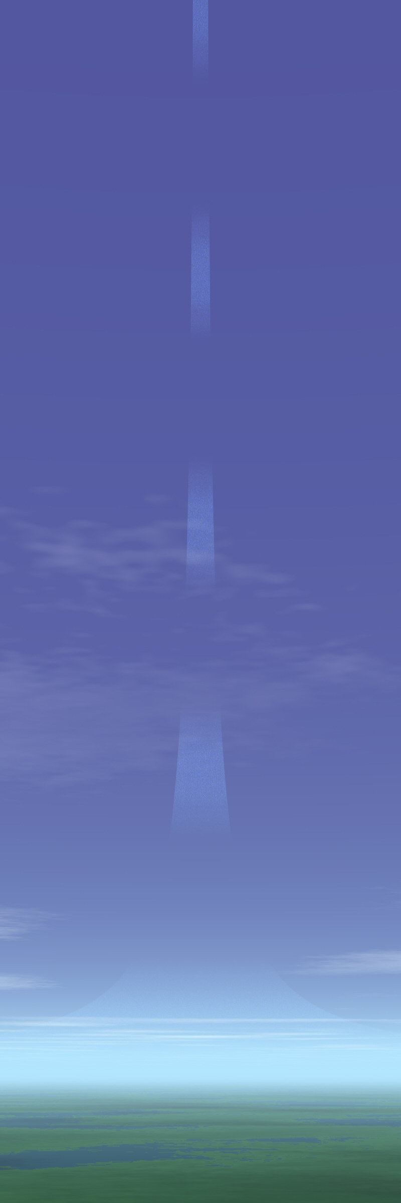

From: Bill Pragnell
Subject: Re: Ringworld re-re-revisited
Date: 27 Oct 2005 04:55:01
Message: <web.43609583ca18a3ea731f01d10@news.povray.org>
Here's the other image.
Oh, and apologies to Alain - there are indeed large penumbrae; indeed,
almost half of every daylight period on the Ringworld would be, to some
degree, partially-lit.
Bill
Date: 27 Oct 2005 08:51:22
Message: <4360cd4a@news.povray.org>
news:web.4360929f30852916731f01d10@news.povray.org...
pretty
regard
a
an
Excellent images, both of them! The atmosphere is much better than in my own
experiments. I am afraid that we have to cheat a bit to get it really right.
In truth, because of the dimensions, the whole *foreground* is a landscape
in itself, almost separate from the background arch.

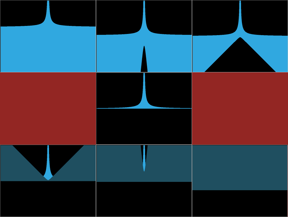

From: Bill Pragnell
Date: 28 Oct 2005 08:00:00
Message: <web.4362127eca18a3ea731f01d10@news.povray.org>
Right, just to illustrate this suspected precision glitch, here's 7 images
of a simplified Ringworld (please excuse the crudity of the composite).
The Ring is a hollow open cylinder 1 million units tall and 90 million units
in radius, with a light at the centre. I've translated it by 90 million y
so that the origin lies on the Ring surface with the x axis at a tangent.
The first three images are, left to right, a camera y = 100, 10, 1.
The middle image is camera y = 0.
The final three images are, left to right, a camera y = -1, -10, -100.
Firstly, Thomas, do you see the same thing with your Ring?
Secondly, can anyone clarify what exactly is happening here? Is it a
precision problem, or something else?
code:
camera { location <0, 100, 0>
         up <0, 1, 0>
         right <4/3, 0, 0>
         direction <0, 0, FoV_75>
         look_at <-1000, 0, 0> }
#declare Ring = union {
  light_source { <0, 0, 0> color White }
  cylinder { <0, 0, -500000>, <0, 0, 500000>, 90000000 open hollow
             pigment { color SkyBlue }
             finish { ambient 0.5 } } }
object { Ring translate <0, 90000000, 0> }
Bill, confused.
Download 'ringtest.png' (9 KB)
Preview of image 'ringtest.png'
Date: 29 Oct 2005 02:48:51
Message: <43631b53@news.povray.org>
news:web.4362127eca18a3ea731f01d10@news.povray.org...
units
Yes, Bill. The same happens with my Ring. If I lower my camera towards the
surface I get exactly the same artifacts.
