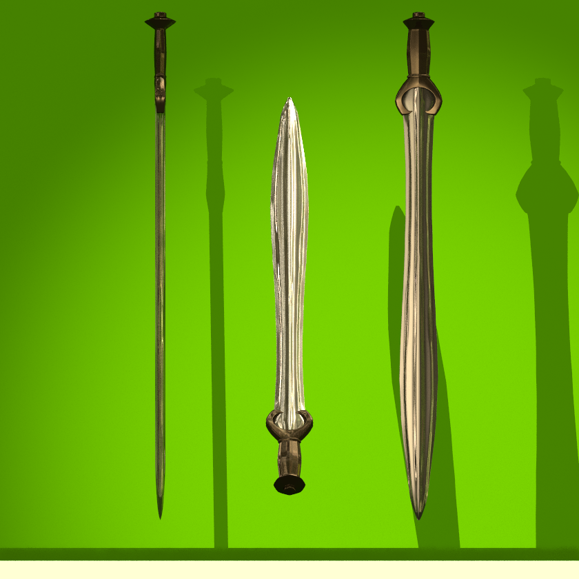

OK. I guess I have the first phase finished, with the bronze hilt in place.
I shall now explore variations: different hilt materials (e.g. wood);
hilt decorations; whatever comes up.
finally, I shall offer it to my Grendel figure :-)
Note: I opted here for an orthographic view. As before, there is a hdr
map reflecting in the metal.
Download 'objects_test - bronzeagesword_04.png' (565 KB)
Preview of image 'objects_test - bronzeagesword_04.png'

Very well done. love to see your Grendel figure.
Mike

That's one nice-looking handle/hilt. How was it modeled?
Sam

Thanks Sam. I based the shape first of all on the information given by
that article which started the project. The authors told and the
photographs showed the hilt to be octagonal in shape; however, looking
closely, I got the impression that the lower part around the blade was
flatter and without a pronounced octagonal shape, so - using Silo - I
modelled the hilt in two parts:
The lower part below the torus-shaped ring as a flattened and deformed
cone with a flattened horizontal cylinder differenced from it to produce
the "claws".
The upper part is based on an octagonal cylinder where the octagonal
faces are separated by creased edges which - after later subdivisions of
the object - produced the intended effect. This handle part is also
slightly flattened but less so than the lower part.
The upper decorative part, is extruded from the octagonal handle and not
flattened.
Finally, when I was sure I did not need to do any more serious work on
the shape, I just kept one quarter of the hilt (like the blade) for
export to .OBJ which I subdivided further in Poseray before exporting to
mesh2 files to be further used in POV-Ray.
This is more or less a standard procedure I have developed over the
years and it works very fast. Most time of course is taken by the
modelling proper in Silo or in Blender (for those who prefer that program).
I am sorry not to have intermediate images of the process.

Thanks for the explanation! It sounds quite involved. I was starting to think
you might have sculpted it, or used some blob-sorcery like H.E. Day used. (I've
probably said this before, but I wonder what happened to him...)
I've never used Silo, but I remember it being pretty much the best modeling
program for a while, along with Rhino. I tried the latter for a while, but then
I found Blender instead. (Everyone's got their favorites!)
Sam
