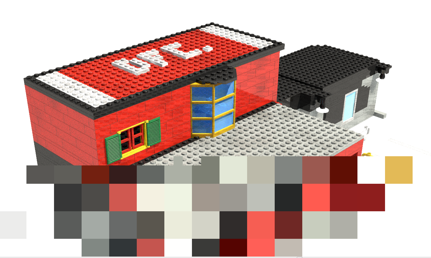

Can anyone diagnose the cause of all the dirty marks on the materials?
Lowering the translucency helped a lot, but I don't know if that's the
actual cure or something else. Thanks.

Global settings:
	#if (Use_Radiosity = true)
		#include "rad_def.inc"
		global_settings
			assumed_gamma	1
			adc_bailout		0.005
			max_trace_level	8
			ambient_light	0
			radiosity {Rad_Settings(Radiosity_Default, 1, 1)}
			#if (Use_SSLT = true)
				mm_per_unit		0.4
				subsurface
					samples 5, 5
	//				samples 400, 40
					radiosity true
			#end
	#else
		global_settings
			assumed_gamma	1
			adc_bailout		0.005
			max_trace_level 8
			ambient_light	1
	#end
Surface finish:
   #declare lg_translucency = <0.01,0.01,0.01>;
   finish {
     ambient 0
     #if (lg_quality > 1)
       diffuse 1
       brilliance 1
       phong 1
       phong_size 40
       reflection { 0.025 falloff 1 exponent 1 }
         subsurface { translucency lg_translucency }
       #end
     #end
     conserve_energy
Subject: Re: SSLT not working so well
Date: 5 Feb 2018 18:52:32

You need to increase the samples count.

// try this :
    samples 10, 10
// or this :
    samples 12, 8

You don't need "#if (Use_SSLT = true)". If SSLT is not enabled in the
global_settings{...} block, then the subsurface{...} block have no
effect and get ignored.
You should use reflection{0.025 fresnel}, or slightly higher, and set
the IOR to around 1.5.
Just after the end of the finish block, add :
interior{ior 1.5}

Am 05.02.2018 um 21:31 schrieb Mike Horvath:
Due to its inner workings, SSLT /per se/ is prone to high-frequency
noise, that may sometimes exhibit a pattern. However, what I see in the
image appears block-ish (on the wide red wall) or blotch-ish (left sides
of the pieces making up the "DFC." writing), which strongly points
towards radiosity as the culprit.
Using more pretrace steps will probably help. Also, make sure to use
"always_sample off" (the default as of v3.7).
As for SSLT, at the size you're rendering, I doubt that subsurface
scattering will make much of a difference. Most LEGO bricks are not very
translucent. The lighting situation (comparatively strong diffuse
illumination from all sides, very few shadows visible) is also a
situation where SSLT would have little prominent effect.

For most LEGO materials, a refractive index of 1.6 is closer to the mark.

Yeah, my mistake. I will turn it off.
