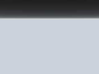

I /think/ I might have broken something - this render of the benchmark
scene doesn't looks quite right... >_<
Download 'benchmark.png' (6 KB)
Preview of image 'benchmark.png'
From: omniverse
Subject: Re: Not Quite Right
Date: 5 Dec 2016 01:00:00
Message: <web.5845017b6c1a04419c5d6c810@news.povray.org>
heh, well, only way I can get that same thing is by commenting out everything
after the fog statement. If that was the reason it's more like a scene deletion
than a bug!  :)
From: clipka
Date: 5 Dec 2016 02:02:51
Message: <5845111b$1@news.povray.org>
Am 05.12.2016 um 06:56 schrieb omniverse:
> than a bug!  :)
No, I'm currently refactoring the bounding hierarchy code. So I'm quite
sure I've taught POV-Ray to utterly fail to look up any objects in the
bounding box tree. Or the BSP tree if +BM2 is used. Or the simple list
of objects when +BM0 is used.
Which in a sense means I'm on the right track: Until now all the three
modes used completely different code. Now I've made them completely
interchangeable, hiding behind a common interface.
So the fact that I get the same broken picture regardless of the +BMn
setting means that the implementations of the different bounding
hierarchies have been adapted to the new interface consistently; and
that the render engine does indeed consistently use the new common
interface... just not /correctly/ ;)
See - you're making progress :-).  It's sometimes hard to imagine that
the transition from "inconsistent" to "consistent" sometimes passes
through "consistent but broken" first and that can be considered a step
forward.

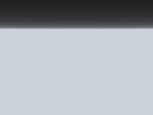

I give you another hint: This is how it looks with the height_field set
to "no_image" ;)
Download 'benchmark.png' (61 KB)

Okay, now that would scare me. Just how convoluted is the source code anyway?
Wait, don't answer that, I probably don't want to know and couldn't understand
anyhow!
For some reason this makes me think of a fun house hall of mirrors at the fair.

Am 05.12.2016 um 17:24 schrieb omniverse:
>> Am 05.12.2016 um 13:47 schrieb omniverse:
>> to "no_image" ;)
> anyhow!
To the contrary, it didn't scare me in the least -- it just confirmed my
guess: Turns out I just got the test for all the "no_whatever" flags
backwards.
