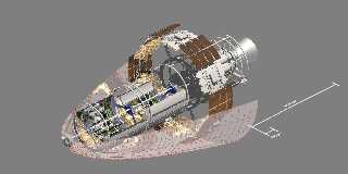

I decided to dust off this old scene and work on a few more bits.
I finalized how the docking bay and engine are going to be laid out, and
I am happy with them.
I also split the habitation area into two counter-rotating sections. I'm
thinking of making the end caps concave, like the bottom of a soda can.
A note about the cone in front. It's supposed to be a mesh of copper or
gold wires that are electrically charged to keep dust from coming in
contact with the ship. Kind of the opposite of a solar sail. I need to
work on the wires a bit more to make them apparent.
Enjoy!
Mike

From: Stephen
Subject: Re: Colony ship
Date: 6 Jan 2016 09:03:22
Message: <568d1eaa$1@news.povray.org>
I don't know. I like the effect you have now.
Regards
     Stephen

From: Mike Horvath
Date: 6 Jan 2016 13:50:01
Message: <568d61d9$1@news.povray.org>
Another thing I worry about is the weak spine of the ship. I need to
create struts around the circumference of the ship so the ship does not
break in half when applying thrust! Aircraft and spacecraft IRL tend not
to have spines, but rather a hollow frame.
> Enjoy!
> Mike
Given the size of that ship, the wires won't be individualy visible
unless they are very thick, like around 1m thick...
The part of the spine inside the living section is OK as it don't seem
to have a real structural function. But, going aft, it does indeed look
flimsy.
From: Mike Horvath
Date: 7 Jan 2016 05:25:37
Message: <568e3d21@news.povray.org>
Several changes.
Mike

From: clipka
Date: 9 Jan 2016 19:08:00
Message: <5691a0e0$1@news.povray.org>
Am 10.01.2016 um 00:38 schrieb Mike Horvath:
> I also tweaked the parabolic nose shield. I am very unhappy with the
> texture however. It's supposed to simulate a wire mesh, not a solid
> surface, but I don't think it's working. Here is the texture:
No that indeed doesn't work at all.
You'll want "micronormals", i.e. some "normal {...}" statement with a
pattern scaled so small that it is no longer visible in the image.
Ideally the structure of the pattern should match the structure of
whatever material you intend to simulate.
Make sure you don't get moiree effects from it though; anti-aliasing
might do the trick, otherwise I'd recommend using a tiny bit of focal
blur, or use UberPOV's anti-aliasing mode 3. Or you might just choose a
random pattern, which won't be as close to the real deal but will not
cause any moiree at all.
Speaking of UberPOV, if you go down that route another alternative would
be to just use highly blurred reflections.
