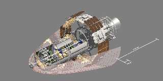

I decided to dust off this old scene and work on a few more bits.
I finalized how the docking bay and engine are going to be laid out, and
I am happy with them.
I also split the habitation area into two counter-rotating sections. I'm
thinking of making the end caps concave, like the bottom of a soda can.
A note about the cone in front. It's supposed to be a mesh of copper or
gold wires that are electrically charged to keep dust from coming in
contact with the ship. Kind of the opposite of a solar sail. I need to
work on the wires a bit more to make them apparent.
Enjoy!
Mike
I don't know. I like the effect you have now.

Another thing I worry about is the weak spine of the ship. I need to
create struts around the circumference of the ship so the ship does not
break in half when applying thrust! Aircraft and spacecraft IRL tend not
to have spines, but rather a hollow frame.

Given the size of that ship, the wires won't be individualy visible
unless they are very thick, like around 1m thick...
The part of the spine inside the living section is OK as it don't seem
to have a real structural function. But, going aft, it does indeed look
flimsy.

I decided to use an array of spheres for the spiral lamp light instead
of a single object since it's a lot easier to control.
I also tweaked the parabolic nose shield. I am very unhappy with the
texture however. It's supposed to simulate a wire mesh, not a solid
surface, but I don't think it's working. Here is the texture:
#declare thin_wire_material = material
	#switch (TexQual)
		#case (-1)
			texture {lowqual_pig(Seed)}
		#break
		#case (0)
			texture {pigment {gamma_color_adjust(<0.70, 0.25, 0.15, 0.00, 0.90>)}}
		#break
		#case (1)
		#case (2)
			// needs an interior too I think
			texture
				finish
				    ambient		0.15
				    brilliance	5
				    diffuse		0.6
				    metallic
				    specular	0.80
				    roughness	1/100
				    reflection	0.65
		#break
Download 'gh_scene_spinner_cutaway_27.png' (847 KB)
Preview of image 'gh_scene_spinner_cutaway_27.png'
From: clipka
Subject: Re: Colony ship
Date: 9 Jan 2016 19:08:00
Message: <5691a0e0$1@news.povray.org>
Am 10.01.2016 um 00:38 schrieb Mike Horvath:
No that indeed doesn't work at all.
You'll want "micronormals", i.e. some "normal {...}" statement with a
pattern scaled so small that it is no longer visible in the image.
Ideally the structure of the pattern should match the structure of
whatever material you intend to simulate.
Make sure you don't get moiree effects from it though; anti-aliasing
might do the trick, otherwise I'd recommend using a tiny bit of focal
blur, or use UberPOV's anti-aliasing mode 3. Or you might just choose a
random pattern, which won't be as close to the real deal but will not
cause any moiree at all.
Speaking of UberPOV, if you go down that route another alternative would
be to just use highly blurred reflections.

How would I create the pattern? The radial part is easy, but how do I
get the ribbed portion? Which function do I use?
f_paraboloid(x,y,z, P0)
Or something else?

I guess I should clarify that what you see in that last image is not a
texture, but a physical array of cylinders and tori. Replacing them with
a proper texture would make the scene render much faster as well.
