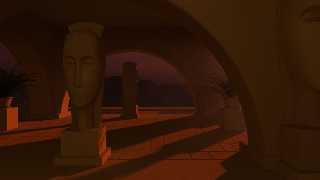

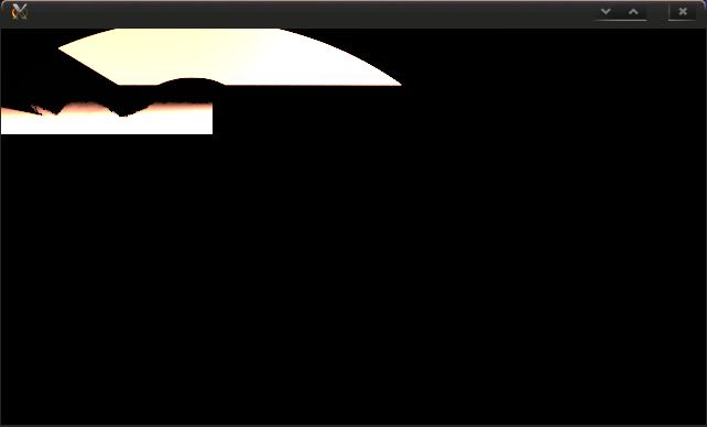

not sure but thinking there's a problem with area_illumination when
using it with scattering media ...
i first gathered radiosity data without using area_light then used saved
rad data in a separate run.
in the first image with area_illumination off you see what it /should/
look like ... the second image (screen shot because of excessive render
time) shows how the scattering media blooms out. i only let it run long
enough to show the problem

btw: discovered this after a 114+ hour beauty run ... needless to say
(but in gonna say it) i was bummed out (don't get pissed off much these
day) :-)
Download 'ai-off.png' (516 KB) Download 'ai-on.png' (47 KB)
Preview of image 'ai-off.png'
Preview of image 'ai-on.png'

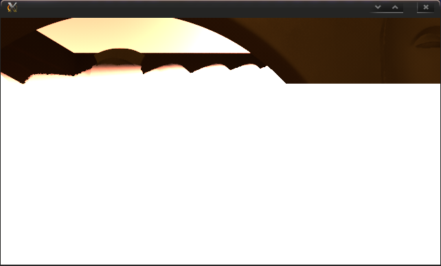

problem is still there without radiosity ... also removed the two
radiosity helper objects
> It could be that area_illumination is broken with regards to scattering
> media - or it could be that you're doing something wrong.
well i'm thinking it's the former ... i was very careful about making
sure the media container enclosed the building.

Download 'no-rad.png' (18 KB)
Preview of image 'no-rad.png'

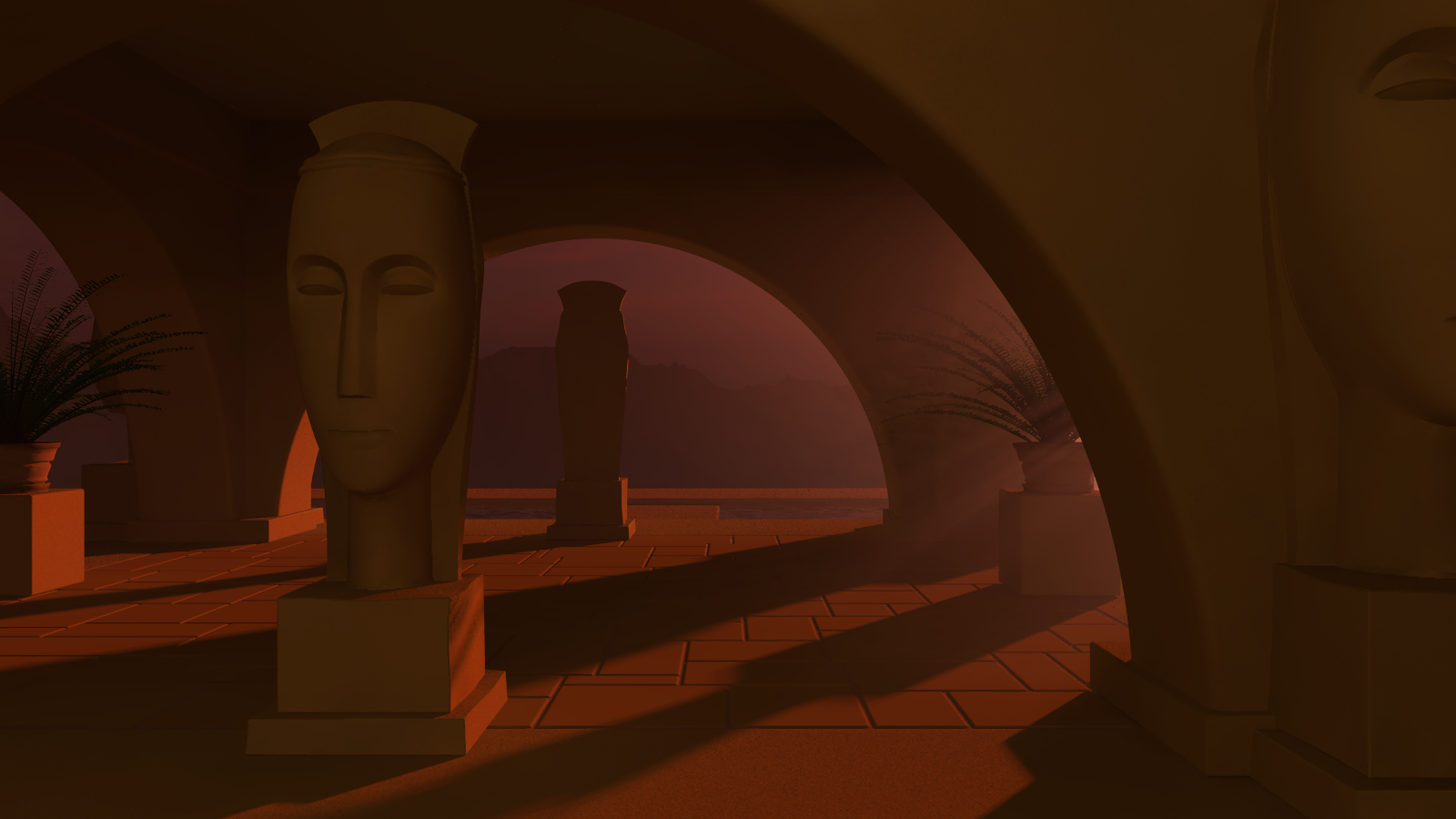

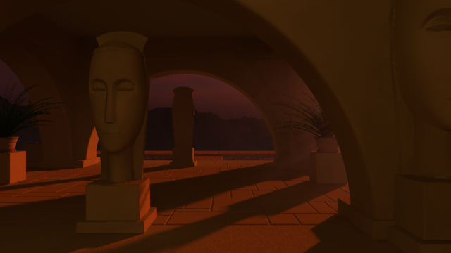

here's a beauty run with area lights (area_illumination off) so you can
tell what i was going for
Download 'temple.png' (2878 KB)
Preview of image 'temple.png'
