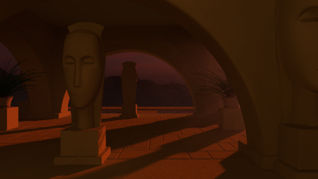

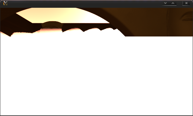

not sure but thinking there's a problem with area_illumination when
using it with scattering media ...
i first gathered radiosity data without using area_light then used saved
rad data in a separate run.
in the first image with area_illumination off you see what it /should/
look like ... the second image (screen shot because of excessive render
time) shows how the scattering media blooms out. i only let it run long
enough to show the problem
i did a little troubleshooting to try to eliminate some of the things i
/thought/ i may have been doing to contribute to the problem. during the
radiosity gather i have a couple of no_image no_reflection no_shadow
objects as radiosity helpers that are /not/ present in the scene during
the media run ... that didn't make the bloom go away. the only thing
that makes it go away is area_illumination off. is this a problem or
should i /not/ be using area_illumination with scattering media?
same behavior with both uberpov and povray:
ash@linux-c2bm:~/POV-Ray/Source $ uberpov --version
UberPOV 1.37.1.0
ash@linux-c2bm:~/POV-Ray/Source $ povray --version
POV-Ray 3.7.1-alpha.8017570.unofficial
btw: discovered this after a 114+ hour beauty run ... needless to say
(but in gonna say it) i was bummed out (don't get pissed off much these
day) :-)
Download 'ai-off.png' (516 KB) Download 'ai-on.png' (47 KB)
Preview of image 'ai-off.png'
Preview of image 'ai-on.png'
From: clipka
Subject: Re: area_illumination off or on?
Date: 10 Jul 2015 23:13:57
Message: <55a089f5$1@news.povray.org>
Am 10.07.2015 um 15:37 schrieb James Holsenback:
It certainly is a "problem" either way ;)
For more clarity what is going on, I suggest rendering the scene without
radiosity. I expect that to have no effect on the problem.
It could be that area_illumination is broken with regards to scattering
media - or it could be that you're doing something wrong.
Fact is, area_illumination and scattering media are /supposed/ to get
along well.

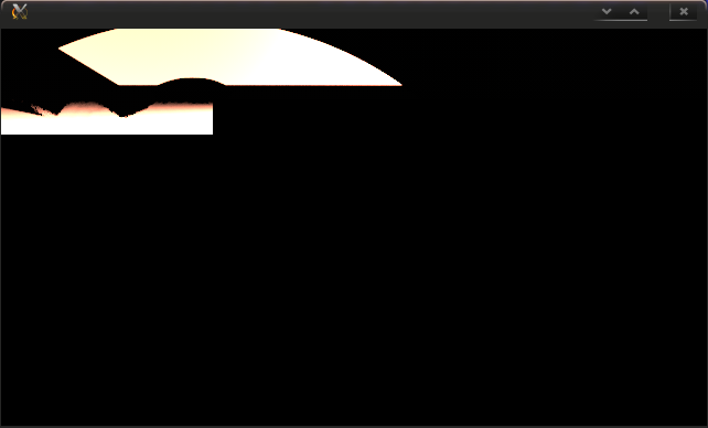

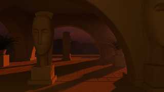

From: James Holsenback
Date: 11 Jul 2015 15:34:22
Message: <55a16fbe$1@news.povray.org>
problem is still there without radiosity ... also removed the two
radiosity helper objects
well i'm thinking it's the former ... i was very careful about making
sure the media container enclosed the building.
box { <-21, -0.1, -21>, <21, 10, 21>
   pigment { rgbt 1 } hollow on finish { diffuse 0 }
   interior {
     media {
       scattering { 3, 0.00275 }
       samples 32, 64
       intervals 1
       method 3
> along well.
thought so ... thanks
Download 'no-rad.png' (18 KB)
Preview of image 'no-rad.png'

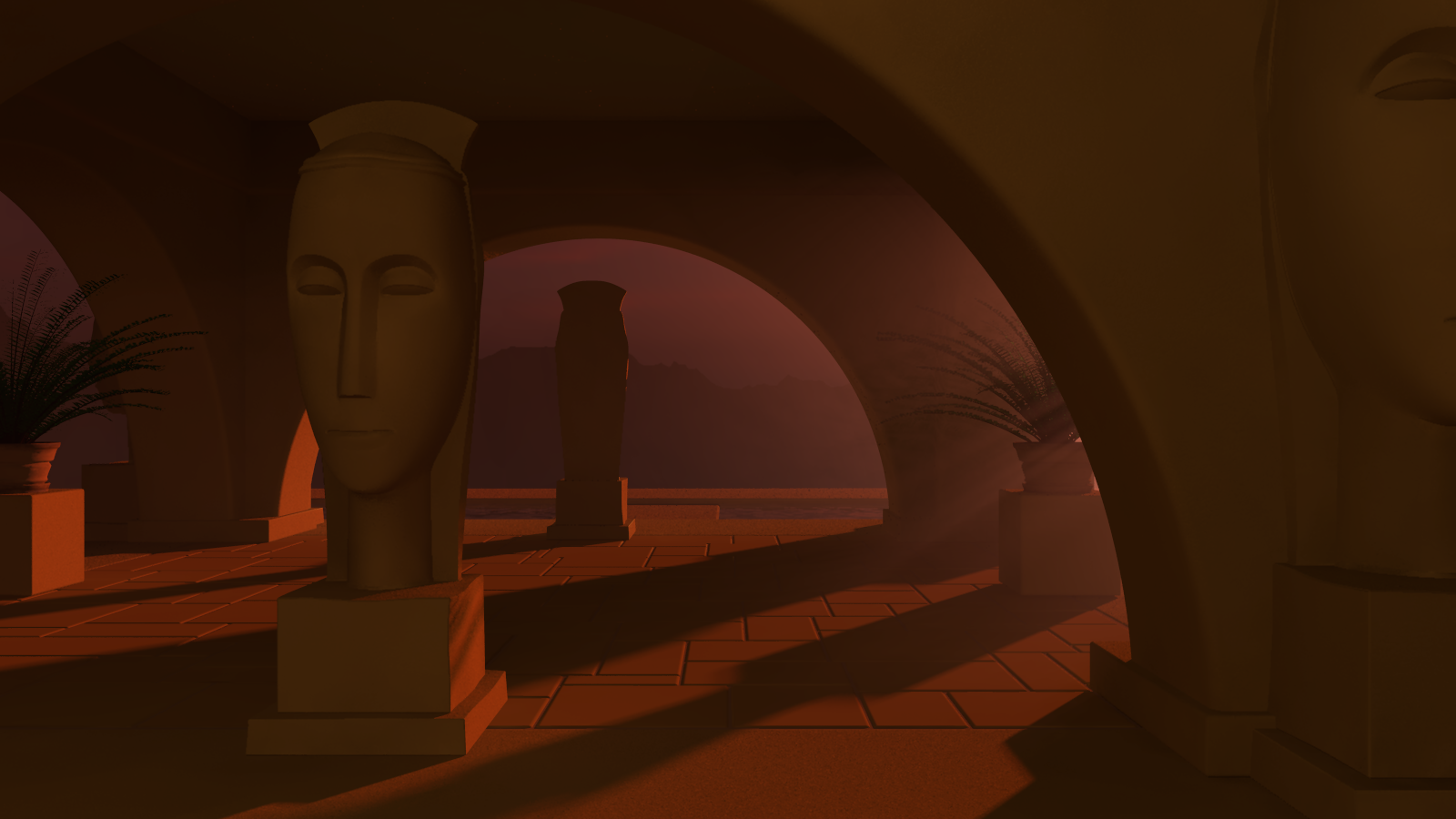

Date: 11 Jul 2015 15:37:35
Message: <55a1707f@news.povray.org>
> day) :-)
here's a beauty run with area lights (area_illumination off) so you can
tell what i was going for
Download 'temple.png' (2878 KB)
Preview of image 'temple.png'
From: Paolo Gibellini
Date: 13 Jul 2015 08:32:22
Message: <55a3afd6$1@news.povray.org>
James Holsenback wrote on 11/07/2015 21.37:
A nice ad evocative image!
Paolo
Date: 13 Jul 2015 14:30:05
Message: <55a403ad$1@news.povray.org>
> Paolo
thanks
