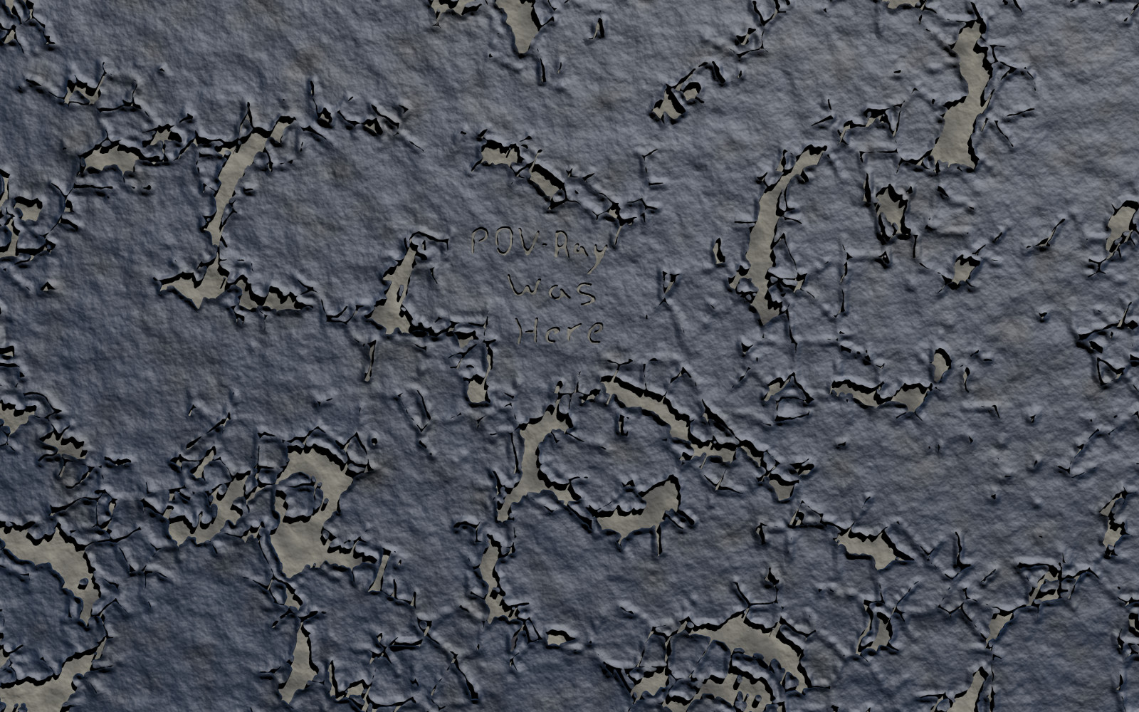

After a false start a month or more back, I recently resumed trying to
use Thomas's peeling paint macro texture as the basis for an isosurface.
The attached image is a single isosurface where his macro was used to
create two complementary black and white images each blurred/played with
in Gimp. The blurred true image is used for where there is paint and the
false blurred for displacement. There is a third povray image which
serves as the wall behind the paint
It is a single isosurface because I had the idea to do another color of
paint on the underside of the peel, but in the end didn't get that far.
  Guess I'd say the isosurface technique sort of works though a bit hard
to control. Expect other approaches to “real” peeling would be tricky
too. About 15 minutes for a 1 light render at 1920x1200.
Bill P.
Download 'peelingpaintwall.jpg' (493 KB)
Preview of image 'peelingpaintwall.jpg'

Goodness!
This is really looking good indeed. I think you have tackled the problem
in a very elegant way, even if the isosurface is difficult to control. I
am impatient to try it out!
From: Bald Eagle
Subject: Re: Peeling paint isosurface.
Date: 16 Aug 2014 11:20:00
Message: <web.53ef75d9feed12575e7df57c0@news.povray.org>
Holy cow - that's an amazing effect!
(I like the graffiti)
You clearly have a deep understanding and excellent ability to utilize
isosurfaces in a way I haven't even begun to understand.
I have some questions -
Can you increase the "height" of the peel?
Does this method allow for isolated flakes to appear?
Is it possible to define the parameters used to make this sort of thing
infinitely tilable?
And lastly, do you have any examples or tutorials you can point to, for your
viewers to play along at home?   :)
Thanks!  Great work, and an impressive result.

Am 16.08.2014 03:17, schrieb William F Pokorny:
This looks incredibly credible!

If the isosurface function looks like z-InagePattern(x,y,0)*1, changing
the *1 to *2 will double the hight.
The pattern is controled by two images. If those images are tileable,
then, the resulting isosurface can tile.
The same will apply to create isolated flakes: If the source image
contains isolated areas, those will show as isolated flakes.
Date: 17 Aug 2014 03:13:31
Message: <53f0561b$1@news.povray.org>
However, it may be that /all/ parts of the isosurface double in height
and that would not be desirable. Only the peels.
From: William F Pokorny
Date: 17 Aug 2014 05:47:15
Message: <53f07a23$1@news.povray.org>
> Alain
Thanks for answering Alain.
I'll add that the component shape functions for the wall and paint are
thin - using scaled abs(z)-image. While the peel height can be increased
or decreased, it is just a displacement in z and so the struggle is
keeping a realistic peeling look as the displacement amount changes.
Related, it is possible to play with the gamma used while reading the
image to change the blur profile to perhaps get more of a curl to the
peel, but I've not yet played with that technique on this peeling paint
isosurface.
I've posted a zip of code posted to p.b.scene-files.
Bill P.
> Thomas
In that case, it may be interesting to play with the contrast or the
gamma curve used for the base image. If playing with the gamma, saving
it in a format that don't keep that information would be advisable.
