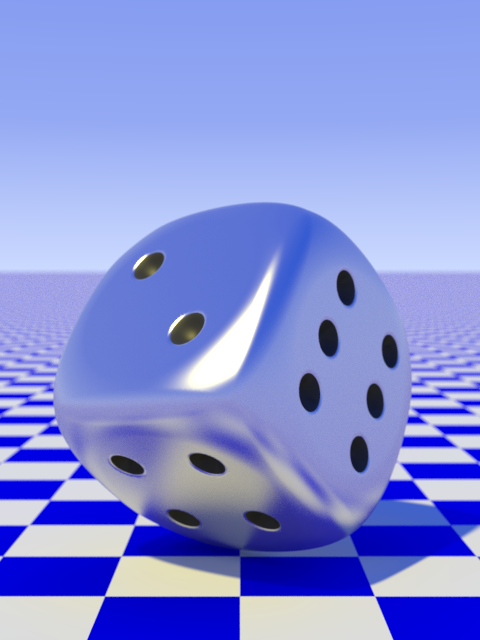

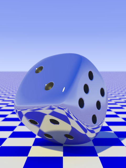

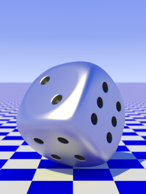

Chrome die on a checkered plane, with varying surface roughness.
Renders were done using POV-Ray 3.7 with a blurred reflection patch;
highlights are specular highlights carefully tuned in both intensity and
roughness to match the reflection.
Roughly 2 minutes of parsing time for the die mesh, plus 20 minutes
rendering time. Not to forget the one-time 8 minutes or so to generate
the mesh from an isosurface.
Before you get over-excited: No, I do /not/ intend to push this patch
into POV-Ray 3.7 proper. Instead, I plan to expand it into a full-blown
stochastical rendering patch, akin to MC-Pov.
There - that's it, now you know. The die is cast. Alea iacta est.
Download 'steeldie 2011-11-22 1854.png' (154 KB) Download 'steeldie 2011-11-22 1925.png' (167 KB) Download 'steeldie 2011-11-22 1955.png' (180 KB) Download 'steeldie 2011-11-22 2018.png' (181 KB)
Preview of image 'steeldie 2011-11-22 1854.png'
Preview of image 'steeldie 2011-11-22 1925.png'
Preview of image 'steeldie 2011-11-22 1955.png'
Preview of image 'steeldie 2011-11-22 2018.png'

Am 23.11.2011 09:43, schrieb Thomas de Groot:
> I must say that this is the best isosurface to mesh patch I have seen
> until now, and fast too. Congrats with that Christoph!
Um... I think we have a misunderstanding here: The patch I wrote does
the blurred reflections (and auto-adjustment of specular highlight
parameters to match the reflections). The isosurface to mesh conversion
was done with some classic SDL-based isosurface-to-mesh converter by...
let me see... there: Kevin Loney, Jaap Frank & Tor Olav Kristensen
(Kudos to them).
> I can live with a full-blown rendering patch, but any reason you can
> give us why not in 3.7?
As for the blurred reflections, they need serious oversampling, and may
lead to bright speckles otherwise; Therefore some mechanisms need to be
implemented for the feature to work stand-alone (currently I have to use
focal blur to achieve the oversampling) which will make it a piece of
cake to also add a stochastic implementation for what's currently done
by radiosity.
