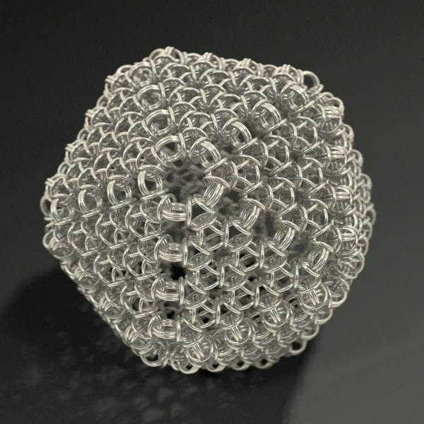

I've been off the newsgroups for a while with the whole grad school
thing, but recently found time and motivation to pull out the ol' raytracer.
For the past few years I've tried to combined two of my hobbies,
chainmaille and povray, and have been putting together a bunch of macros
for various patterns and trying to make good cross-scene metal textures
for the rings. I think I may have finally gotten my first render that I
can almost fool myself into thinking is real!
100% procedural, no image_maps anywhere, uses Jaime's Lightsys (only
espd_lightsys and CIE) and Edouard's 35mm Camera macros
1000x1000 version and a link to the photograph I used as a reference:
http://cshake.deviantart.com/art/Icosahedron-Again-189246693
render time: 4 hours 35 mins, AMD Phenom 9950 (quad 2.6)
I could have gotten even smoother focal blur, but I'm content with this
for now (count 50 variance 1/10000)
Download 'icosahedron_2.jpg' (87 KB)
Preview of image 'icosahedron_2.jpg'

Gee. You must be "geniously crazy" (pun intended) for either - the real
stuff and the CGI one. I can't tell which of both I find more impressing.
Are you using POV-Ray 3.6, or a 3.7 beta?

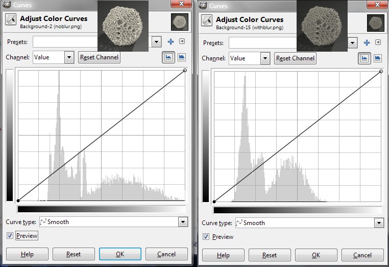

On a topic related to the picture itself, why does adding focal blur
make the entire scene darker than without? I ran all my test renders
with the non-blur camera settings and had the colors I wanted, but with
the blur (no other differences) I had to bump up the brightness curves
in post to get the same look. Looking at the camera macro it didn't add
any sort of filter in front of it either.

Here is a comparison, I rendered twice at 100x100 to get samples, and
here are the levels for each side by side. I'd expect a bit less grain
on the blurred one, but not the range compression that it shows.
The only change in the code between these two renders was
commenting/uncommenting these lines:
Camera35mm_SetFocalSamples(50)
Camera35mm_SetFocalVariance(1/10000)
Camera35mm_Point( cam_pos, look_pos, focal_pos, focal_length, fstop )
//Camera35mm_NoBlur( cam_pos, look_pos, focal_length, fstop )
which effectively turns into
camera {
	perspective
	location cam_pos
	look_at look_pos
	angle fov
	right x * 1
	up y * image_height/image_width
for no blur, or for blur: (with various #if blocks collapsed to their
outcome in this scene)
camera {
	perspective
	focal_point focal_point_on_line
	aperture (apertureDiameter ) * 2  // Magic Number
	blur_samples Camera35mm_FocalParams[ Camera35mm_FocalSamples ]
	variance Camera35mm_FocalParams[ Camera35mm_FocalVariance ]
	confidence Camera35mm_FocalParams[ Camera35mm_FocalConfidence ]
	location cam_pos
	look_at look_pos
	angle fov
	right x * 1
All the #local variables used in both camera blocks are the same, so I
would have to agree that the difference comes from the internal code
somewhere.
Download 'brightness_comparison.jpg' (74 KB)
Preview of image 'brightness_comparison.jpg'

I've identified it as my "make it look like there is a camera in the
reflection" part. I put an object with a surface 0.001 units directly
behind the camera, and that is what does it. Minimal scene as follows,
most of the positioning numbers are just lifted from the scene I was
using so they're arbitrary. This works no matter the version keyword
while rendering in beta40, and also happens in 3.6.1c.

You should tilt the object according to the camera's orientation.
Otherwise, some of the rays shot may originate from inside that object,
explaining why everything gets pretty dark.
The focal blur camera works essentially by randomly ofsetting the camera
location in the plane perpendicular to the nominal "viewing axis".
