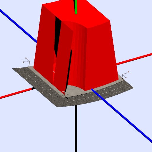

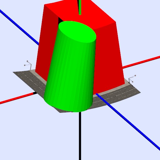

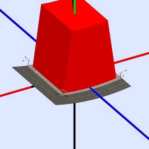

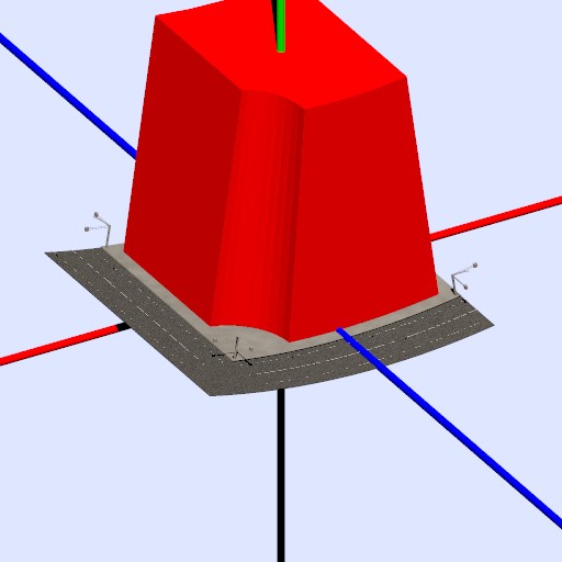

When I intersect two solid meshes I get weird artifacts, as can be seen
in the following images. The red object is the main object, the green
object is the one I'm trying to subtract. The artifacts aren't _always"
there. Sometimes they disappear when the radius of the green object
changes. Any clue why this is happening?

From: clipka
Subject: Re: Mesh CSG help
Date: 18 Jun 2010 07:34:19
Message: <4c1b59bb$1@news.povray.org>
Am 17.06.2010 18:08, schrieb tom millican:
> I wasn't aware that you could use CSG with meshes.
They need to be solid in order to do that - i.e. they need an
"inside_vector", and should be fully closed.

Am 17.06.2010 17:48, schrieb SharkD:
What's your inside_vector? Does it happen to be pointing along the blue
line (whatever axis that may be)? If so, try changing that to something
pretty random.

From: clipka
Date: 19 Jun 2010 13:20:15
Message: <4c1cfc4f@news.povray.org>
Am 19.06.2010 18:08, schrieb SharkD:
>> pretty random.
> I'm a bit confused by input_vector. Is it a vector or a point? I have
> simply been placing it at the exact center of each mesh, which sometimes
> happens to be the origin.
As the name suggests, inside_vector (not input_vector, btw) is indeed a
vector.
POV-Ray's implementation of intersection and difference CSG uses two
operations: Computing intersections between a ray and the member
objects, and testing whether such an intersection point is inside the
other member objects.
For most object types, the inside-test is defined via a mathematical
formula (for instance, for a sphere you just test whether the distance
between the point in question and the center is smaller than the
sphere's radius). For meshes, this is not so easy; so instead, POV-Ray
shoots a "random" test ray from the point in question and tests how many
times it intersects the mesh: If the number of intersections is odd, the
point must be inside, otherwise outside.
inside_vector specifies the "random" direction in which to shoot that
test ray. Theoretically the direction should not matter, but in rare
cases this algorithm might lead to artifacts - which then can be made to
disappear by choosing a different test ray direction.
An inside_vector of <0,0,0> is equivalent to specifying no inside_vector
at all, i.e. leaving the mesh non-solid.
