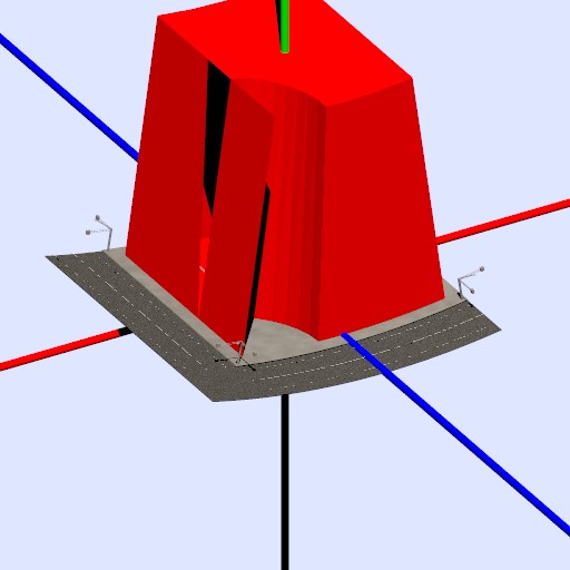

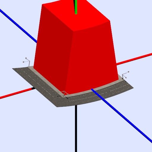

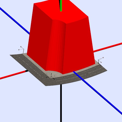

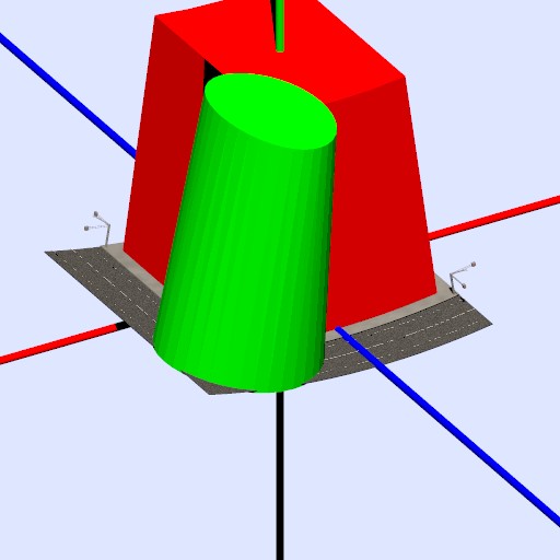

When I intersect two solid meshes I get weird artifacts, as can be seen
in the following images. The red object is the main object, the green
object is the one I'm trying to subtract. The artifacts aren't _always"
there. Sometimes they disappear when the radius of the green object
changes. Any clue why this is happening?

I wasn't aware that you could use CSG with meshes. I would generally do that
before exporting to create the mesh. Could it be that there are occasionally
"holes" in the mesh that's created?

From: clipka
Subject: Re: Mesh CSG help
Date: 18 Jun 2010 07:34:19
Message: <4c1b59bb$1@news.povray.org>
Am 17.06.2010 18:08, schrieb tom millican:
They need to be solid in order to do that - i.e. they need an
"inside_vector", and should be fully closed.

Am 17.06.2010 17:48, schrieb SharkD:
What's your inside_vector? Does it happen to be pointing along the blue
line (whatever axis that may be)? If so, try changing that to something
pretty random.
