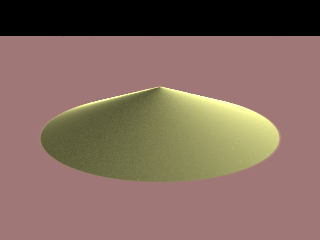

I'm starting to come up with some stuff that I want to build sand
castles in. :-)
I'm starting to wonder if all my "details" are really helping or
hurting. Here's two renders, one with lots of yummy little patterns, and
one that's completely flat except for the subsurface scattering.
Speaking of subsurface scattering, just a little goes a long way. I
probably overdid the scattering media in these images, because
everything looks like its underwater. Which is still cool. ;-)
William Tracy
You know you've been raytracing too long when you thought the infamous
Book of Questions would have deeper stuff in it, like "If you could only
use one renderer, which would it be?', etc.
    -- Taps a.k.a. Tapio Vocadlo

Download 'sand-grainy.png' (99 KB) Download 'sand-smooth.png' (51 KB) Download 'sand-grainy.png.sig.dat' (1 KB) Download 'sand-smooth.png.sig.dat' (1 KB)
Preview of image 'sand-grainy.png'
Preview of image 'sand-smooth.png'

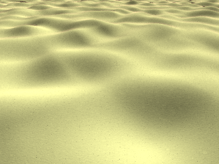

It's useless in animations, but have you tried the 'crand' option?
It works better than I expected, actually.
(...and sorry for not remembering to convert those other pictures to jpg
before uploading them.)
William Tracy

Download 'sand-crand.jpg' (19 KB) Download 'sand-crand.jpg.sig.dat' (1 KB)
Preview of image 'sand-crand.jpg'

        ramp_wave
        scale  0.01
    //finish { crand 0.1 }
But the one you realized is more impressive.
Paolo

Subject: Re: Sand
Date: 23 Nov 2007 10:46:36
Message: <4746f5dc$1@news.povray.org>
"Bruno Cabasson" <bru### [at] alcatelaleniaspacefr> schreef in bericht
news:web.4746b46aee83a16ce8ba46670@news.povray.org...
> I used a kind of 'fadeaway' technique for my snow texture for TerraPOV,
> and I
> posted recently and test render here. It is based on the distance wrt
> camera
> (use of spherical pattern): when near it is one texture, when far it tends
> to
> be a plain color (or whatever else). I intend to integrate fadeaway
> texturing
> macros like this in TerraPOV, because terrain pigments become plain colors
> with
> distance. Something like this can be applied to sand (same problem). It
> can also
> be used for other purposes, of course.
Another possibility, I guess, would be to use the boxed or the cylindrical
patterns. Maybe cylindrical would be better than spherical in a landscape?
What do you think?
