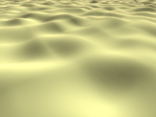

I thought I'd take another shot at a decent sand texture; this is the
result of my first pass. It has all sorts of things wrong with it, but
it's not a bad start. :-) I'm not so much aiming for photorealistic sand
as I'm shooting for something that people instantly recognize as sand.
Whenever anyone posts sand images up, people complain about not seeing
sand grains, even if the sand in question is so far away that you
wouldn't be able to see the sand grains. The general solution to this
seems to be to have some sort of patterning going on at just about the
pixel level, where you can just see that there is something going on,
but you can't really see what.
The problem that I've had with this is that you have to tune your
patterning to the resolution you're rendering at. If you render at a
lower resolution, the patterning disappears; if you render at a higher
resolution, the larger-than-realistic "sand grains" become glaringly
obvious.
This also marks the first time I've tried to do subsurface scattering. I
didn't realize just how easy it is to set up, actually.
BTW, does anybody know if it's possible to make subsurface scattering
and normal perturbations play well together?
William Tracy
You know you've been raytracing too long when you stop using a
protractor to measure angles because you can do it just by looking.
    -- Taps a.k.a. Tapio Vocadlo

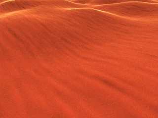

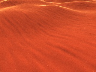

I'm starting to come up with some stuff that I want to build sand
castles in. :-)
I'm starting to wonder if all my "details" are really helping or
hurting. Here's two renders, one with lots of yummy little patterns, and
one that's completely flat except for the subsurface scattering.
Speaking of subsurface scattering, just a little goes a long way. I
probably overdid the scattering media in these images, because
everything looks like its underwater. Which is still cool. ;-)
William Tracy
You know you've been raytracing too long when you thought the infamous
Book of Questions would have deeper stuff in it, like "If you could only
use one renderer, which would it be?', etc.

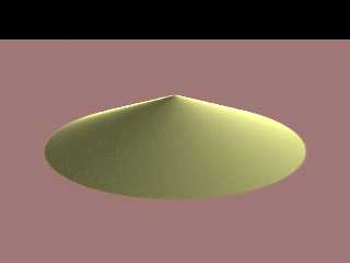

Mark Birch wrote:
> It's useless in animations, but have you tried the 'crand' option?
It works better than I expected, actually.

I like these two images, individually. Is there a way that you could merge the
materials, with the grainy one in the foreground fading to the smooth one in the
midground?
Stephen
