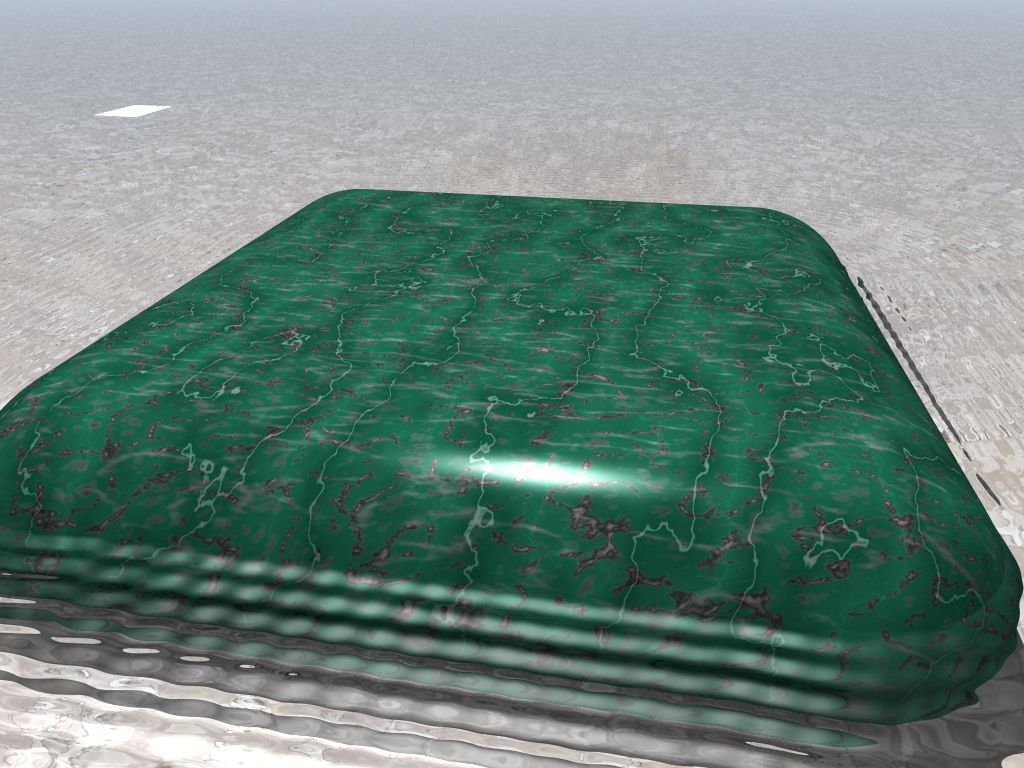

Yes, *this* is the image that took 9 hours and 45 minutes to render. Not
the other one I posted (which took a long old while, but less than 1 hour).
Why did it take so long? The answer is the water; it's an isosurface. It
has a max_gradient of 1.07, but the function that describes it is
extremely complicated and thus takes one hell of a long time to
evaluate. What *is* this function, exactly?
Well, it's 160 splash functions added together. (!)
Each "splash function" is actually just some concentric rings of sine
waves, decaying exponentially as you move away from the center. Each of
the 160 splash functions has a different center point; the center points
trace the outline of the stone block. In this way, the waves appear to
follow the outline of the stone block, the way *real* water would move.
Of course, this only works if you have enough splashes; otherwise you
just get more or less random-looking interference patterns. (It appears
the number of splashes on each edge must be approximately the same as
the frequency of the waves - which would make sense I guess! Thus, the
smaller the ripples are, the more functions you must have.)
Go on, admit it... it *does* look kinda cool. ;-)
Download 'glassware05-wave40.jpg' (123 KB)

Well, as there is no overlapping, no internal bubbles... Why can't you
use a heightfield with a high enough resolution and some "smooth" thrown
in for good measure. I'd think it would look much the same for this
scene. You can use functions for heightfields just as well:
#declare HF_Detail = 100; //Simulates image-resolution of 100x100
   height_field{
     function HF_Detail,HF_Detail{ HF(x,y,z).gray }
     smooth
Tim
aka "Tim Nikias"
From: Orchid XP v3
Subject: Re: "The 10 hour render" (~130KB)
Date: 12 Oct 2006 16:27:51
Message: <452ea547$1@news.povray.org>
>   height_field{
>     smooth
And that does what, exactly? Makes a 100x100 polygon mesh and applies
some normal trickery to give the illusion of a smooth surface?
Well, you learn something every day. Just out of curiosity, how does a
heightfield work when used as a "solid" object? Clearly the function
defines the upper surface, but what about the lower one?

>>     smooth
Yep, 100x100 triangle mesh and then just smooth_triangles, sorta.
Everything "underneath" the heightfield is solid, everything above
isn't. So in the cube from <0,0,0> to <1,1,1>, you divide the box into a
lower and a top part with the heightfield.
Tim

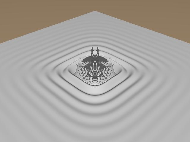

From: scott
Date: 12 Oct 2006 22:38:28
Message: <452efc24@news.povray.org>
>> PS: I haven't tried it, but I think it should work...
> Nice try, but... not, that doesn't work.
> (It makes ripples that are diagonal rather than parallel to the axies.
> And the ripples decrease in frequency rather than amplitude as they
> spread out. And there is no rounding at the corners.)
> I am looking into making the function simpler though - but hopefully
> without loosing its "organic" quality.
How about this:
y-10*sin(10*pow(pow(x,4)+pow(z,4),1/4)-1)/(pow(abs(x)+1,4)+pow(abs(z)+1,4))
(designed for a box{-8,8})
The middle gets a bit screwed up but you can chop that bit out for your box
to go in.
Download 'iso.jpg' (20 KB)
Preview of image 'iso.jpg'
