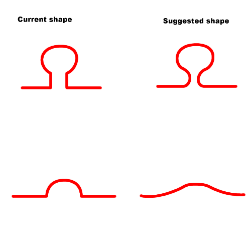

I realized you've already posted the code. I've looked more closely at the
images and maybe you could find some time to "improve the shapes of the
pieces. It would take some time and effort, but I believe it may be worth
it. I include an attachment, because ASCII art is not good enough for this
Note: if/when you use differences and intersections in your code, I guess it
would be wise to add "manual" bounding boxes to improve the rendering
times...

Date: 22 Aug 2004 09:48:15
Message: <4128a41f$1@news.povray.org>
Hi Jelby,
I understand what you mean now, but it is completely impossible to do that
sort of thing with this macro. In the way this macro works, there is no
knowledge of the actual final shape of the piece. So any test which checks
wether a piece is a "defect" is not being done at the moment. It would be
possible to check for any "defects", but not to do anything with it, since,
when you change a "defect" into a normal piece, it would need the
surrounding pieces to change as well (otherwise they won't fit). When the
surrounding pieces change, there will likely be at least one new "defect".
It would require a lot of code and time to make a "defects_density"
parameter work. I wonder how puzzle manufactures do this...
Well, one very crude method comes to my mind now: simply create random
puzzles (and "defect-test" them) until you find one that matches the desired
defects density. But it is a silly idea.
> I don't know what's the structure of your macro right now, but unlike my
> first suggestion (in the previous post), this one should be no real
problem
> (I guess). :)
So, you guesed wrong :-).
About the waving edges, it can be done but i need a special shape. I'm
thinking about making a deformed square using splines (one spline for each
edge), but i can't find a way to do this.
Greetings,
JWV

From: JWV
Subject: Re: puzzles (again) [202 KB]
Date: 22 Aug 2004 09:51:20
Message: <4128a4d8@news.povray.org>
thanks for the comment. The shapes will be improved, but not today since i'm
suffering from a (huge) hangover :-P.
JWV
"Jellby" <jel### [at] M-yahoocom> wrote in message
news:41285ff4@news.povray.org...
> Among other things, "JWV" <jwv|at|planet.nl> wrote:
> >> - Also, some edges could have no "protrusion", just a more wavy shape
> >> than the bare straight edge. ASCII picture:
> >>                              ____
> >>      ____                   \    /
> >>   __/    \__  instead of  __/    \___
> > After staring at, thinking about, and realligning the ascii picture: Yes
> > that would be possible (will try to implement that).
it
> times...
> light_source{9+9*x,1}camera{orthographic look_at(1-y)/4angle 30location
> 9/4-z*4}light_source{-9*z,1}union{box{.9-z.1+x clipped_by{plane{2+y-4*x
> 0}}}box{z-y-.1.1+z}box{-.1.1+x}box{.1z-.1}pigment{rgb<.8.2,1>}}//Jellby
