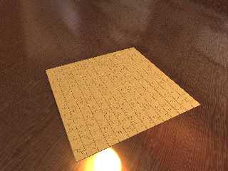

Hello,
Inspired by the question of incognito, I started making a puzzle macro.
It is nearly finished (some minor CSG stuff to be done), but good enough for
a demo scene.
The macro needs the following variables:
-number of collums (integer)
-number of rows (integer)
-radius of edges (float)
Variables that can be changed before the macro is called:
-fast (no rounded edges) (on/off)
-party(gives the pieces random collors) (on/off)
-texture of pieces
-suggestions???
The macro will be released "soon".
Of course comments, questions are very welcome as usual  :-).
Greetings,
JWV
Download 'puzzle.jpg' (203 KB)
Preview of image 'puzzle.jpg'
From: Jellby
Subject: Re: puzzles (again) [202 KB]
Date: 20 Aug 2004 18:07:11
Message: <4126760f@news.povray.org>
> -texture of pieces
> -suggestions???
Neat!
Some observations/suggestions:
- Could the horizontal/vertical lines separating the pieces (ignoring the
"protrusions") be a bit more wavy? The pieces are too square for my liking
(I find real puzzles like that somewhat boring).
- Also, some edges could have no "protrusion", just a more wavy shape than
the bare straight edge. ASCII picture:
                             ____
     ____                   \    /
  __/    \__  instead of  __/    \___
- Most real puzzles I've found have a lower density of "special" pieces,
meaning pieces which are *not* the typical shape:
     ___    ___
    |   |__|   |
   _|          |_
  |_            _|
    |    __    |
    |___|  |___|
This density of "defects" could be adjusted with some parameters...
light_source{9+9*x,1}camera{orthographic look_at(1-y)/4angle 30location
9/4-z*4}light_source{-9*z,1}union{box{.9-z.1+x clipped_by{plane{2+y-4*x
0}}}box{z-y-.1.1+z}box{-.1.1+x}box{.1z-.1}pigment{rgb<.8.2,1>}}//Jellby
Looks great! I did some tests in this direction some months ago, but
never got as far as you did. Keep up the good work!
Florian (who already has an idea what to do with that macro once you
publish it)
From: JWV
Date: 21 Aug 2004 05:52:57
Message: <41271b79$1@news.povray.org>
"Jellby" <jel### [at] M-yahoocom> wrote in message
news:4126760f@news.povray.org...
> > -texture of pieces
> > -suggestions???
> Neat!
Thanks!
I thought about this, but it would make it way to complex to implement at
this moment.
I think it would even need a completly different approach, and i would need
to master beziersplines first.
So, no, not for the moment. :-) (but it will deffinitly be in v2.0, if there
will be one)
>                              ____
>      ____                   \    /
After staring at, thinking about, and realligning the ascii picture: Yes
that would be possible (will try to implement that).
>      ___    ___
>     |   |__|   |
>    _|          |_
>   |_            _|
>     |    __    |
>     |___|  |___|
Could you explain this in a different way, i don't understand what you mean.
Thanks for you suggesttions,
Greetings,
JWV
From: JWV
Date: 21 Aug 2004 05:54:22
Message: <41271bce$1@news.povray.org>
Hi Florian,
> Looks great!
thanks, macro release is planned for today in the afternoon.
"Florian Brucker" <tor### [at] torfboldcom> wrote in message
news:4126965c@news.povray.org...
> publish it)

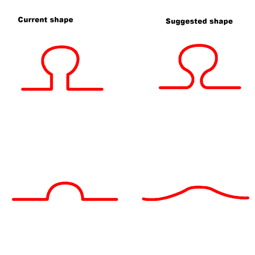

From: Jellby
Date: 22 Aug 2004 04:57:26
Message: <41285ff4@news.povray.org>
>> than the bare straight edge. ASCII picture:
>>                              ____
>>      ____                   \    /
I realized you've already posted the code. I've looked more closely at the
images and maybe you could find some time to "improve the shapes of the
pieces. It would take some time and effort, but I believe it may be worth
it. I include an attachment, because ASCII art is not good enough for this
Note: if/when you use differences and intersections in your code, I guess it
would be wise to add "manual" bounding boxes to improve the rendering
times...
Download 'shapes.png' (13 KB)
Preview of image 'shapes.png'

About the waving edges, it can be done but i need a special shape. I'm
thinking about making a deformed square using splines (one spline for each
edge), but i can't find a way to do this.

thanks for the comment. The shapes will be improved, but not today since i'm
suffering from a (huge) hangover :-P.
JWV
